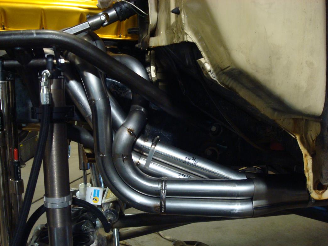

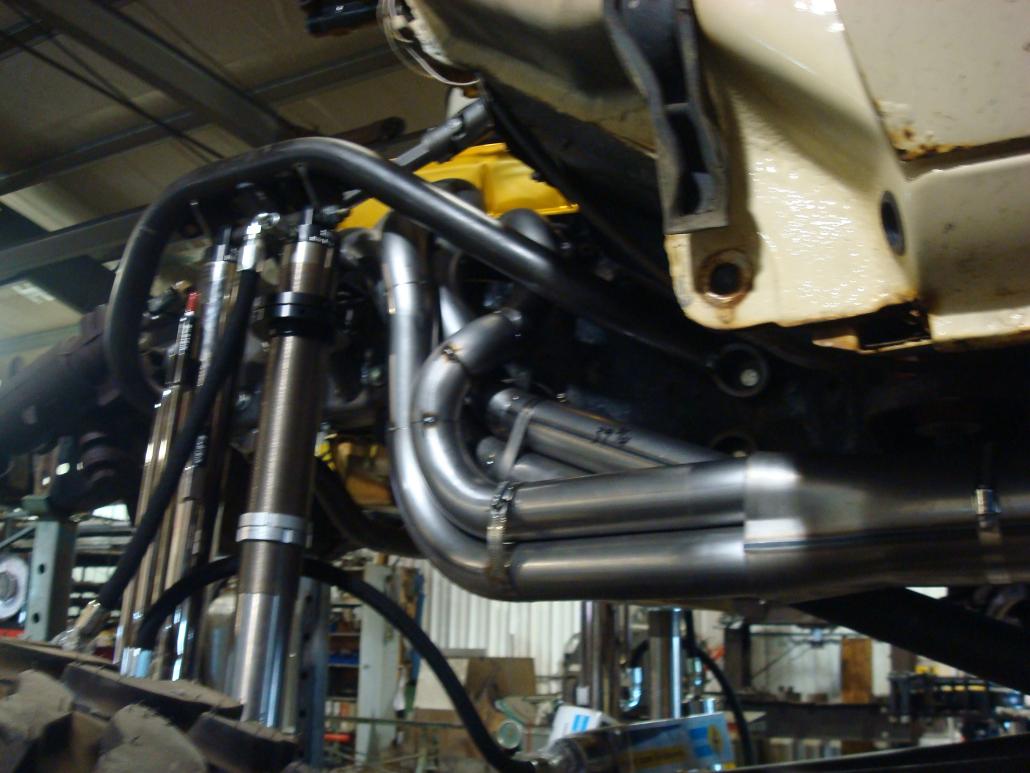

Custom built headers by Kat Kustoms. These are custom built with 3/8 flanges and 2.5 id primaries with a 4 inch collector.

Dang! Shouldn't have any problem getting the fumes out, that's for sure.

Headers in general are neat as hell if you think about it. If you go to Headers by Ed online you can enter all the info about your vehicle and its alot of info. They will send you a packet telling you everything you need to do to build a custom set to make your truck/car etc. run its best. These headers are loosely based off of that information.
