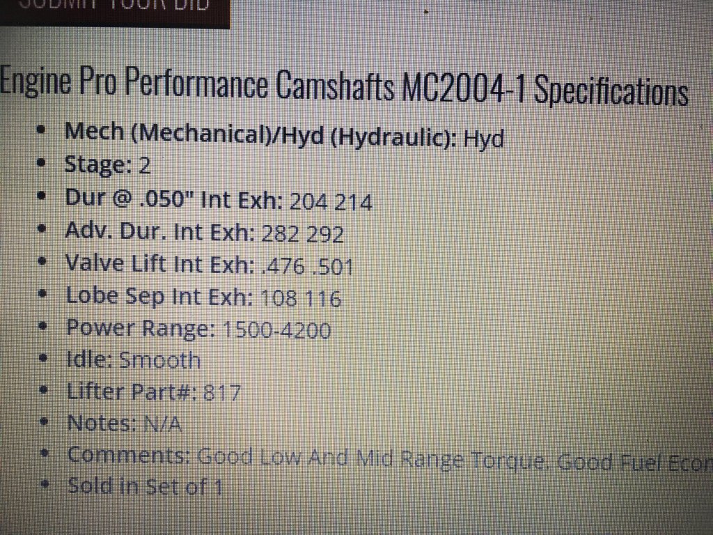

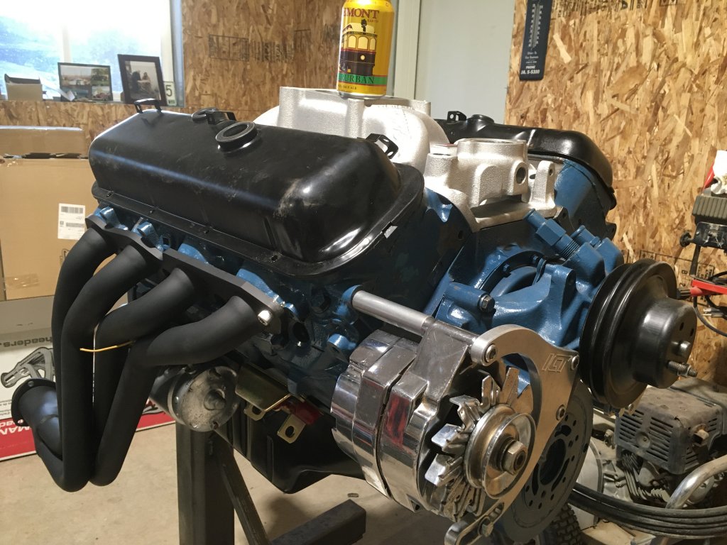

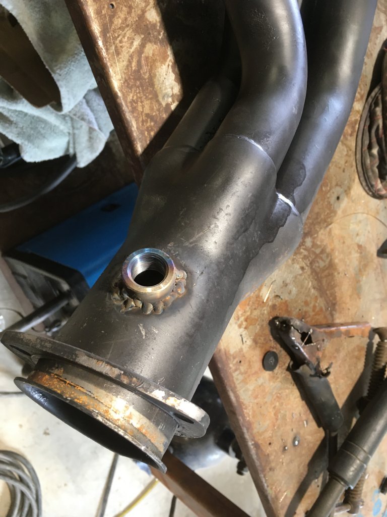

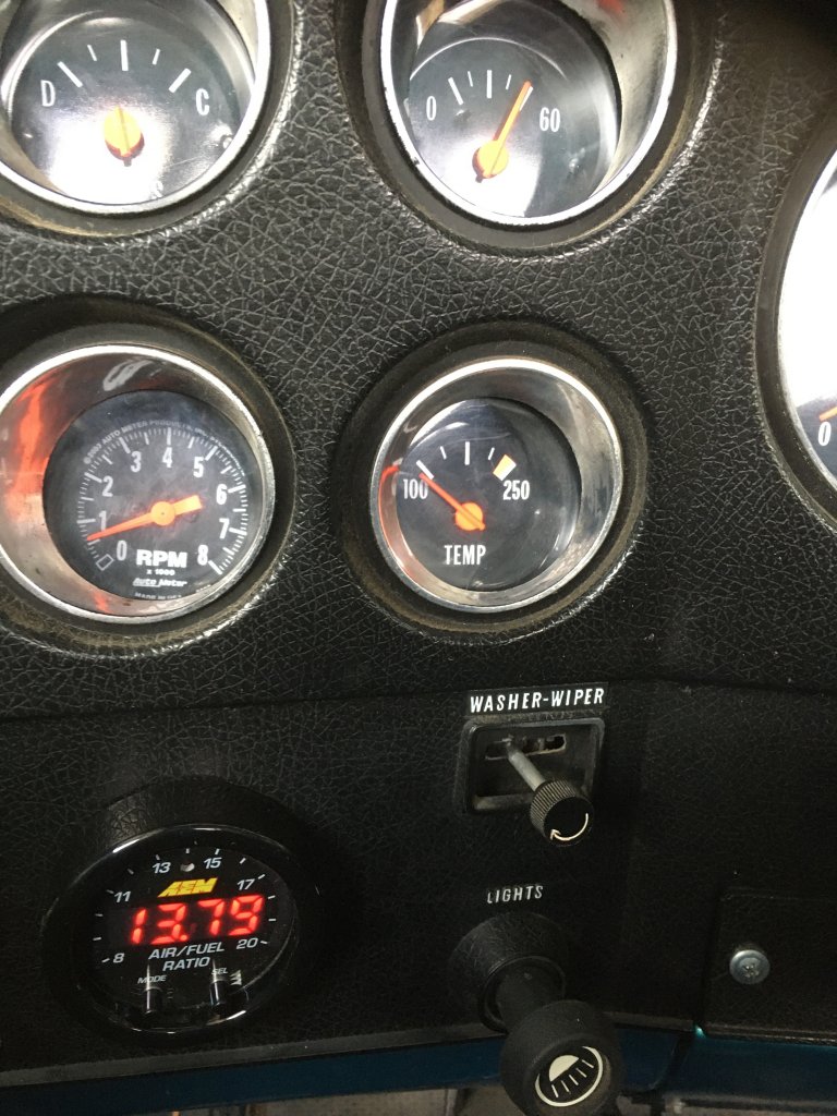

I do have a small cam, and an E-brock airgap/ 750 Holly 1450, but the 1 7/8 headers helped. I use a Bosch and AEM A/F meter to calibrate the carb. Installed the gage in the dash.
