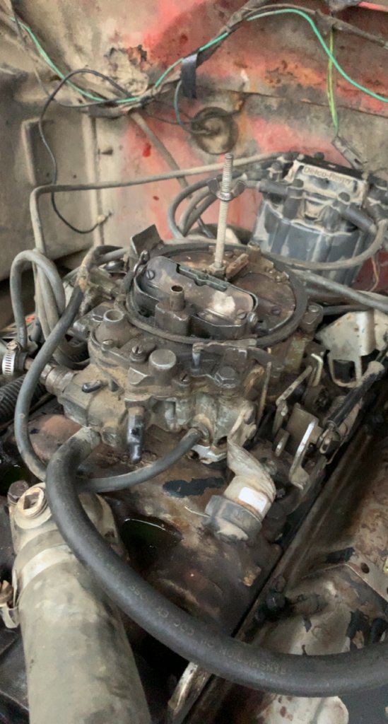

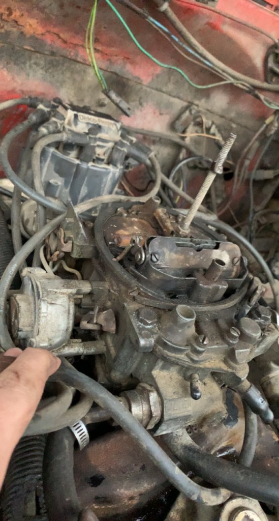

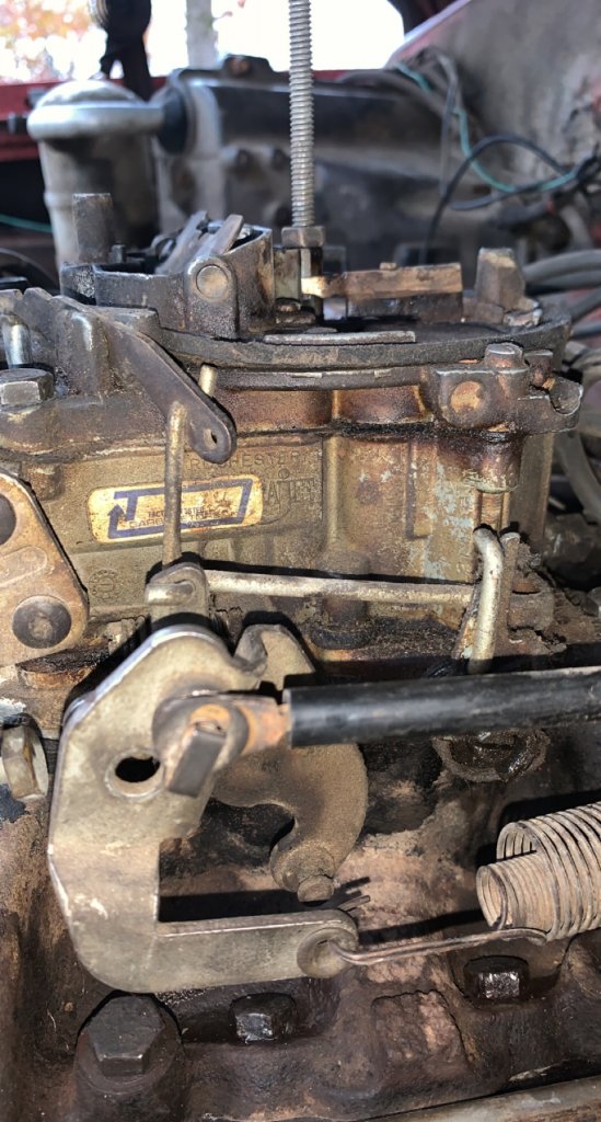

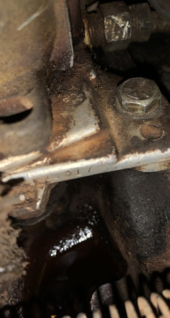

Also I have no idea how to identify quadrajet models. I know the one time I redid one oreillys gave me different gaskets from what the truck had. Here’s some photos of everything I thought might need to be shown. If I can figure out what I need I’ll rebuild it first.

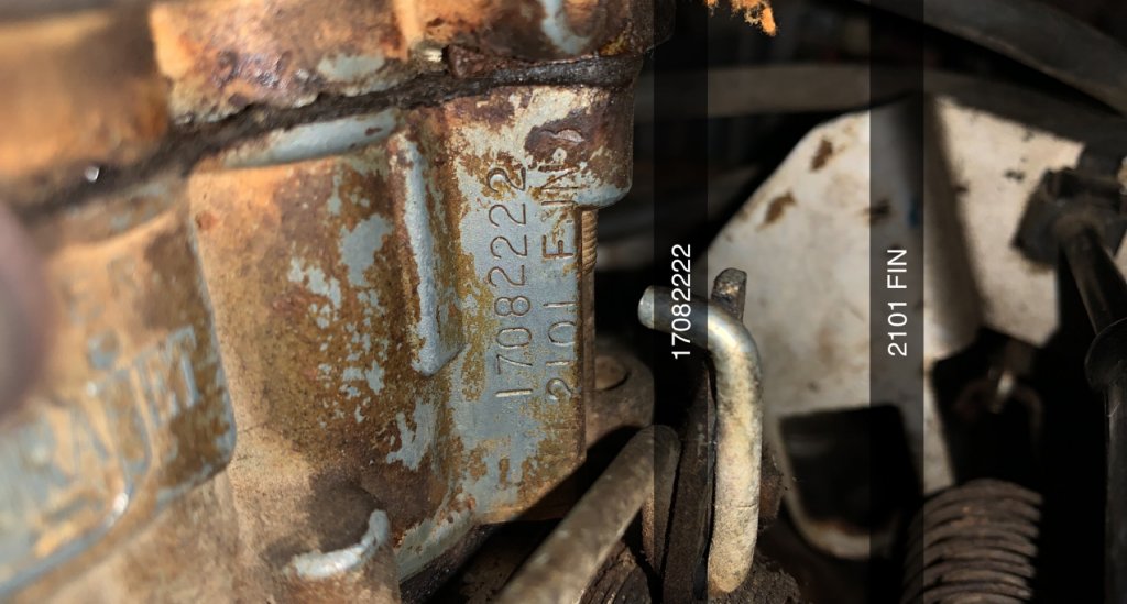

Oh and I’ve got 10 or twelve of those holleys all around 600cfm, but I’m trying to make this just a reliable engine for fuel mileage as I planned on throwing it in my work truck. I got some more info from the carb. 17082222 82’ Chevrolet 4 barrel automatic trans. But how do I find out what cfm this carb is or which gasket set I need

Q-Jet rebuilding...get Cliff Ruggles book on them. It's worth its weight in gold. Go to his website and shoot him an email. There is a form on his site that allows you to enter the number of the carb. He will give you the info on the carb and the RIGHT kit for it.

I came to the numbers R4-M4ME as a model number from the 17082222. I’m not super familiar with quadrajet I know the vent on top but what about the vent on the front? Can that being capped cause flooding?

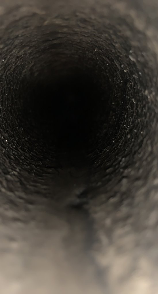

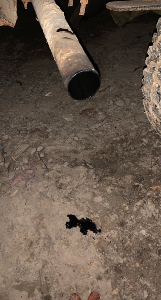

I’m thinking this engine needs more than a uh carb.. I rebuilt a qjet on the flatbed and noticed the passenger side exhaust had a puddle of oil under it and all inside of it. What could possibly cause that?
9,966
19,133
Lots of things,step 1 run a compression test wet and dry. Post your results.
MrHorsepowerLSx
Jun 25, 2021
282
610
New Jersey
Jeffrey
K35
It might not be oil, it could be mixture of rich gas/soot and condensation forming inside the pipe being carried to the tail pipe when you gave it the beans. Hook a vacuum gauge up to and see if you have a steady needle at idle. There is a sticky in this section about using a vacuum gauge. Also a compression and leak down test would be a great way to know for sure the health of the motor. Guy told you it had 30k miles, but for how many of those miles did he drive it with a kicked pushrod, who knows

I don’t have the resources to do a compression test, but I know someone who does. I’ll try to do that but I don’t know much about it. How do I go about it. I know you take the plug out and screw it in there that’s about it. I don’t know what wet dry means. How many times crank? I know you hold wot.
Edit: the reason I thought oil was the consistency of it it felt slimy sorta and slick so first thought was oil

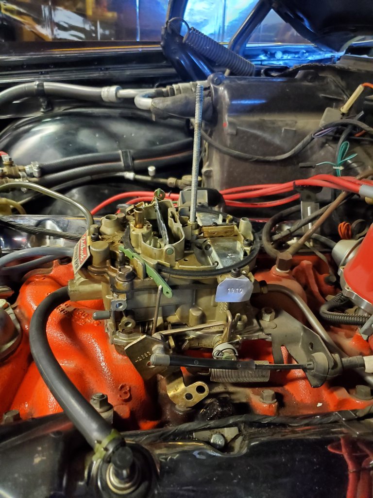

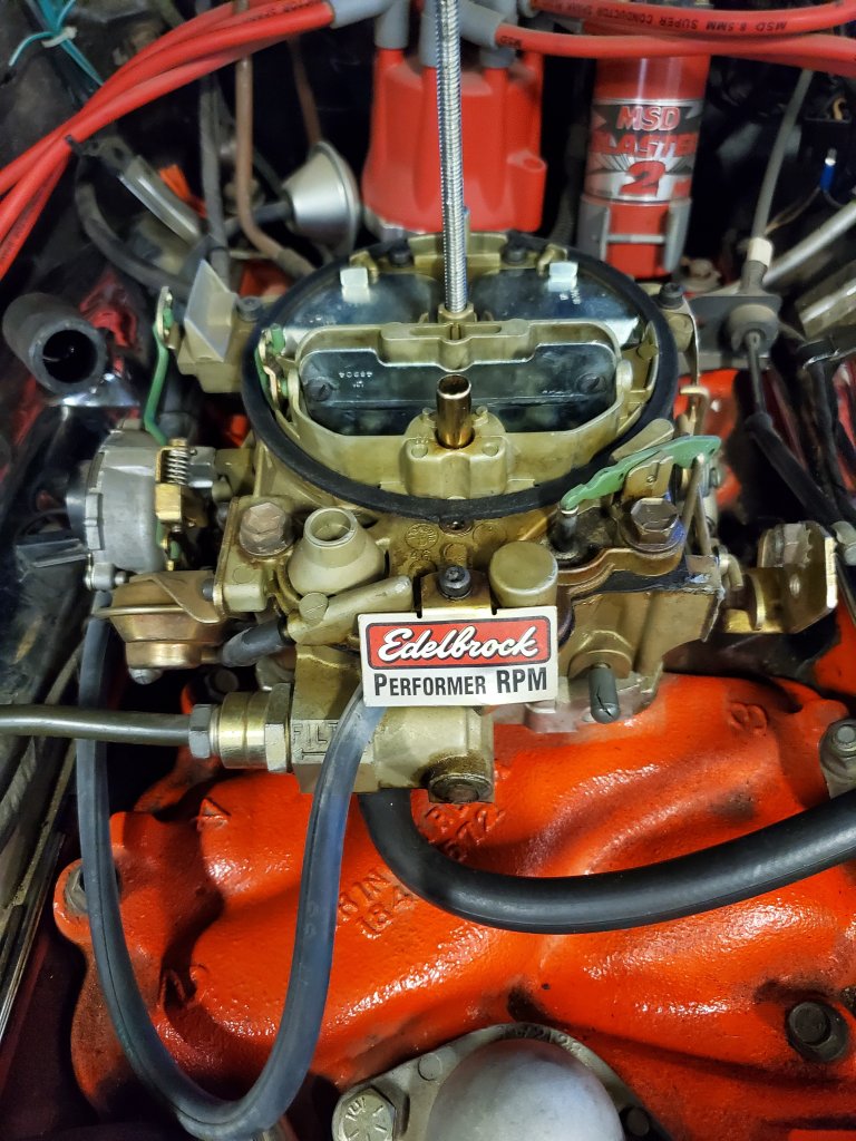

That carb looks like an Edelbrock replacement for the Q-jet. I have one on my '72 Chevelle, model 1910 if I recall. Nothing short of locating the tag and casting stamps will prove or disprove my theory. Pic of said Chevelle carb attached.
As to your smoke issues, I think you'll have to solve your carb issues with a known good carburetor before you'll be able to look further. That pushrod discovery is spooky!
Good luck!
