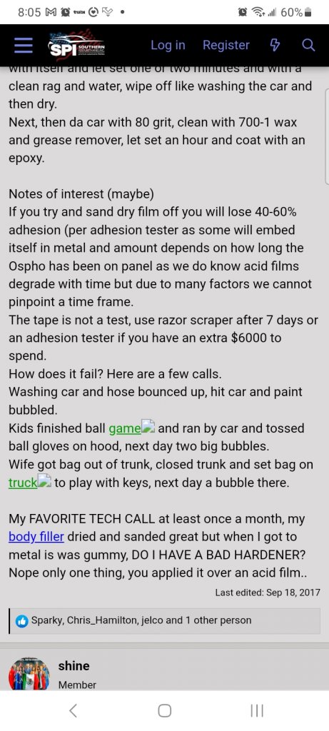

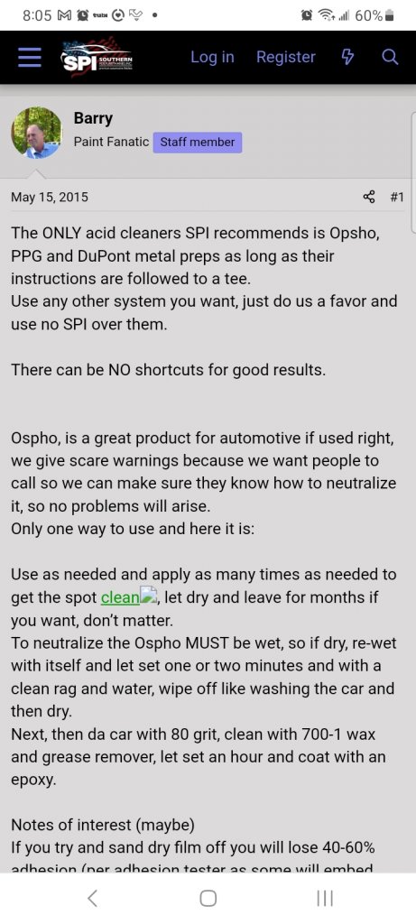

He said spi says not use acid under epoxy,I don't think that's right. I belive SPI only recommends ospho and only when directions for using it are followed completely,which is what I think that second test was. I'll look and see. Yep Ospho is the only phosphoric acid treatment,SPI recommends.

Read SPIs info on sanding phosphoric acid treated metal. As for the person asking about spraying phosphoric acid on clean metal. Yes you do spray phosphoric acid on clean metal. It stops rust from forming and neutralsizes any microscopic rust. You wet it with phosphoric acid again then washbit off while still wet to netralize it. If I had something blasted,I would immediately spray it with phosphoric acid from a garden sprayer,until I decided what to do or was ready to do whatever. And many paints can go directly on top of the phosphoric acid. I think it's how they used to do bridges.
