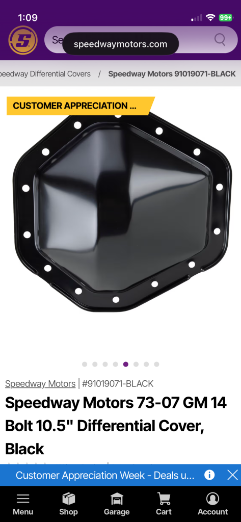

It won’t upload I’ll try in a bit. But on the 9.5 vs 10.5 debate we figured out that the 9.5 diff cover shape doesn’t match like at all. But the 10.5 does

Note the squared off sides and hard triangular shape to the top and bottom, the axle in your pic has a very round cover.
As stated here, you have a 9.5” semi floater 14 bolt not a 10.5” 14 bolt (full floater).
