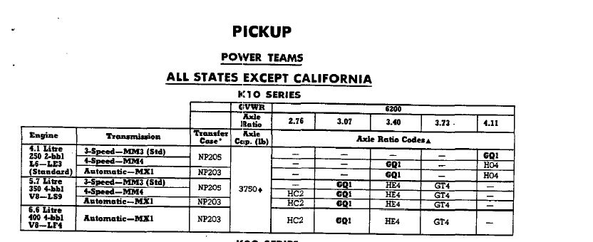

Check your SPID label.
If the truck was built with the base ratio there will either be no axle noted, or it will say "GQ1" - Standard axle.
If an optional axle was installed it will say the actual RPO and noun name (ie, "GU6" - 3.42, or GT4 = 3.73).
Base ratio for your truck from the factory would be 3.07:1, although it looks like a 2.76 was available optionally.
https://www.gmheritagecenter.com/do...its/Chevrolet-Trucks/1979-Chevrolet-Truck.pdf
All this assumes it hasn't been changed in the last 40 years.
