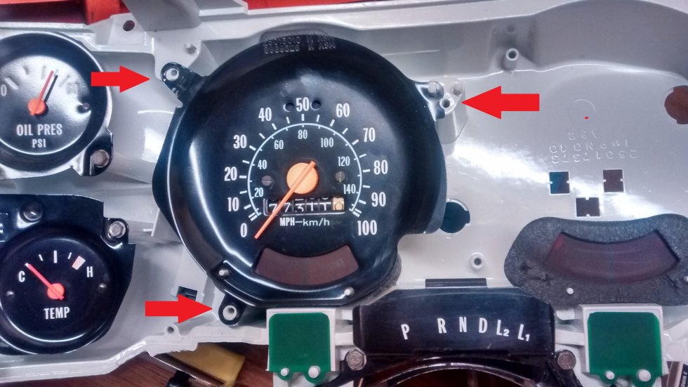

Your high beam indicator bulb is tied into the printed circuit on the back of the cluster. You probably just have a burned out bulb.
When you have your cluster opened up, remove three screws that hold your speedo. (Red arrows in pic #1) The bulb is behind the top of it.

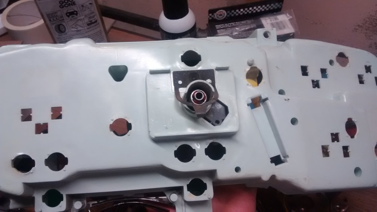

You will also need to release the cable from the back of the speedo. There is a little clip on the back that holds it together. (Pic #2) Reach behind your dash with one hand and push the little clip with a finger or two and pull the cable out with the rest of your fingers. If you can remove your girls bra with one hand, you can do this.

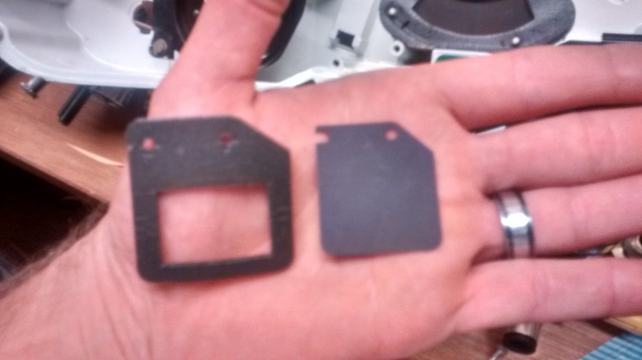

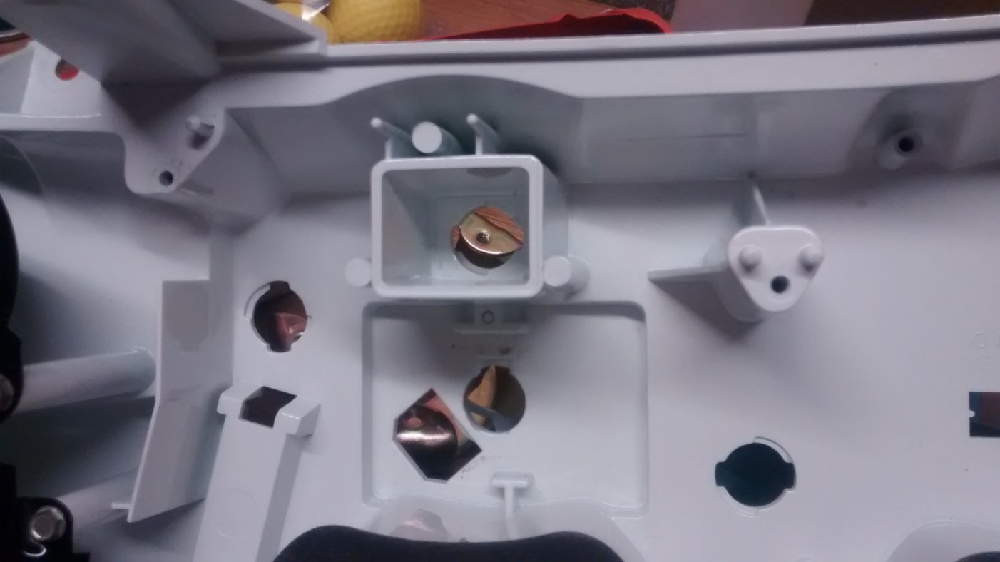

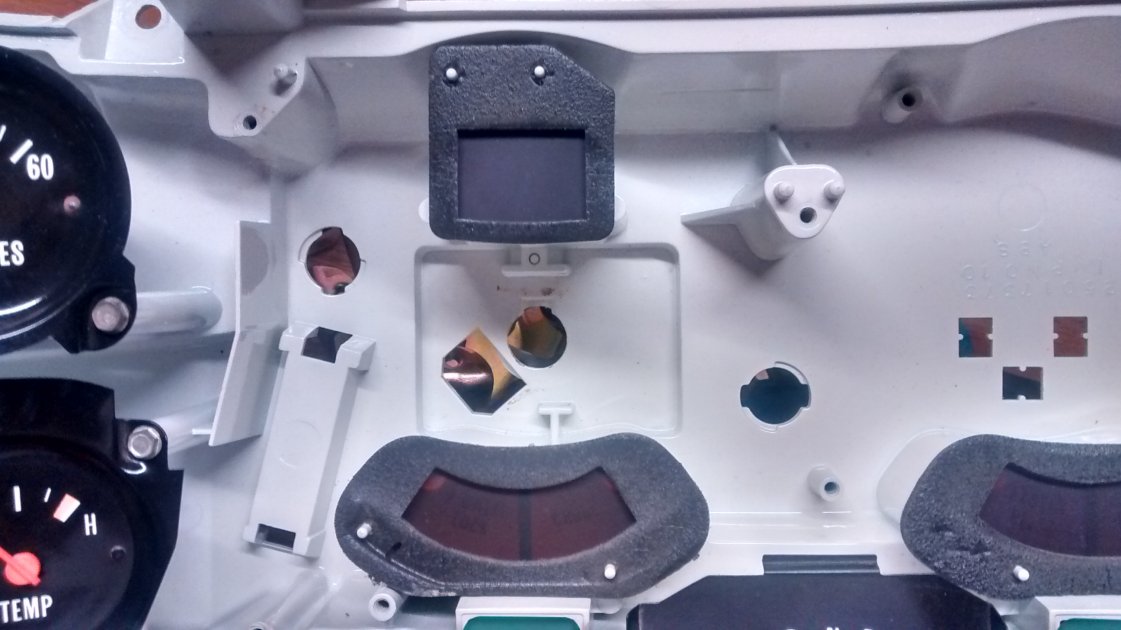

Once your speedo is out of the way, the bulb is behind a blue plastic piece that is held on with a piece of foam. (Pics 3-5)
Again, assembly is the reverse. Your speedo cable just pushes back on.
