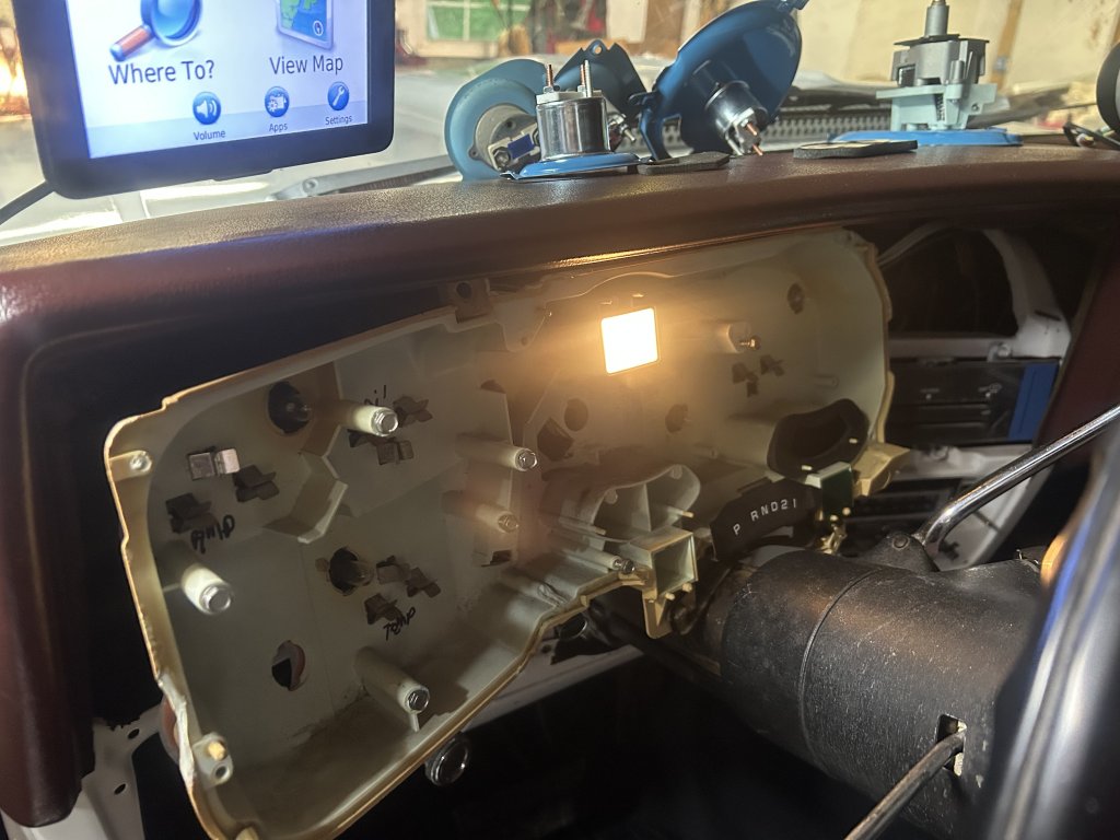

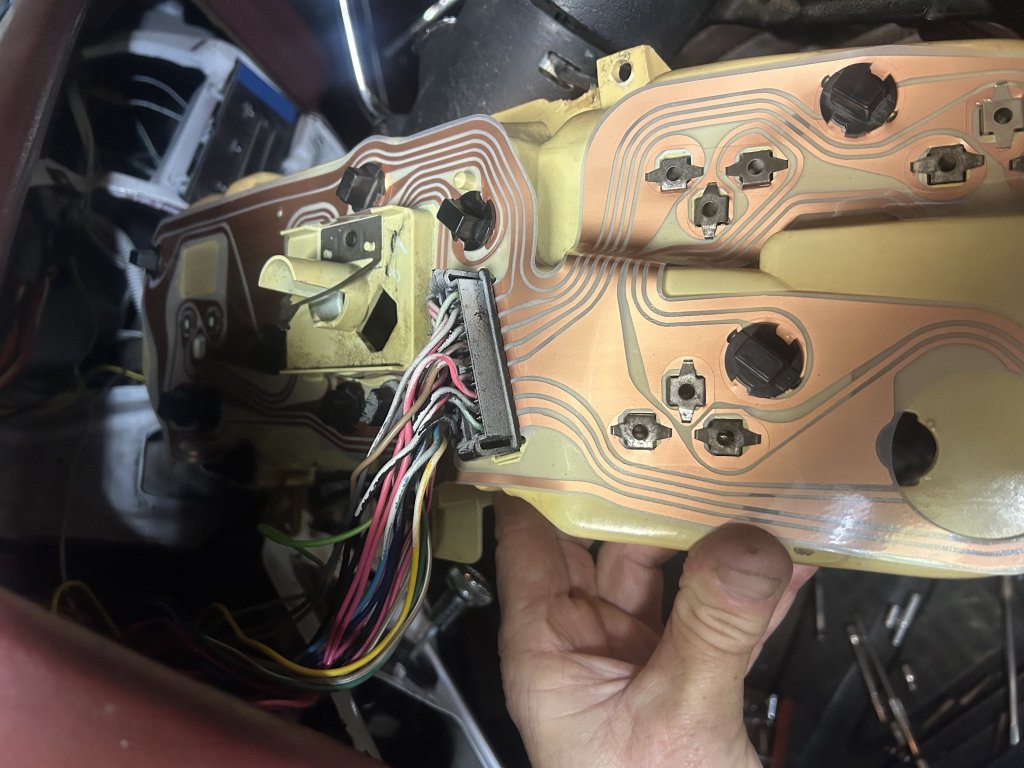

1982 Long Bed K10 4x4. I've installed TWO new printed circuit boards from LMC. (I assumed one board was bad)
All twist in sockets/lamps work alone (out of the dash cluster) they check good and will light with direct 12 volts from a battery.
Only the bright/dim lamp will work on the dash cluster (see pic). No other lights work, but all have working bulbs and strong ears to make contact with the P/C board.
The old, ratty printed circuit board worked fine before !
