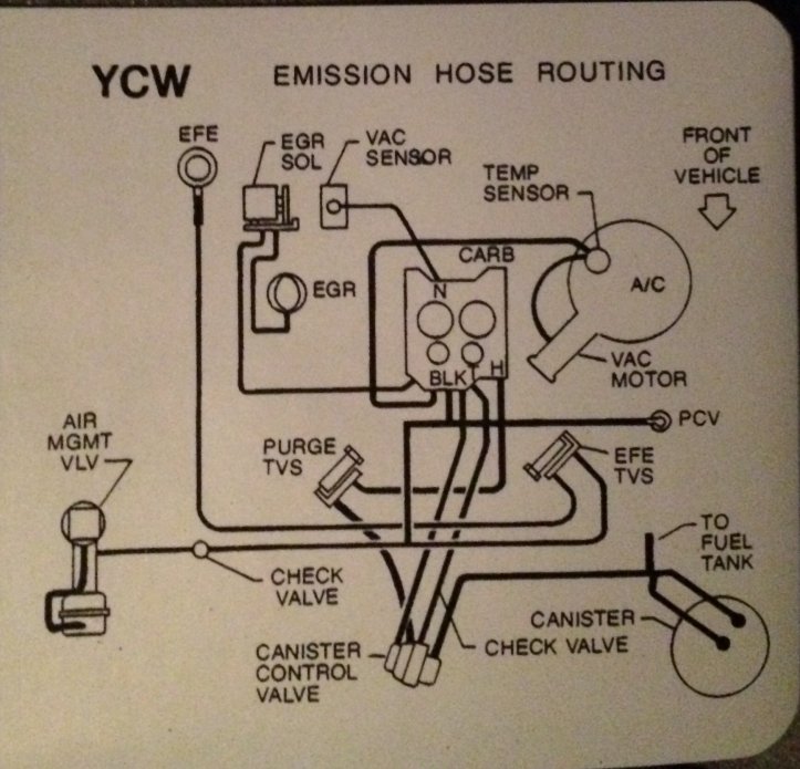

Thanks. I saved it because it's a good picture. Mine doesn't read in those low numbers that I know of. It'll do alright and just die all of a sudden or start missing worse and worse until the idle is comparable to a series of coughs. Here's the emissions routing, too, by the way.

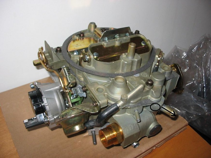

I was pulling vacuum lines off my carburetor, and the fattest one that goes to the purge valve for the charcoal canister leaked gasoline out.
It isn't mentioned what carburetor you have installed, let's work on the assumption that it's a stock Rochester Q-jet.
If the line you refer to above is connected to the "T" port on the carburetor, that is the bowl vent to the canister. The evaporative emissions system collects vapors from two sources when the engine is off or cold - the gas tank(s) and the carburetor bowl. If you find raw fuel in the bowl vent hose, you might want to check that your bowl level is normal.

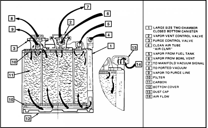

1984-87 Engines
This system Fig. 63, absorbs and stores fuel vapor in a carbon element until it can be removed and burned during normal combustion process. The canister is equipped with a vapor bowl vent control valve and a canister purge control valve which are both mounted on the canister.
The bowl vent control valve operates as follows:
When the engine is off, there is no vacuum through the vacuum signal tube to the valve diaphragm, spring tension opens the valve. Fuel vapors formed in the carburetor float bowl are pressurized to the point where they flow from a tube in the carburetor float bowl through a connecting hose marked ``Carb Bowl'' in the canister cover. Vapors travel past the open vent valve through the filter in the canister onto the activated charcoal, where they are stored until purging of the canister occurs. When the engine is running, vacuum is supplied through a tube marked ``Man Vac'' to the vent valve diaphragm. The diaphragm moves upward, raising the vent valve upward, against spring tension, allowing the valve to seal the passage venting fuel vapors from carburetor float bowl to canister. When engine is stopped, spring tension opens the valve to allow venting of the carburetor float bowl.
The canister purge control valve operates as follows:
Fuel vapor is inducted into the engine and is controlled by an orifice in the purge control valve. Ported vacuum signals to the purge control valve is controlled by a thermal vacuum switch (TVS) which delays purging until a specified engine temperature is reached. With throttle closed, the purge control valve diaphragm is seated by spring tension and no purging occurs. With throttle opened, ported vacuum is applied to the purge control valve. With vacuum applied to the diaphragm, the valve is opened when ported vacuum develops sufficient force to overcome preload of the diaphragm closing spring and purging takes place until the throttle is closed to a position which reduces ported vacuum to a level at which it can no longer overcome diaphragm spring tension.
Fig. 63 Purge valve type canister. 1984-87 carbureted models:

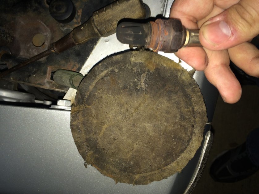

Okay, so I replaced the charcoal canister filter and the oxygen sensor. It seems that I've gotten rid of the codes, as well. Fuel cap's good and no vacuum leaks. I even did preventative maintenance on the some of the vacuum system. Here's the big overarching issue, though. I hooked the vacuum gauge up to it, and it read fifteen inches of Hg when the motor was ice cold and had just started. The idle was rough, crappy, and missy. There was also a very loud tick on the passenger side bank. After about a minute of running, the motor idled up, smoothed out, the tick went away, the miss went away, and the vacuum gauge instantly went up to 18 inches of Hg. It usually runs at about 19, almost 20, inches of Hg when fully warmed up. I checked the valvetrain on that side very closely. The adjustment is good and everything is moving as intended because I was trying to see if something was stuck. I was wondering if I have a lifter issue or something of the like. Besides a muffler that's degrading from the inside out, which I have a replacement for, my exhaust system is tip top. Oh, and here are pictures of my old canister filter and O2 sensor.
