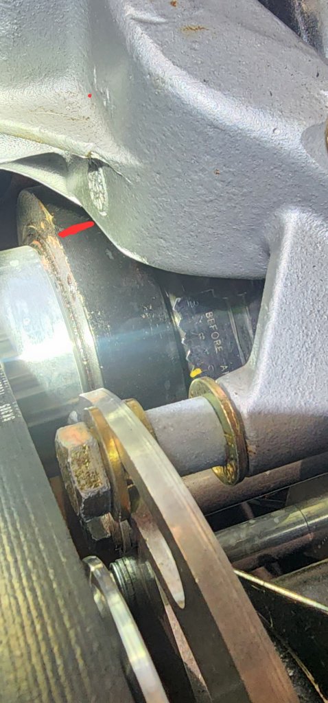

So update on the motor. Found intake gaskets were leaking. Replaced the gasket and engine runs now. But having timing issues now. Not sure how its happened but mark on harmonic balancer is wayyyy off. Engine and starts but dont run the greatest. Moved wires one position over to adjust for the retard of timing and will not run at all. Picture here of it not running but where the timing mark is on #1 with timing light. Thats where it seems to run the best. Would this be wrong balancer? Ive placed it back on top dead center on it sits on the 1 plug of the distributor.

You were checking timing with the vacuum advance disconnected and plugged correct?
What type of timing light? Dial back?
Use a piston stop to re qualify the balancer and remark TDC.
I'm not sure on big blocks, but small blocks have two or three locations for timing pointer. For example my 79 is at 12:00, behind the water pump and my 76 is about 2:00 position. Technically you can mix and match, just the marks will be way off. If you qualify it and remark then it's not an issue.

It's very possible,and common that the outer ring on the balancer has slipped or the wrong balancer was installed. Buy a piston stop,and follow the directions to verify the TDC mark on the balancer to the timing tab. As for the person running a disconnected vacuum advance.If connected on a ported vacuum port at the carbureator,there would be no vacuum advance at idle or WOT,if the carbureator is adjusted correctly. That is the whole purpose of ported vacuum,no vacuum at idle,no vacuum advance at WOT the vacuum advance woukd primarily be at low throttle cruising speeds, His setup still needs some investigation. And if everything else is correct it should idle whether you are on ported or manifold vacuum,there is one consideration to be made on manifold vacuum though, and that woukd be having the correct vacuum advance cannister to stay fully pulled at idle, advance cans come with different vacuum ratings.

I had the vaccum advance disconnected. Port plugged off. Ive got 2 old school timing lights. Old penski and a snap on. Tried them both to see if there was an issue on my first one but they both read the same. They arent dial backs. I set the piston on tdc and was showing on my original marking of the harmonic balancer correct. But while running it is was off.

If you look at that pick TDC (the yellow mark) the line on the balancer should be on the opposite side of the yellow (around 2-3oclock) siting in the 28-36 degree range for a big cam. either a tab/balancer mismatch or the outer ring of the balancer slipped which is most likely and means a new balancer is in your future. I myself would wait and get a new balancer because if the elastomer has let go and let it rotate that means it can also fly off causing serious damage.
