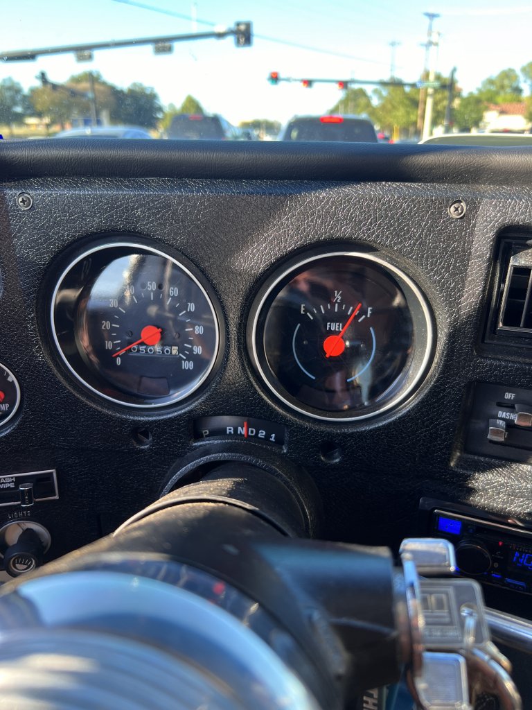

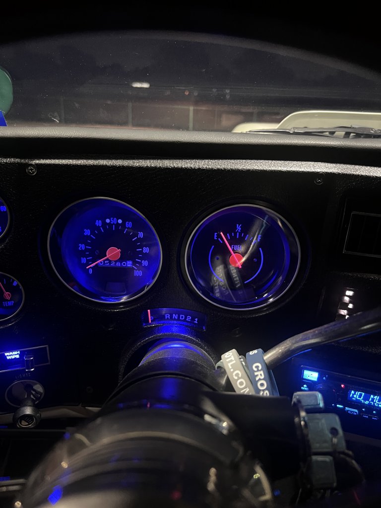

Well, now Easton says the sending unit is not accurate. Gauge almost empty and he put 14 gallons in last night so still have 6 and the gauge is almost empty. He says after he fills it up stays above full for awhile before falling…..
sender (LMC) was done a few years ago when he had truck apart. Guess we will pull the bed this weekend and drop a new sender in…
The gift that just keeps on giving
Randy and E
