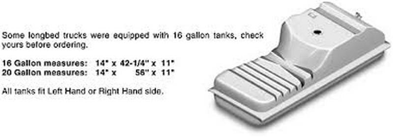

Is it possible to have a single 20 gallon fuel tank on a 1978 stepside. Everything I have read states stepsides should have a 16 gallon tank.
I ask because my fuel gauge read 1/4 tank when I filled it, it took 16.1 gallons. Are there any numbers on the tank that tell it size. Does anyone know dimensions of a 16 vs a 20 gallon tank?
