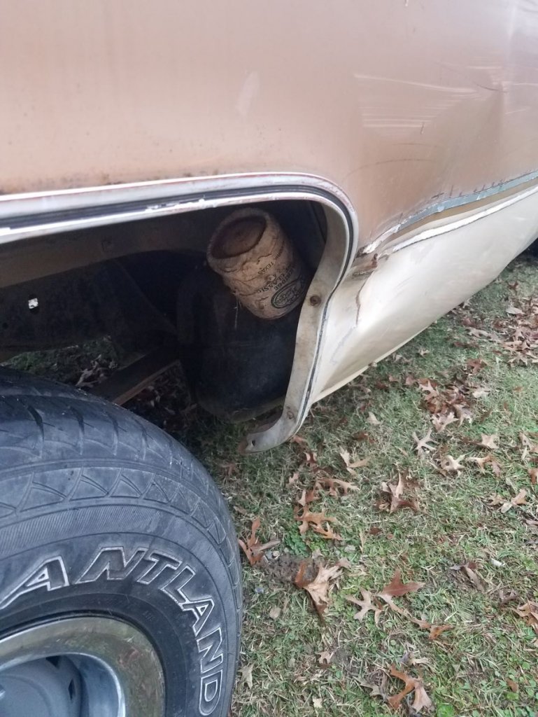

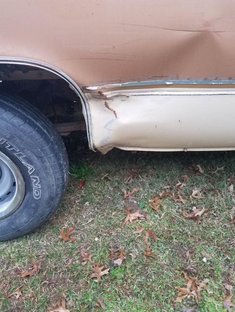

OP, is your bed side still smushed in? Can you send us a picture of it?

yup its still there ive pulled a bit of it out, but it got cold out side so i have not been back to try anything..
i need to get that plastic tank out so i can beat that dent out some an figger out my next step...

If you’re fixing the bed or replacing the bed side, either way. And also removing/re-doing fuel tank, you’re going about it backwards.
Remove the bed first. Build a little stand for it and then the bed will be much easier to work on and so will the fuel tank(s).

cant do that i need the truck whole at the moment. remolding the house i need that bed. fuel tank mounts i can use the 77 mounts filler hole is same size but there is no filler door. i figger ill find anuter truck for around 4300 or so and go from there. these trucks are a dime a dozen here just got to wait till somebody's grandpa dies off then the kids will sell off everything cheap...found a 4x4 $900 bucks running it went quick 80's model chevy.......theres a step side 4x4 down in the tow yard $600 bucks guy said it ran thats been couple years ago truck is still there....
