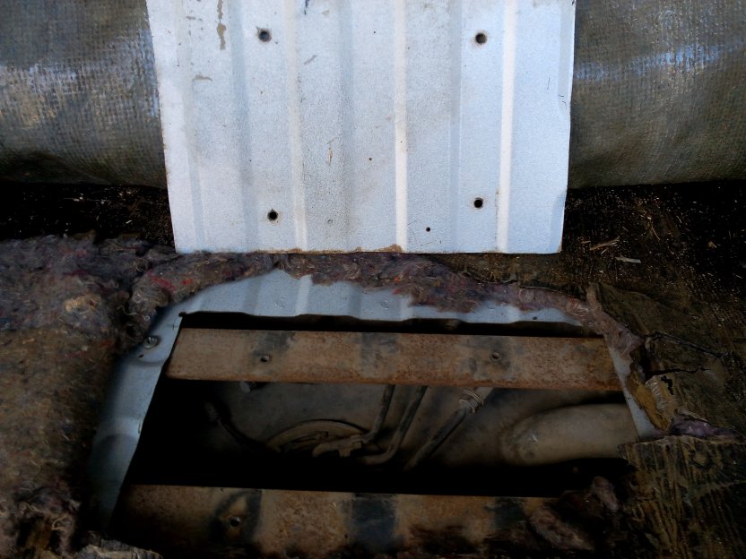

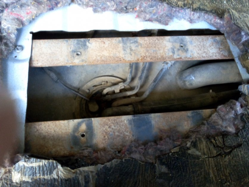

Hey can I see a pic of the floor hatch please?

Here a two pictures of the cutout. It was kind of tough to get a good shot because the under carpet material is all over the place and it's dark. There are basically two support pieces of steel that are bolted to the floorboard and the cutout then bolts to those pieces. I'm going to silicone around it when I get it back together because I don't want any fumes coming in the truck.
Today I replaced the sending unit and fuel pump. I couldn't find fuel hose for the filler neck and breather so when I find those I'll be able to finish this part up and cross it off the list.

That's an interesting idea on the hatch. I've usually just added some flanges to what I cut out, then screwed it down. One time I used some hinges too, lol. I like the idea of some angle iron in there too.
