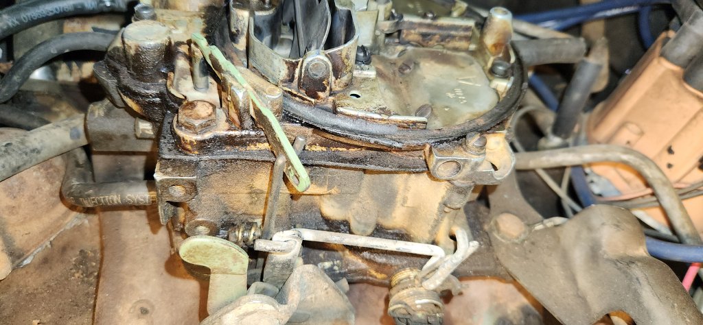

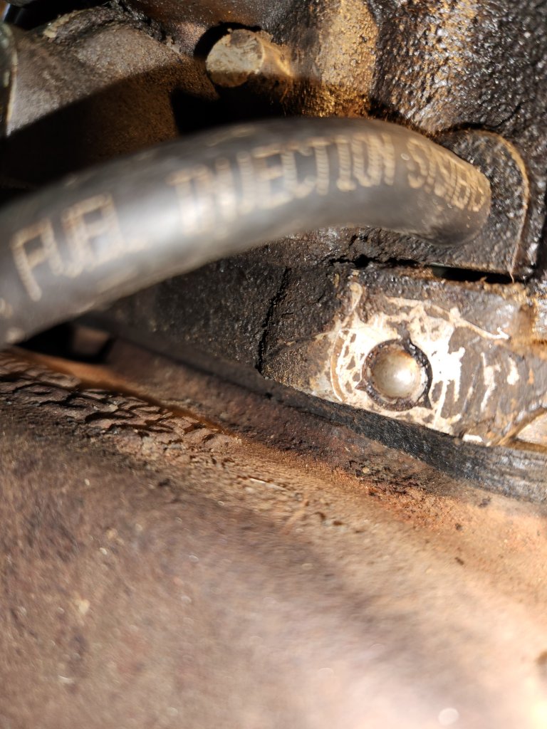

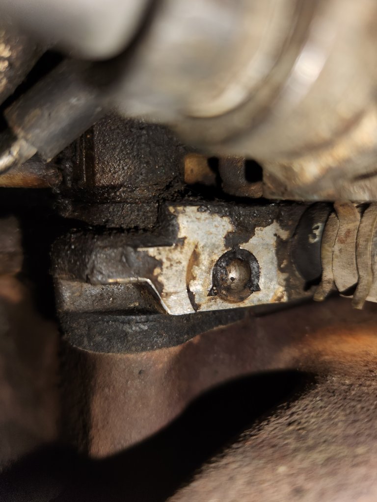

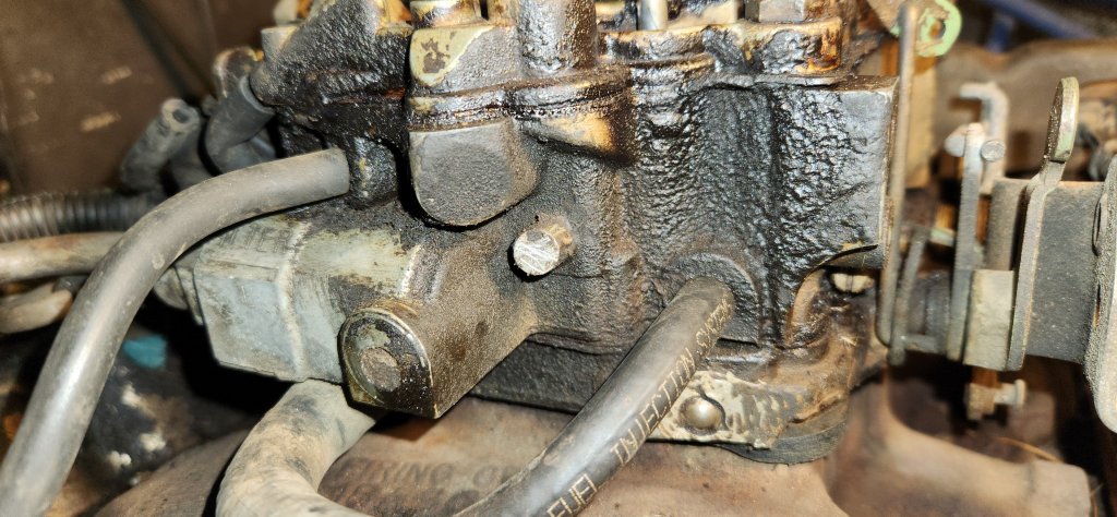

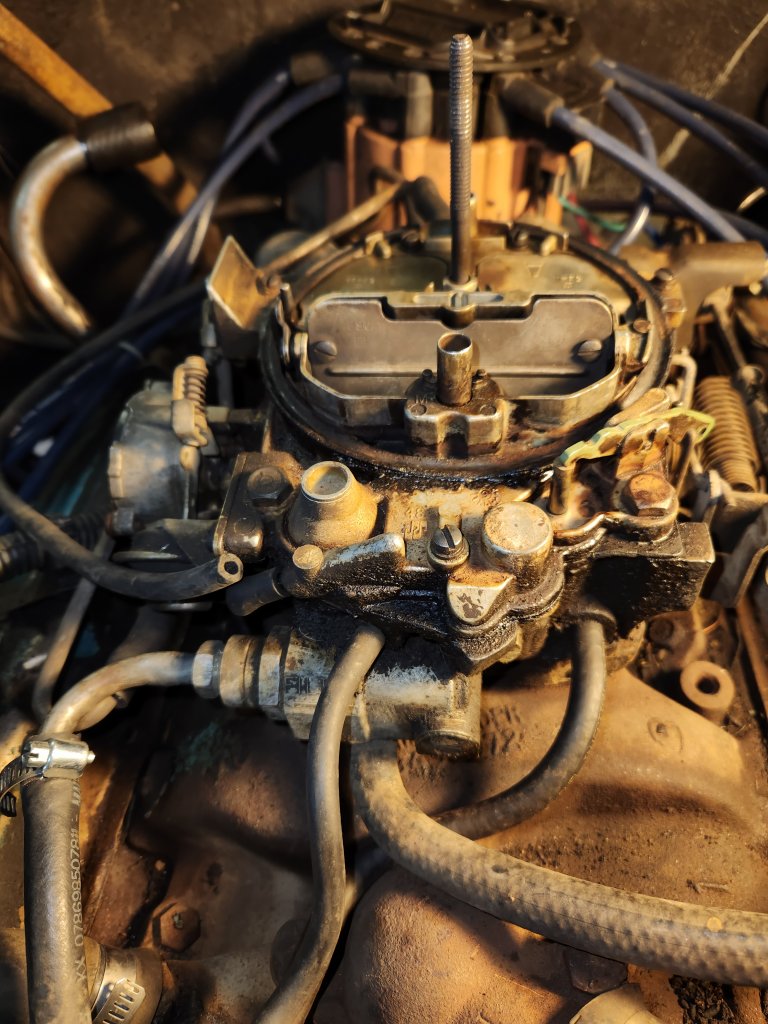

I have a 1980 GMC Sierra classic with a 350 cid motor. It has a Rochester four barrel carb, number 17063425. There are silver buttons where the idle mixture screws are supposed to be. Does anyone know what the deal is and how I access the mixture screws? Motor runs rough at low idle and backfires bad at full throttle, otherwise it runs pretty smooth in between until its under load above fifty mph. Then occasional backfire. Choke seems to work right, secondary plates are opening at full throttle. It gets bad gas mileage, less than ten mpg. I hope someone can help.

Those are plugs that were installed when manufactured to keep from tampering with Idle mixture screws, there are various methods out there to remove the plugs to access the screws behind. Most are best done with carb off engine.
With your running issues, what is the ignition timing like? Retarded timing can cause symptoms similar to what you describe. As the timing set wears, it retards cam timing, since the distributor is cam driven, it retards ignition timing as well.
1,629
2,207
Those plugs are hardened. Carb will need to be removed and turned over. Using a small wheel make slots on both sides of the plugs. Only about 1/4" long, 1/8"th deep. Then with a small pin punch break out that piece. Should be able to get behind the plugs and tap them out.
One problem doing this is any dirt inside will be dislodged from being inverted. If the plugs are still in there it likely has never been rebuilt. Doing it now would be recommended.

There used to be a special tool that was used to remove the tamperproof mixture screws. Kind of like a hollow drill bit that cut the casting out around the plug. Once you get the plug off you will probably find that the screws have a weird double D head shape. You can buy the mixture tool with the right socket to fit, or just replace the mixture screws with aftermarket. You can also try crimping down some small metal tubing (1/4”?) to get the right shape, and try using it to turn the screws.

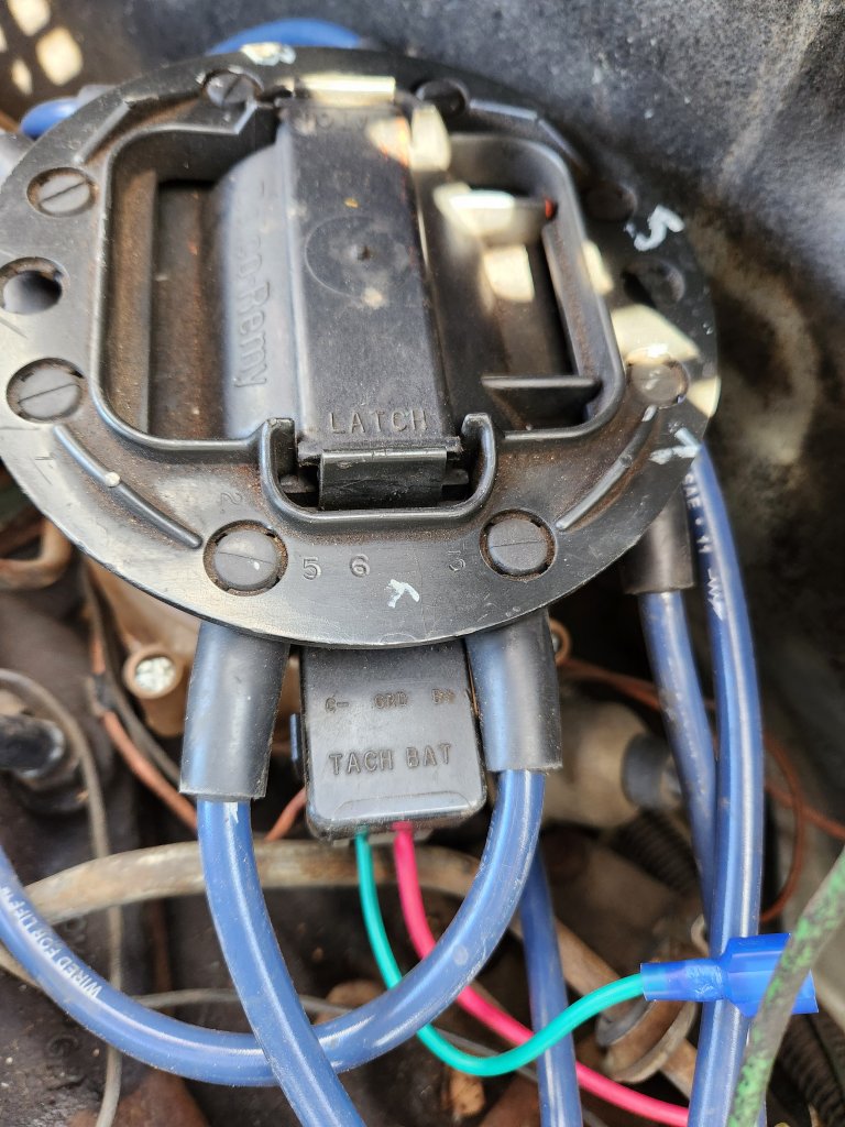

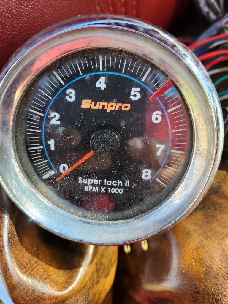

I would like to ask a question. Can connecting the wrong tachometer to the tach connection on an electronic ignition distributor damage the ignition or the voltage regulator in the alternator. I connected an old SunPro Super tach II and it didn't work. I found out that you need an adapter for that hook up. After that, the voltage regulator in a four month old alternator went bad as well as it's replacement as soon I turned on the ignition. I also read that a bad battery can do that. Does anyone have any experience with this?

Run a wet compression test as already mentioned. If the compression comes up on a wet compression test,NOTHING!!! is going to make this engine run right, or get decent gas milage. The numbers you have are all engine mechanical, not carbureation,ignition,vacuum leaks etc. The engine doesn't have acceptable compression. If it comes up wet,it needs rings and rod bearings bare minimum.
