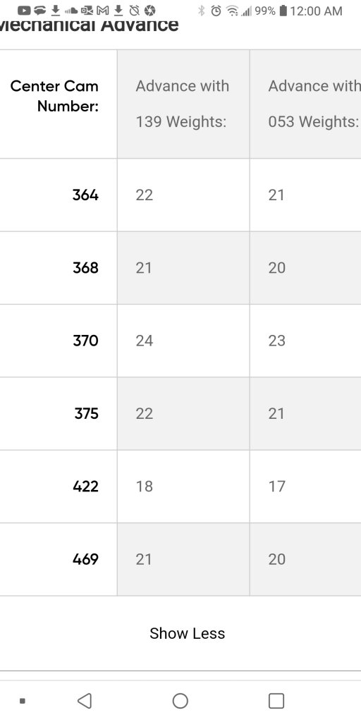

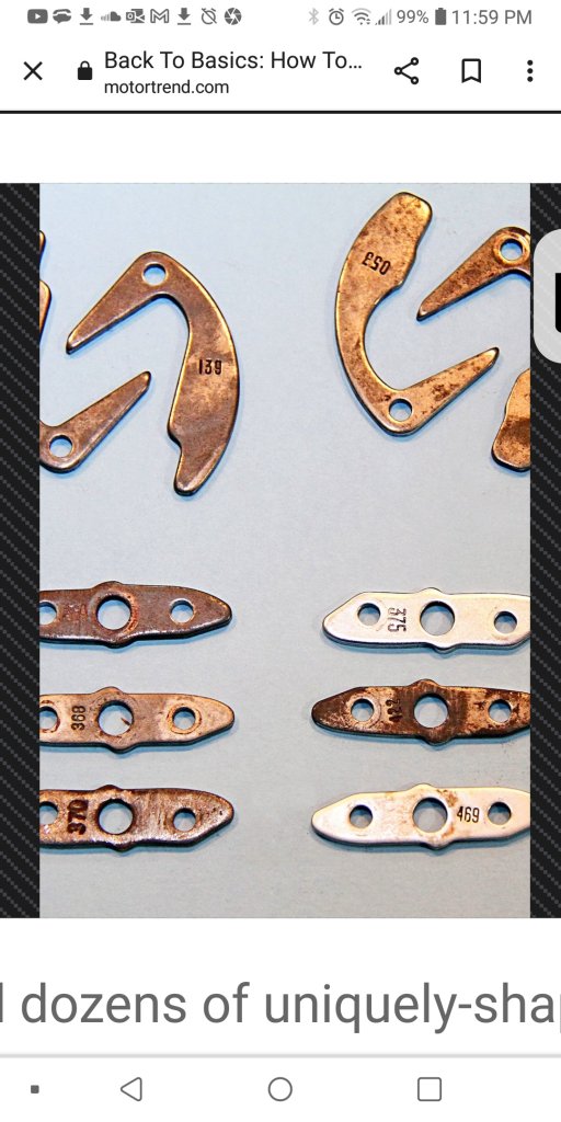

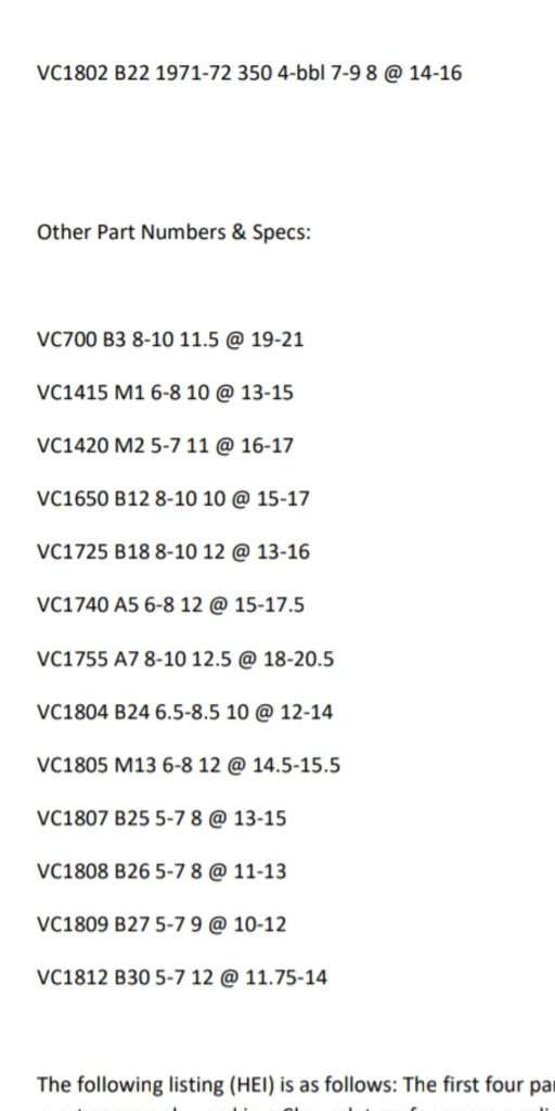

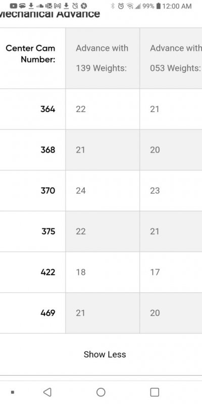

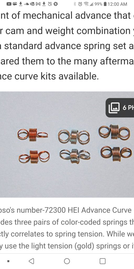

Okay got a few pics for you and some explanation. Pic 1 is a just few different vacuum cans, there are dozens. First 2 numbers are what vacuum starts vacuum advance moving. Second number how much vac adv. the can adds 3rd number when the advance is all in. 2nd pic is a FEW of the different factory centrifical weights and eccentrics specs. 3rd pic is a few after market centrifical springs. 4th a pic of a few Original eccentrics and weights. Look at the difference in variance of how many degrees of vacuum advance and when it starts and when it is all in, and that is a very small sample Look at difference on weights and eccentrics, just on that chart we have a possibility of 7 degrees difference and it can be more than that. On those few vac. cans there is a 4 degree spread. So just with 2 variables there is as much as 11 degrees difference, lets throw in another variable.Lets say you use that top vacuum advance but your engine only pulls 17 inches of vacuum, that top advance can isn't going to give you that 11.5 degrees Look at the springs, thats just 6 of them but many combinations there, 1 light spring 1 heavy, just 1 med spring etc.There is no one size fits all application. All engine combinations don't even need the same amount of total advance some need 38 some like 32 There are the this is as generic as we can make it distributors. That will work meh, in some,good on others, and terrible in others. The best thing in your, I bought it this way, have no idea what parts came from where,and what's been done to anything. Is learn how to tailor your distributor to what your engine needs.

Make sure you are reading the vacuum advance specs correctly.
Example - VC700 83 8-10 11.5@19-21
This means it
- starts to advance at 8-10 inches of vacuum, and
- maxes out at 11.5 degrees of distributor advance when it reaches 19-21 inches of vacuum
Crankshaft timing is double the distributor advance, so this advance adds up to 23 degrees at the crank
This is probably for a mild economy car tune, since most performance engines never get to 19-21 inches of vacuum at cruise.
Most off the shelf replacement distributors I’ve seen seem to have a 9-10 degree advance, so they add 18-20 degrees at the crank.
