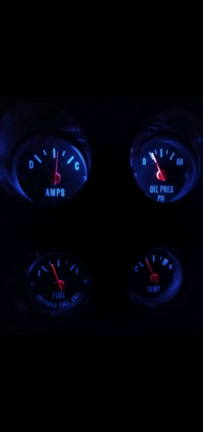

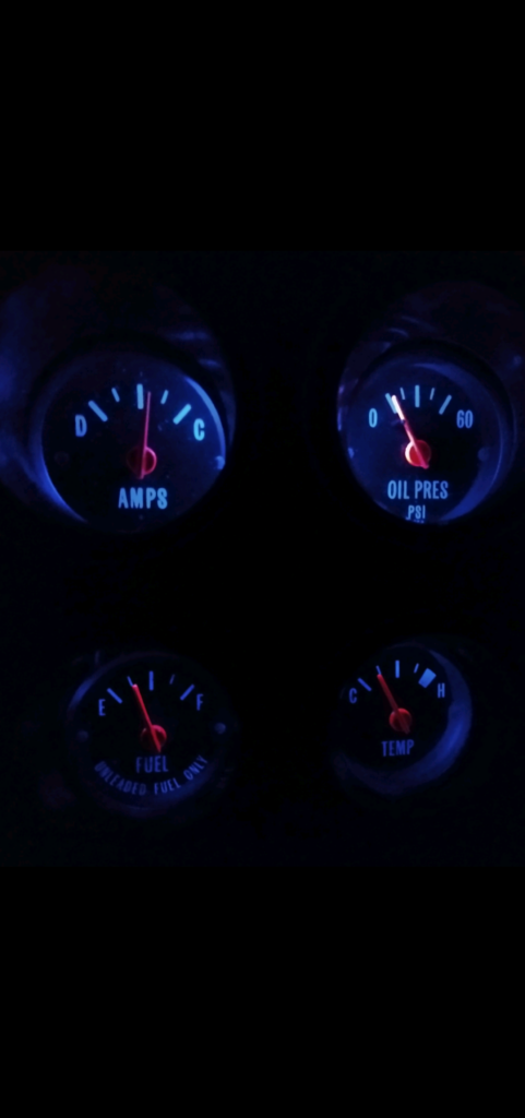

On a 74/75 cluster.. My gauge reads past FULL. I watched a video kinda confirming that if it moves it's getting power at the gauge but reads over because it's missing power/the signal from the sending unit. So... Does my org wire have a crusty contact, loose or broken? My ground at the rail was removed and cleaned at the ground contact and frame scratched clean where it meets. I've been dreading the idea of dropping the tank but don't see my fingers getting in there from below. Wiring issues aside, how many have had it be the sending unit VS missing or dirty wire in this situation of overfull reading?
It would be nice to be able to reach it and maybe pinch the thing so it's tighter clean up the inside of the contact point and the stud. The other day I have the cover off so with my finger I moved the needle to the E side and landed around qtr tank, turn the key on and instantly goes over Full. Was the quarter tank a false reading or does that mean it'll probably work once I get power on the other end of the things? Probing for power at the sender is probably my first move if I can reach it otherwise I gotta drop the tank. Think I remember others touching ground to the power wire or vice versa making the gauge do the opposite direction.
