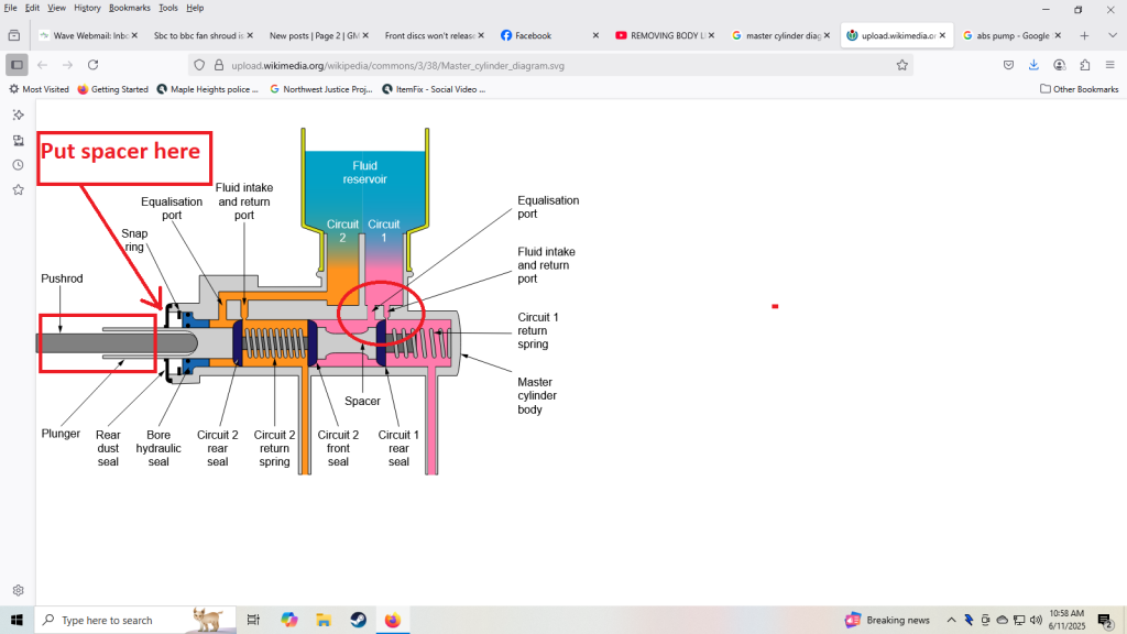

So when they brought it to me, I tracked the problem down to this:
The master cylinder was too close to the brake peddle. Even with the push rod fully adjusted, that was still not enough. The master cylinder push rod was just on the verge of completely closing off the front brake system. So if it sat, the pressure would slowly bleed back into the master cylinder and release the front brakes. But every time you press the brakes, it would pressurize the front brake system and overheat the brakes before they could fully release.
Cracking the bleeders immediately released the front brakes, so after checking the push rod adjustment, the solution became apparent pretty quickly.

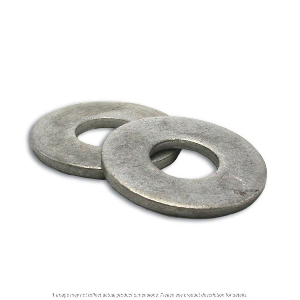

Two flat washers behind the master cylinder to push it further forward, allowing for more free play in the brake peddle push rod.
