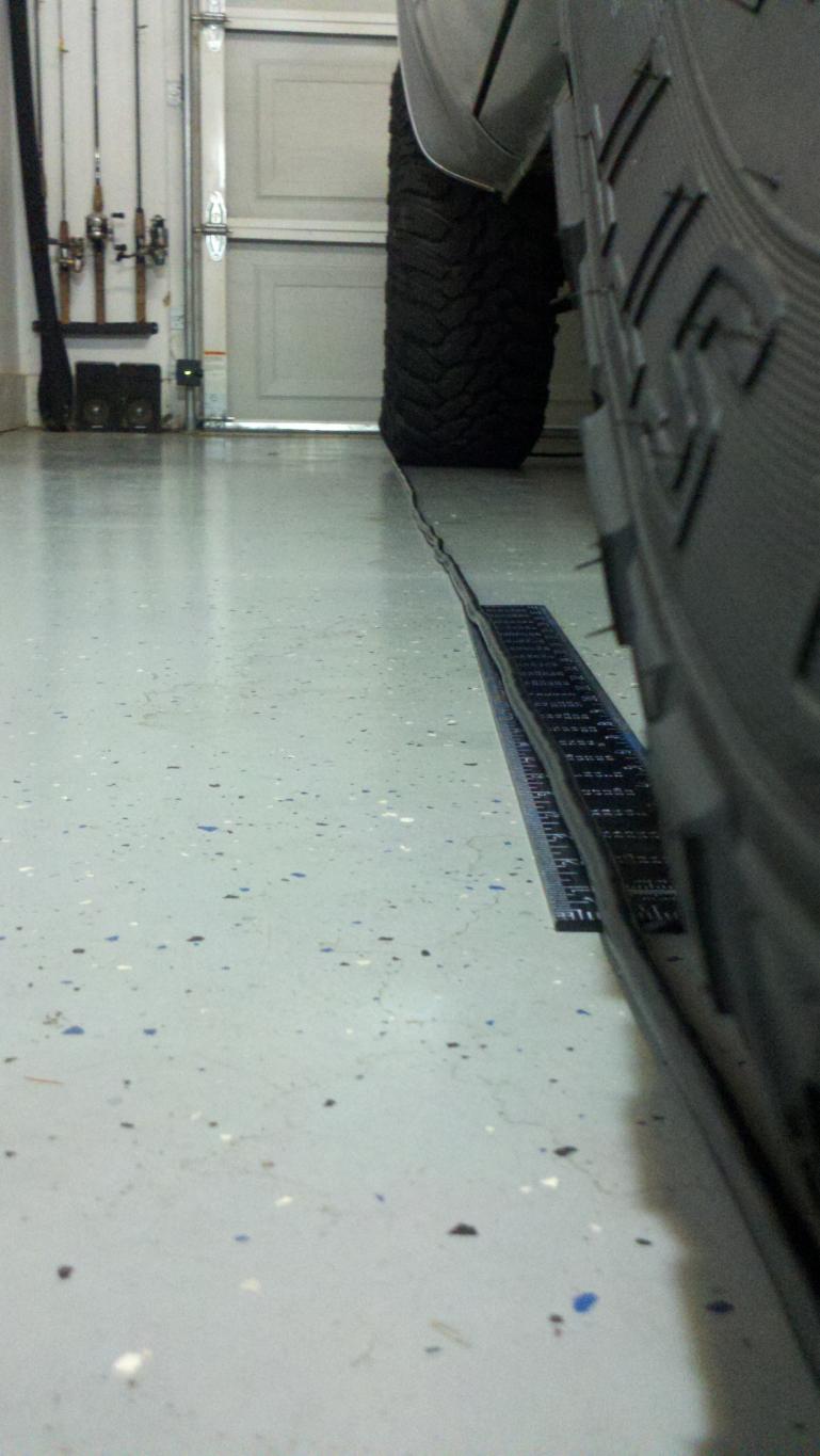

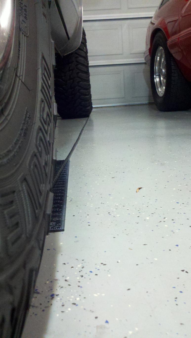

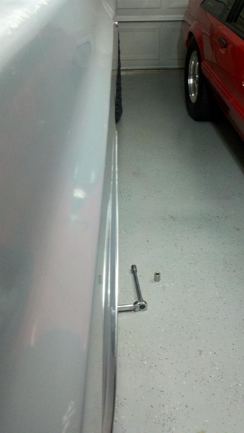

So ever since I bought my square I have noticed the front axle is wider that the rear. I back into my parking spot and when I walk to it in the mornings it bugs the crap out of me to see the front tires sticking out further that the rear. Is this a common thing for the square body? I have noticed it on other squares also.

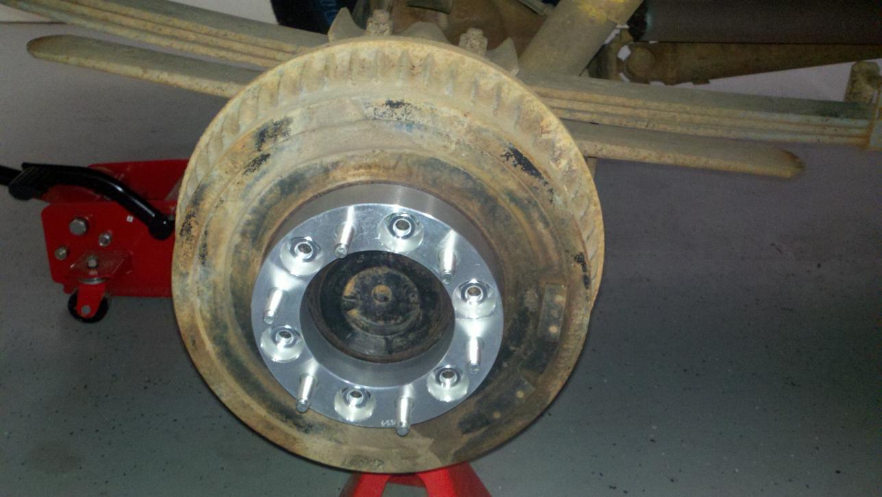

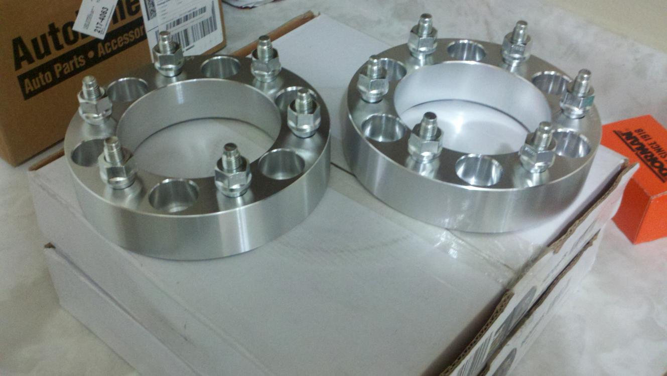

Well it finally bugged me enough and I measured the tire width. Can't remember the exact measurments but the front was roughly 4 inches wider than the rear. So I got on ebay and ordered me a set of wheels spacers. They make different sizes and I thought 2 inch spacers would be to much and a lot of stress on the reared and tire. Then figured 1 in wouldn't be enough to make a difference. So I ordered 1 1/2 spaceres and they arrived yesterday. I took some picures to kinda show the difference in the widths but they not perfect.
After all said and done the front is still about 1/4 inch wider on each side. Normal eye wont be able to tell and its sure looks a lot better when I go to get in it for a drive. The Pictures below is showing the left side with the spacer on and the right side stock. You can see the angle on the line to see the difference. Also I took a picture of the right side body line and you can see the front tire sticking out but not the rear.

I am not 100% sure but i think it was made like that from the factory to help keep the rear end following the front. I would be carefull driving it with the spacers in, especially in wet weather and slick roads. Your ass might just decide to try to pass you more now.

Well after doing some reading you are correct. Thanks for the help. Its not a daily driver so I think will be ok. Work six days a week with a company car so ill give it a shot. If it starts acting up ill just remove them.
