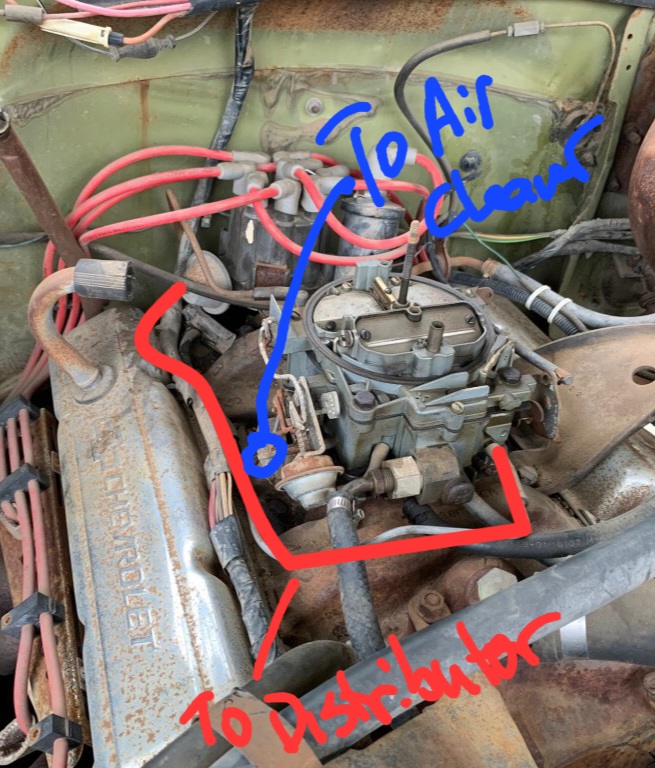

We need a pic with the air cleaner off. Need to see where the stray hose connects to the carbureator. In your second Pic that is the can for the vacuum advance,connect it to manifold vacuum. You still need to check accelerator pump shot. Put a piece of hose on the vacuum advance and suck on it does the diaphragm move you can feel the Plunger on the back with your finger. Does it hold vacuum or do you have to keep drawing on it?
OK - I finally took off the air cleaner housing - which was way easier than I was expecting.
With it off I did find an idle hose that I think came off that diaphragm so I put that back on. It didn't seem to change anything. I fiddled with the moving parts a little to see if they're moving cleanly - they are. One little adjuster I don't think I was supposed to mess with as it didn't pop back into place. Any idea what this is?

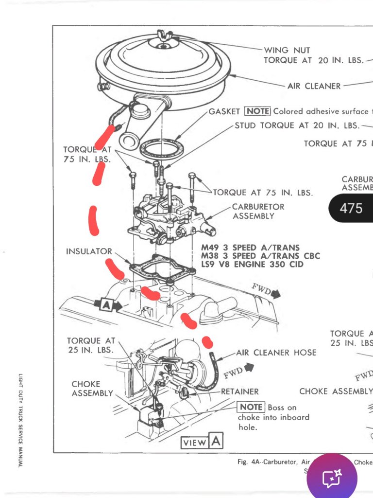

And also - this was that mystery hose - it was coming off of the air cleaner housing connected to something called AC. Thoughts?

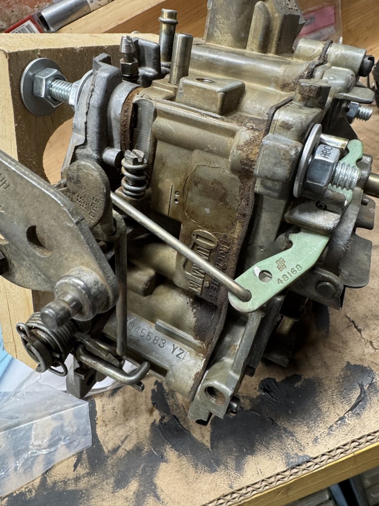

Also get number off the side of the Quadrajet. For example my ‘75 Quadrajet is 7045583 YZ.

Need more pics, with air cleaner off....then people will be able to help

The tube coming out the side is a vacuum port that goes to the air cleaner thermo switch that controls the heat stove valve.

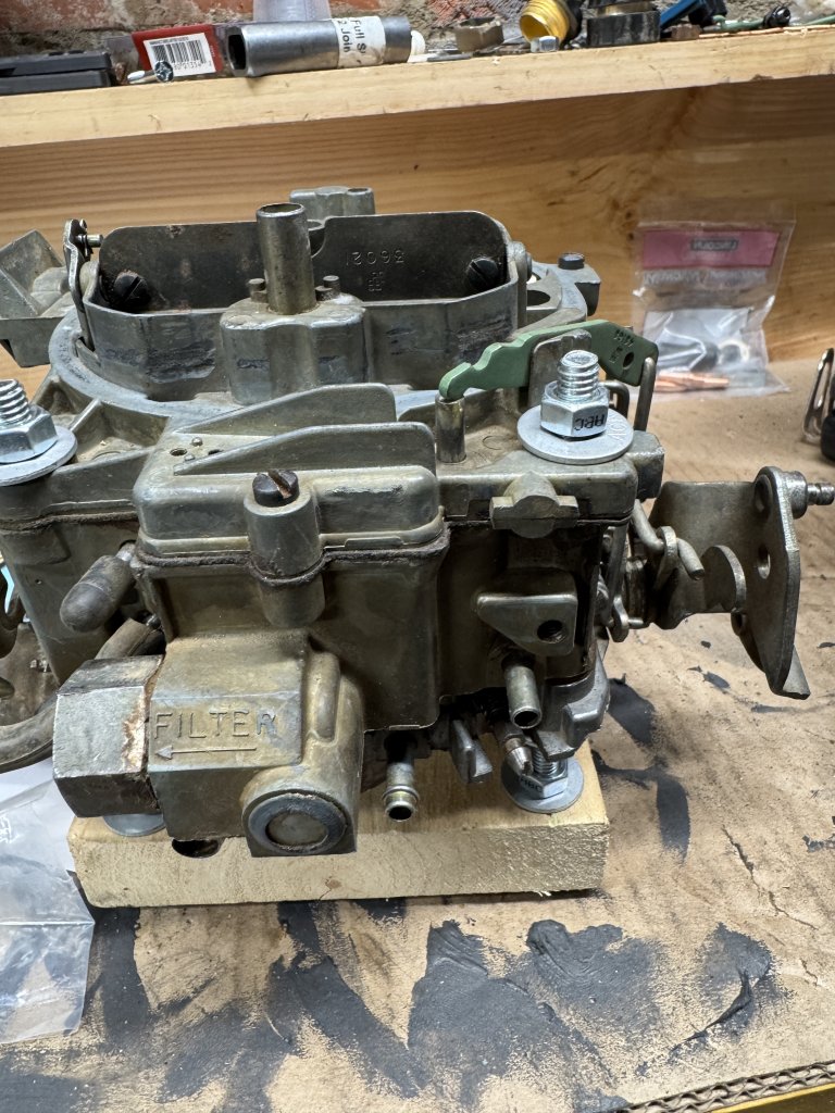

What you are looking for should be on the drivers side of the carb, towards the rear:
Cliff’s site here
A Varajet is a progressive type 2 barrel carb used on 4 bangers.
You have a non mod quad, so it’s 1975 and earlier design.

Look at the picture of my ‘75 Quadrajet and you can see the number (7045583) on the throttle linkage side. In the other picture you can see 3 ports on the front.
- small fitting on the right goes to the vacuum advance
- slightly larger port with a raised ridge is for the vapor canister (I apparently have California emissions)
- just under the block with the word Filter on it you can see the 3/8” port for the PCV
- There are also 2 more small vacuum ports on the front near the choke side. One is capped and one goes to the choke pull-off.
