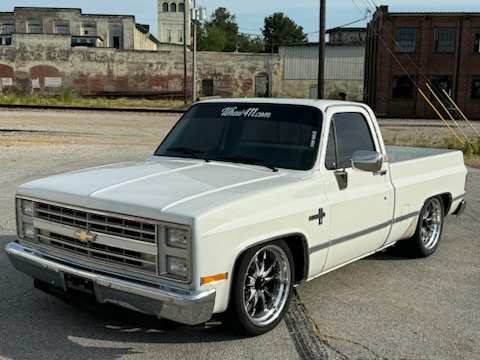

I have a White 1987 Chevy Silverado SWB and I have three questions for the group.
First, when running there is a "squeak" or small noise that sounds like it's coming through the speaker system and even is present when the stereo is off. It sounds like a faint cricket chirping sound and never changes volume. Just a low, continuous chirping noise. Any ideas?
Second question, I'm wanting to lower my truck with a 4/6 drop. Any suggestions on springs and shocks?
Third question, my truck has a practically new 350v8 with a Holley carburetor. What are some suggestions for upgrading to EFI?

Strange question since the pic looks like it basically has a 4/6 drop already….
You're right, and I should clarify. It was already dropped when I bought it. But, the front tires are bottoming out when I transverse any little hump. So, I thought the coil springs and shocks need to be changed or upgraded as they appear to be cheap or low-grade. Any suggestions? Thanks!
