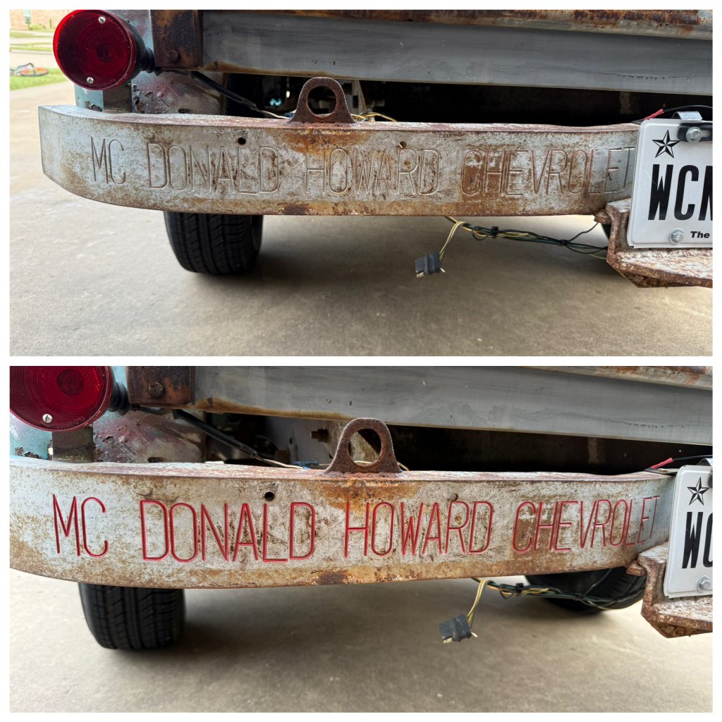

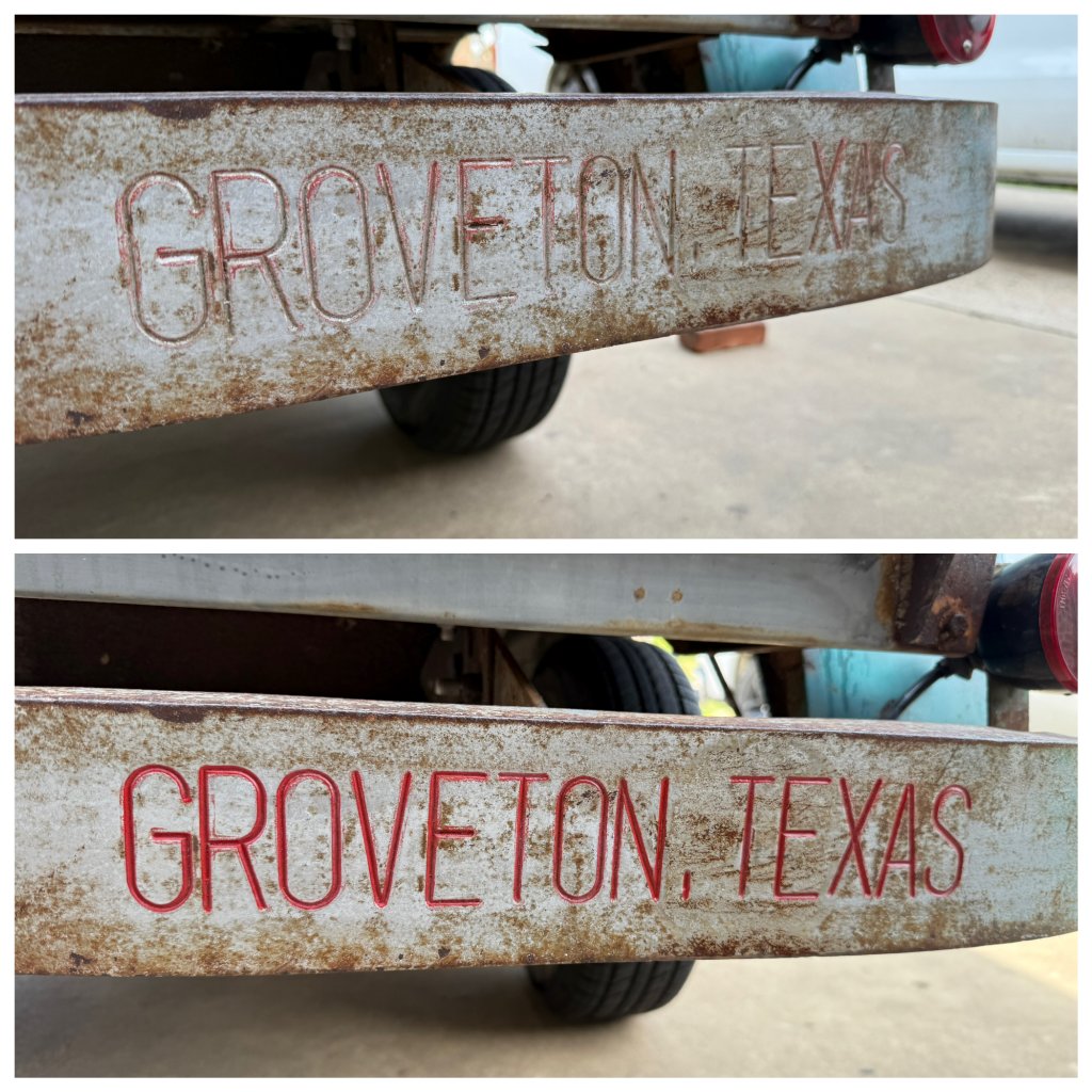

I could see remnants of red lettering from 1965 so I felt obliged to go buy a paint marker from hobby lobby and redo it

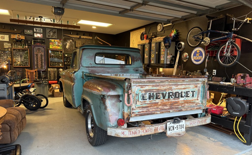

Pulled into the garage and my 7 year old son said “I like that smell”
I said that’s V8 exhaust with no cats and he said well I like it. Proud dad moment. Taking him to his second car show Sunday, might enter the truck

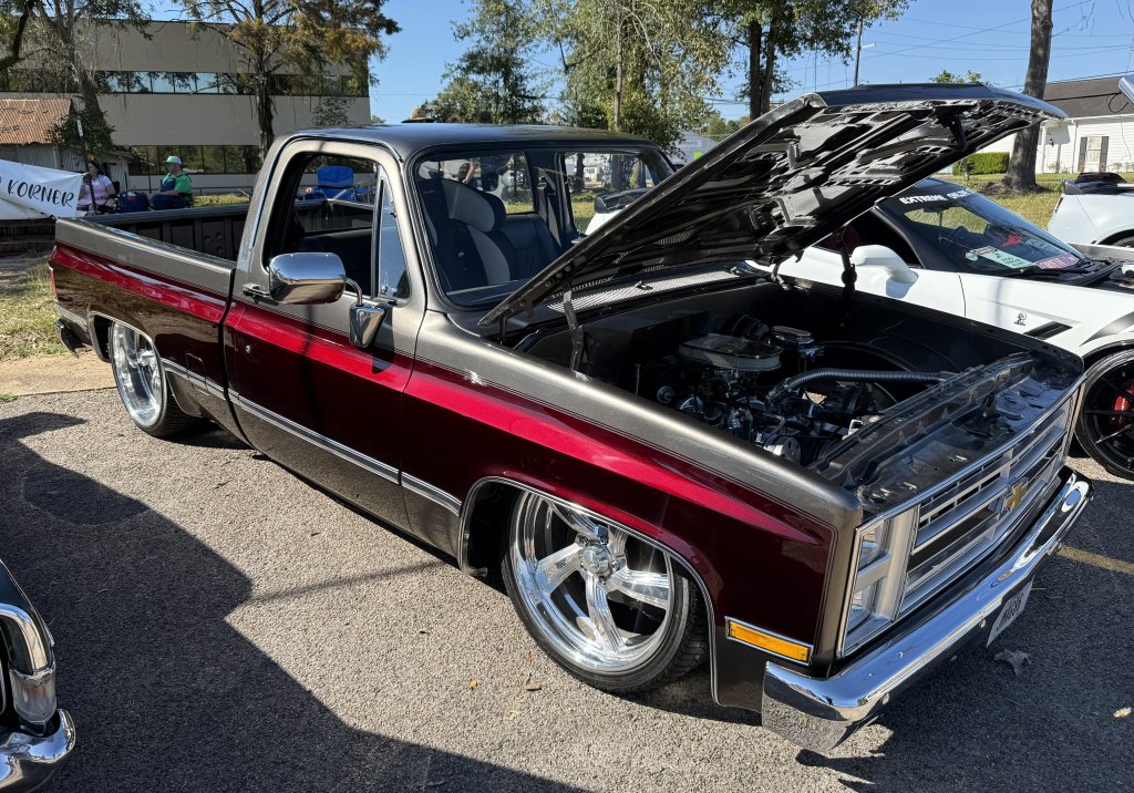

Well, we went to the car show, had a really good time. Didn’t place. Didn’t expect to. One thing I have always found odd about local car shows is the amount of late model cars winning awards. Out of 30 cars there, mostly all classics, the car that won best of show was a 2018 orange 50th anniversary hot wheels Camaro. lol. Just a car someone bought and drove to the show. And the car that won the best paint award was a 40,000 mile 2002 red Camaro. Also a nice car but man there were some slick square bodies there with beautiful paint jobs. I just find it odd that modern cars beat out the classics so often at these things. Matter of fact, that gorgeous square body didn’t even place in the top 10. And it was hands-down one of the nicest at the show.
