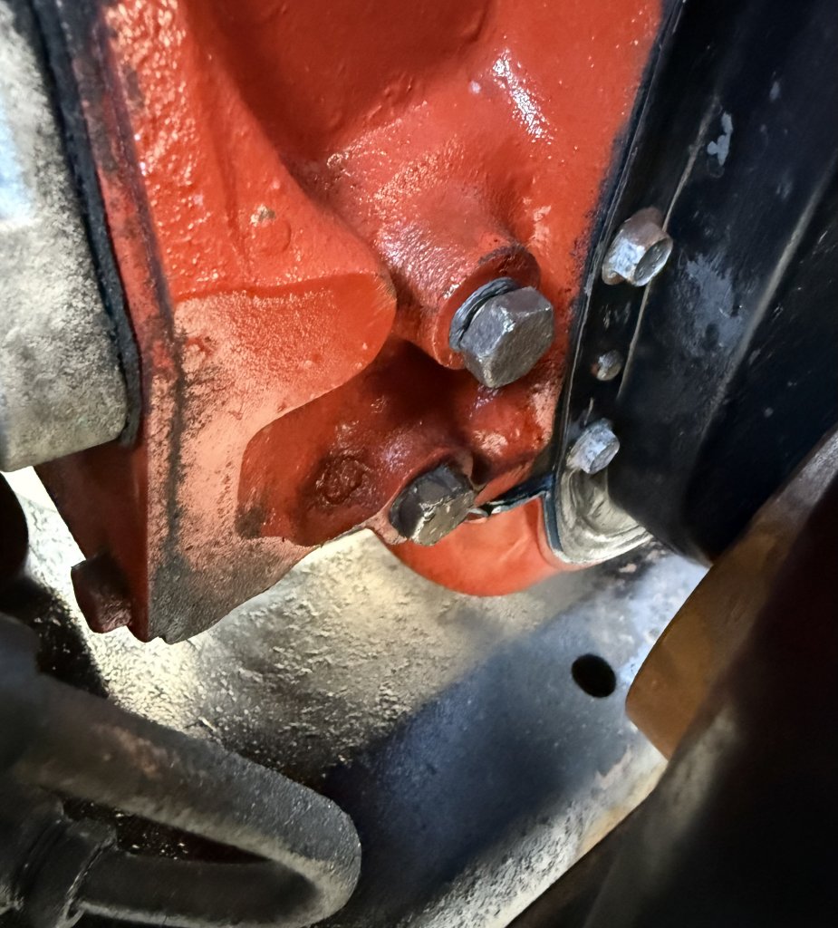

Do these 2 holes go into oil galleys or whatever you call it? Because for weeks that area has been wet with oil, dripping down onto the crossmember. I cleaned it off and it comes back. So the other day, I put some RTV around some bolts and ran them in. And it stopped.
Sure do. How long were the bolts? Didn't need sealant on them. 1/2 to 3/4 inch bolts is plenty long. Too long on the upper, I believe, and it'll hit the fuel pump rod. It's way in there, but still something to be mindful of.
35,125
43,704
The top hole goes through, but the bottom one doesn't.
The top one gets a short bolt. During a fuel pump install, the top one gets a longer bolt, for the purpose of holding the fuel pump pushrod in place.

Cool. Good to know.

I don’t think I ever knew that method, when I installed fuel pumps. I seem to remember, maybe putting grease on the rod to hold it? Or maybe that was something completely different I don’t really remember. My memory sucks.
I will back out the longer bolt and put a shorter one in. I don’t think I’m contacting the Rod right now as I have no issues or noises.

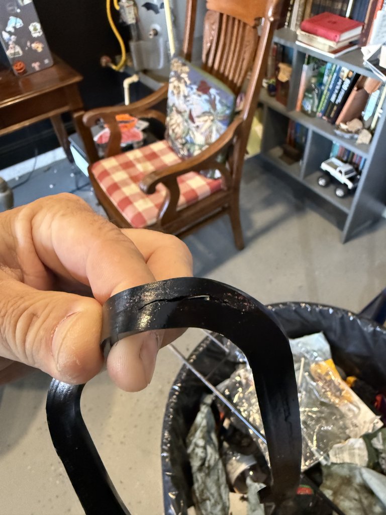

I drove the truck 80 miles Friday, and could’ve sworn I smelled oil burning, but then I forgot about it until yesterday morning when I pushed the truck out of the garage so I could get to the attic access to put the Halloween decorations up. There was a large amount of oil on the floor. Climbed under, and both valve covers were leaking from the back again from when I did the half turn on the valves. I can’t stand those black rubber gaskets. It’s almost impossible to get them tucked in where you need to and I ended up pinching one and half and the other one just wasn’t seated well.I’m told that fel pro makes a good one with metal in it, but I just went with cork and some permatex high tack gasket sealant and that fixed it. I had to put almost 2 quarts of VR1 oil back in it, that’s how much it leaked out in those 80 miles. All down the headers, crossmember, etc. Drove 45 miles today no leaks.
