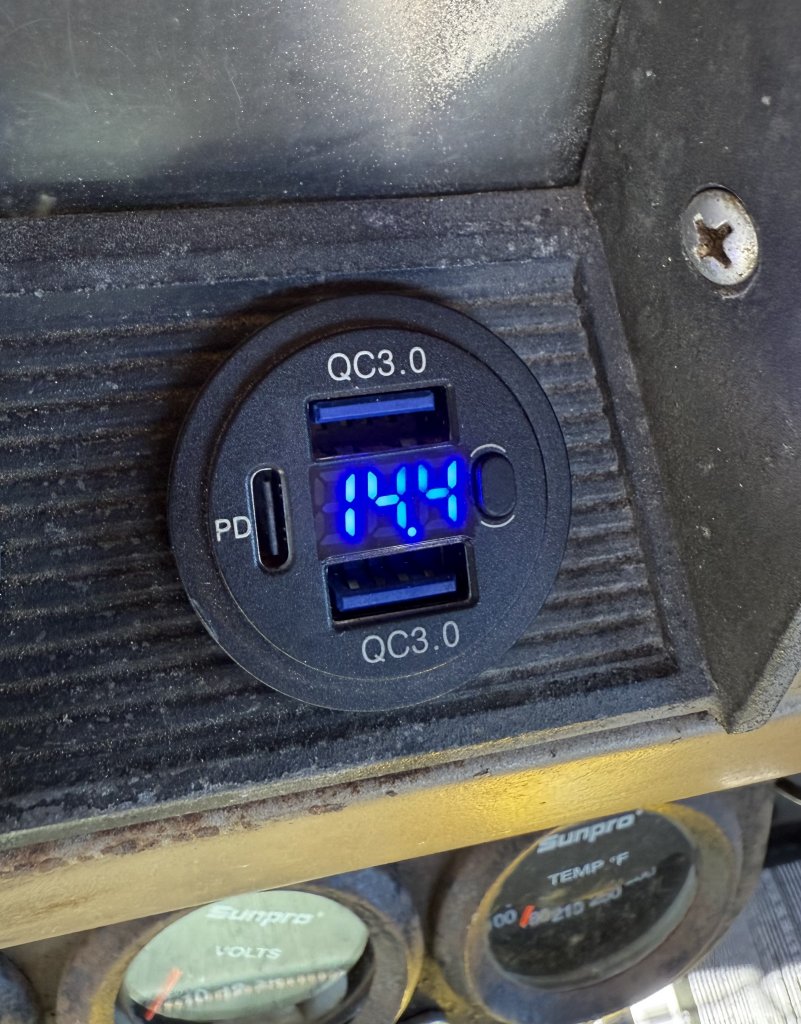

Anyway today I left the lights on on my 65 at the gym for 40 minutes only to come outside and it was deader than dead. Wouldn’t even make a peep when turning key. Figured it wouldn’t drain it that badly that quickly especially seeing how crappy the lights are but idk.

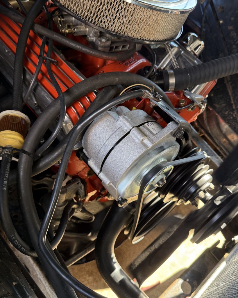

Got it jumped off, but then all the way home the little digital voltage read out I have on the dash Read 9 V all the way home. I assumed the alternator wasn’t charging and that it would eventually go dead again, but it never did. That read out has always been close to 12 V. The battery and the alternator are the same ones that came on the truck so unknown history.
Charging voltage should be over 13volts preferably closer to 15 volts.. Ground the alternator body to the battery negative with a jumper cable,did the voltage come up? Just occurred to me,you aren't using a 1 wire alternator are you. What alternator are you using?

What @Ricko1966 said, and make sure to charge the battery before running it again, no need to put the extra strain on the alternator

Well a new alternator fixed it, didn’t need a lightning cube but I did charge it beforehand.

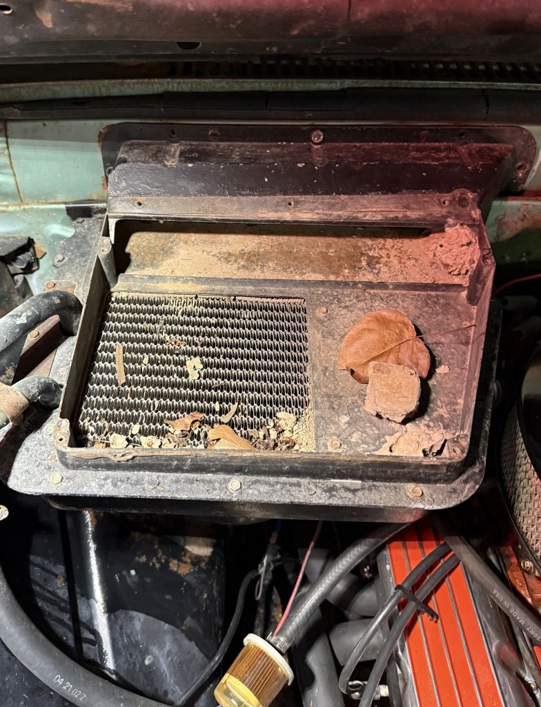

Decided to figure out the defrost in this truck since it’s getting colder here finally. Turns out I don’t have the deluxe heater, which doesn’t surprise me, I have the thrift. Which is a single pull knob on the dash, pull to open the heater vent inside the cab, and then twist it three clicks for the fan selections.

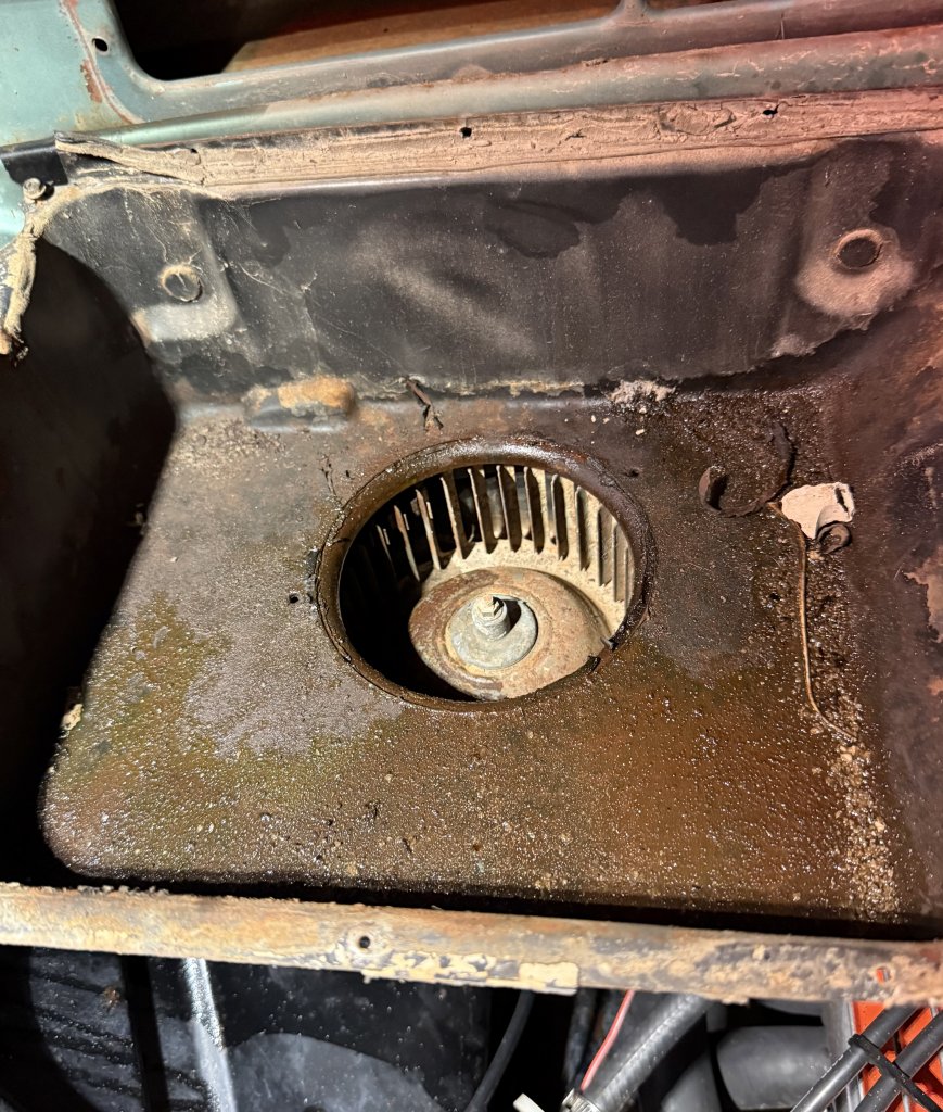

None of that **** works. Turns out it’s been so hot in the cab because the cable is stuck and the vent is on open. It also doesn’t turn for the fan so I’ll have to pull the knob and switch assembly apart to see if I just need to order the cable or one of those as well. For now, I manually closed it at the box so I won’t have heat, because it’s not that damn cold yet.

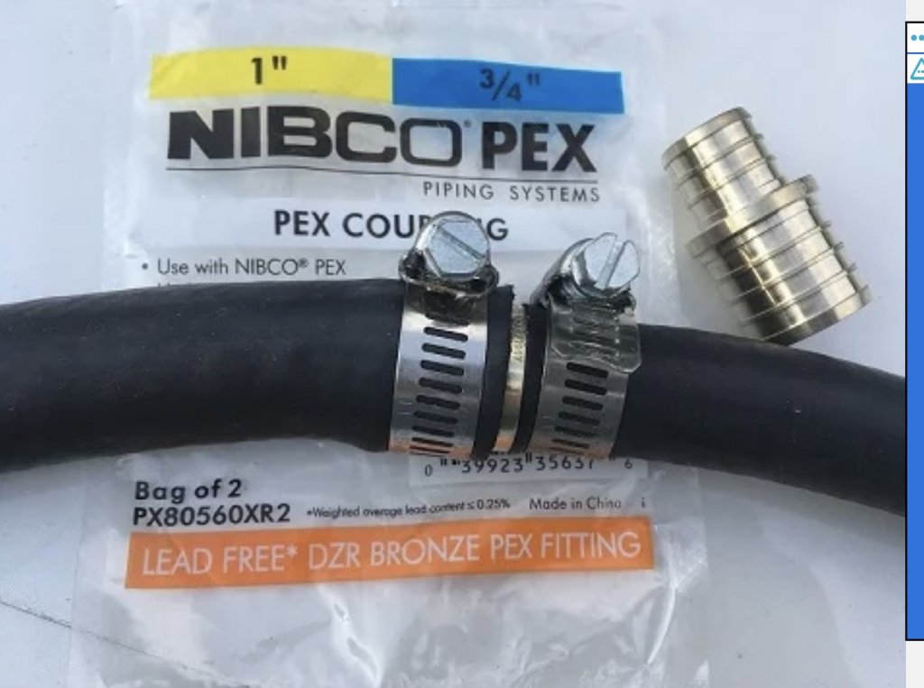

Noticed coolant at the heater box and sure enough it’s leaking, took the time to wash out all of the dirt and debris. Going to get a new core, motor and fan. But for now I went to Home Depot and got a 1 inch to three-quarter inch barb reducer and just put the heater hoses together.

1" to 3/4"? Did you mean 3/4" to 5/8"?

Never thought of using pex connectors for that, but it should be 3/4 to 5/8
35,125
43,713
Isn't PEX measured by outside diameter? That would explain it.
At parts stores, you can get the adapter nipples for just such a purpose, but they are either plastic or really thin brass. I like that PEX adapter way better.

It pays to not know **** about plumbing, you walk in with an open mind
