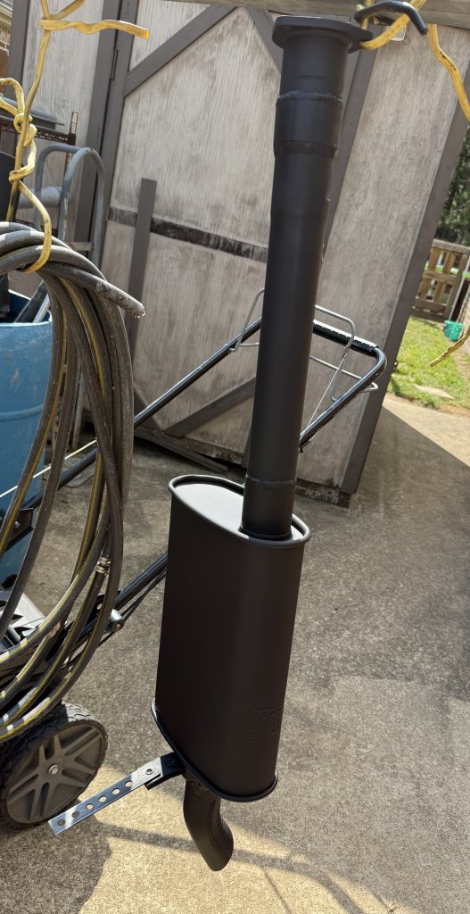

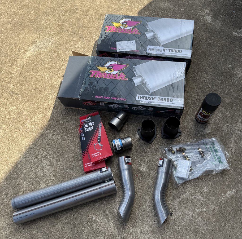

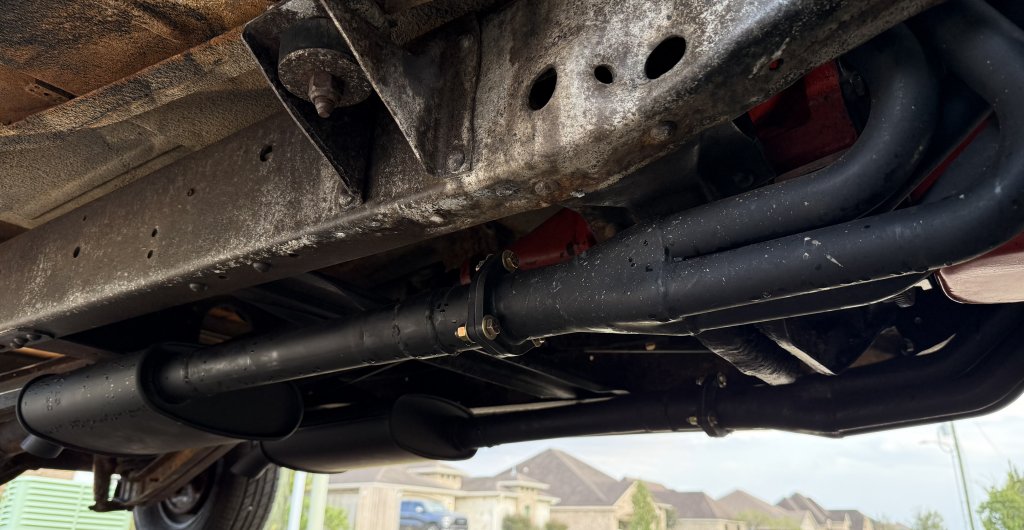

Spent all day and 300 dollars building my own exhaust. I really like how it came out, and it sounds good. I’m still having problems getting it to idle. I haven’t got a vacuum gauge yet. But now that the headers are quiet I can hear loose rockers so I was about to snug them up, when I heard something metallic and the truck died. But it cranked and ran with no problem, but the rockers got REALLY loud. Then I started to think, that’s rod knock.

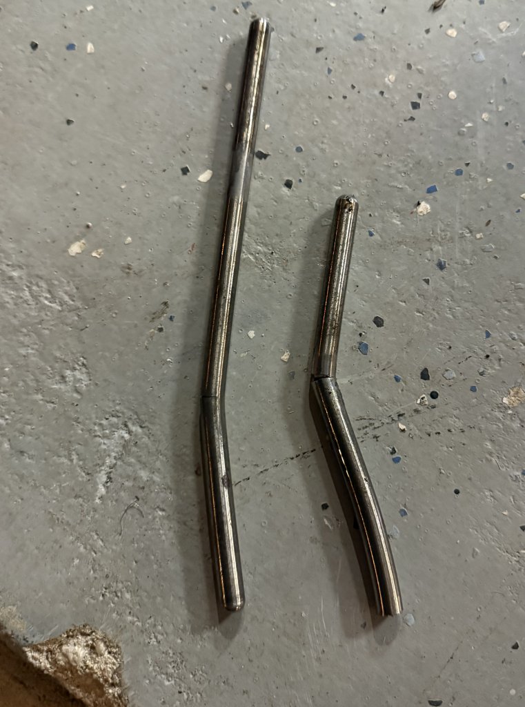

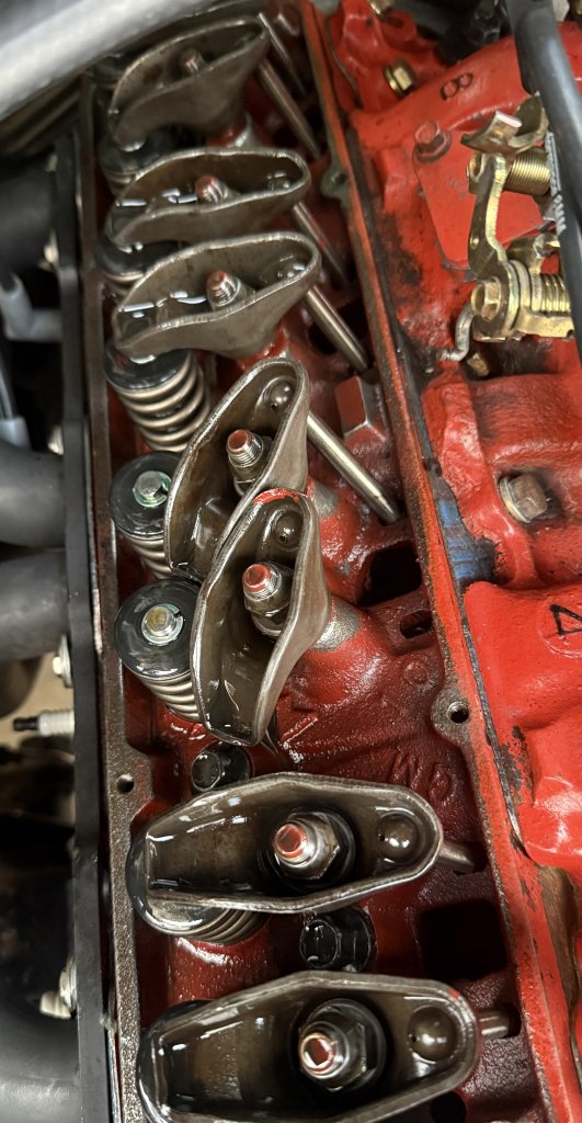

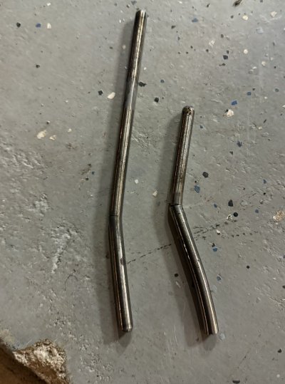

Pulled the passenger side cover where it was loudest and found this. One locked up bent pushrod and and another pushrod just resting I in the hole in the head just out of reach. I reached in with a pick and started to pull it out, but then it fell into the engine.
I give up. Truck can sit, I’m kind of sick about it all
There's a very good chance that you can fish it out with a magnet though this hole:

I forgot to add, one of those magnets on a formable aluminum rod are very useful for that.
That was the whole that I initially grabbed it with the pic from. But when I had it halfway out, it fell and went into the abyss. I guess I could try to find a smaller magnet. But what about the Rod knock sound?

Hell maybe it wasn’t rod knock just super loose rockers

just super loose rockers caused this?

The more I listen to my exhaust video the more I think that was just loose rockers not a rod knock
I can't remember, this is a new cam, right? You may have a couple valves that are tight at the higher lift levels.

Yeah new cam lifters and springs, I did the “turn the pushrod and tighten till it stops then half a turn” method when I put it back together. But then we adjusted them running and I couldn’t hear them to get them not clattering because of the open headers.
I’m slapping in 2 replacement rods this morning and making me a valve cover with a hole in it and I’ll adjust them till they quiet down and hopefully all will be well
