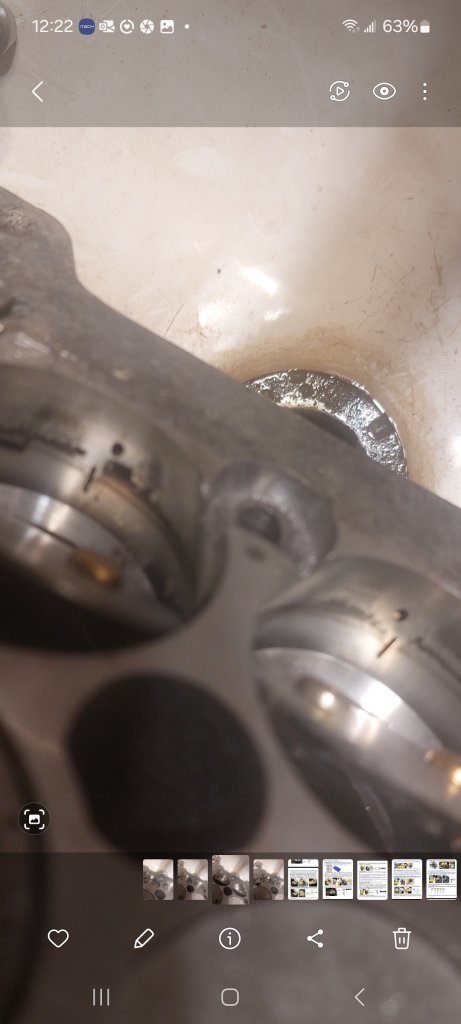

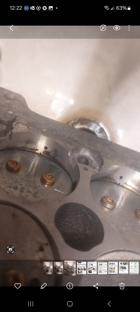

I grabbed a carb and took a couple of pics for you. One pic has a square one pic has the whole transition port exposed,looks like a slit. You want a square. Check your vacuum at idle also as well as your fuel pressure. You are running an edelbrock 1406 aren't you?

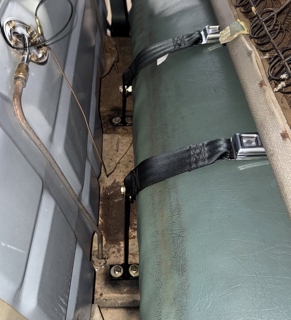

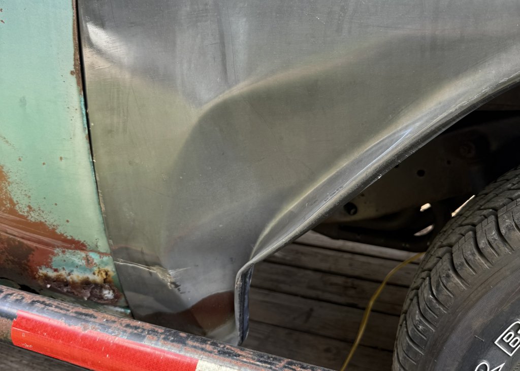

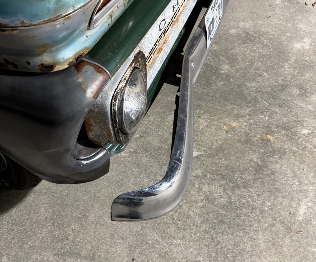

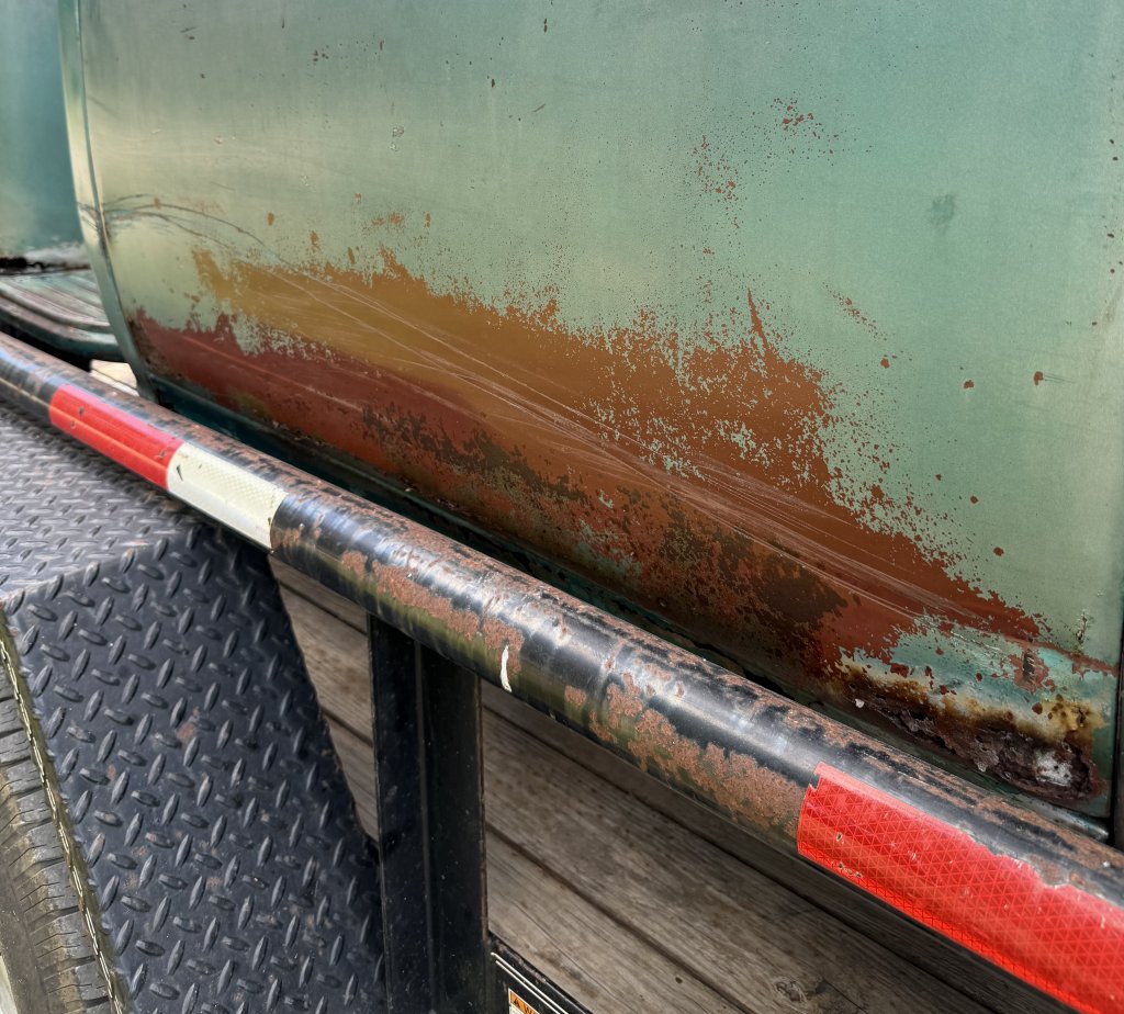

Well guys, bad news. I loaded the truck up on the trailer to bring it to my friends house closer to my house, and ruined the passenger fender, bumper, and scraped the door. I thought I had enough room on that side, but it didn’t work out.
Sucks but it is what it is. I can get another fender, it doesn’t match anyway.
The good news is when I got the truck to my friends house in the country. I drove it down the highway several miles and back and it has no problems doing 65 and 70 without feeling like it’s going to explode. I must’ve had the valves way too tight.

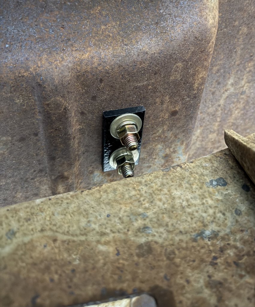

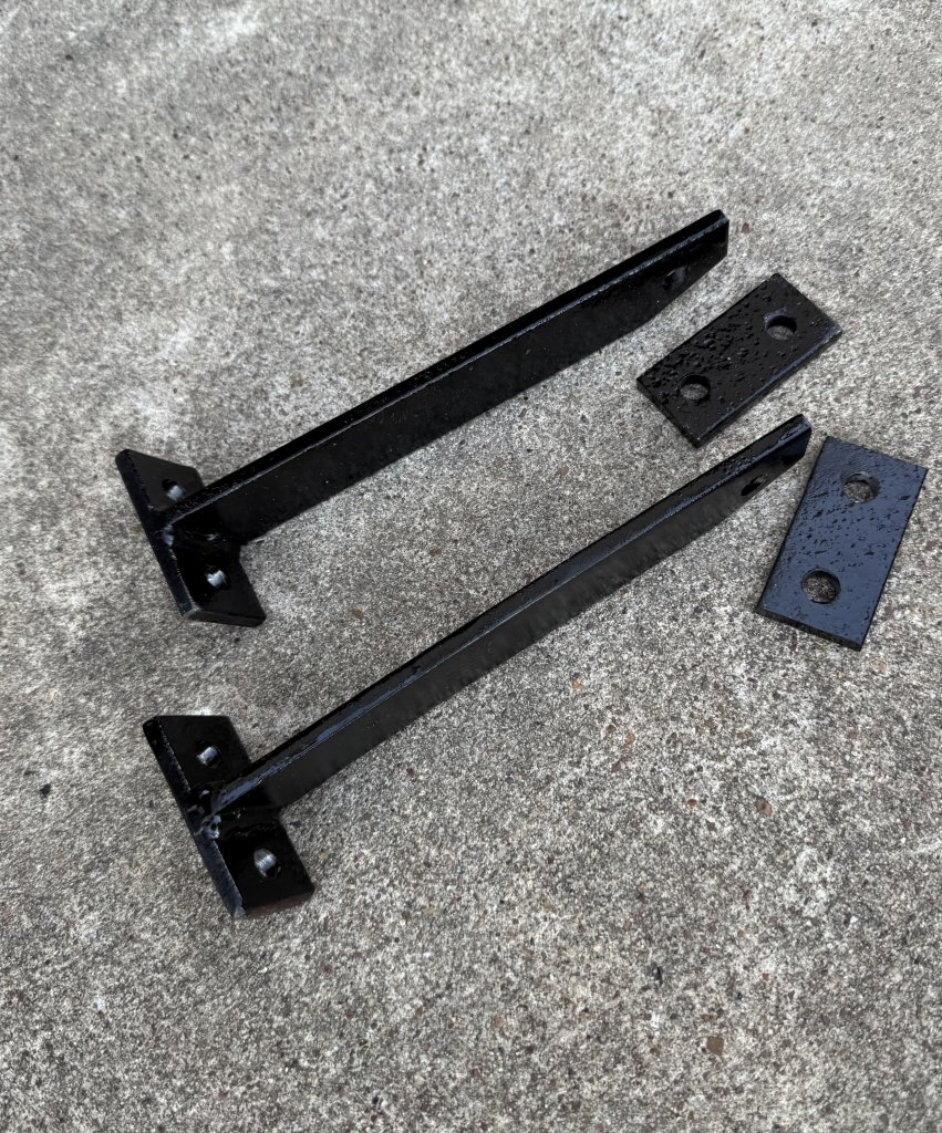

Still can’t afford to get the exhaust finished right now, but I made some brackets last night for the seatbelts which I’m going to install today

Got the seatbelts in and tested. Drove the truck about 20 minutes at 70 and it did great other than being loud as hell still. Got some hard stares when I’d stop at a light and it would go to chopping hard.
