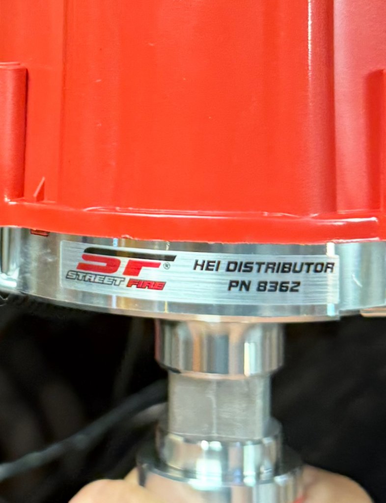

I have no idea. It’s just a unit from oreillys like a street fire or something
10,175
19,682
Is it a Streetfire? Do you have the tuning sheet?

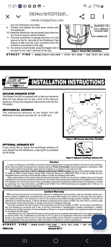

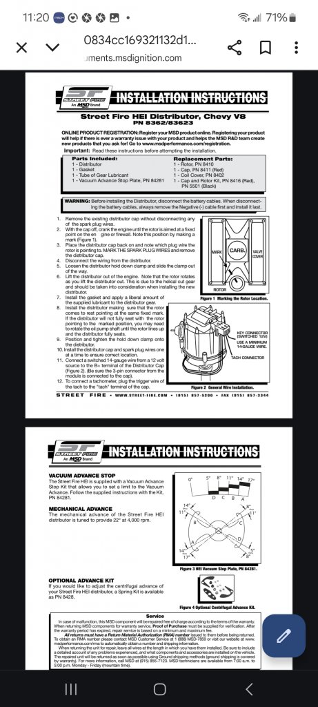

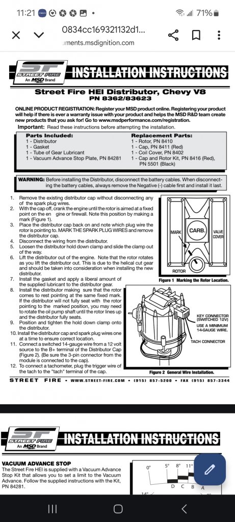

Found some info on the web for you. Have you installed the limiter on the vacuum advance? It should have come with one. And they sell a seperate advance kit which if bumping the timing helps out from idle to 2500 rpm or so, I'd suggest you get it. It comes with limit bushings to bring the advance in the distributor down to 18* which would allow you to run 18 degrees more or less initial. Also the softer springs would bring the centrifugal in sooner.Remember while testing at your mom's if you go 18 degrees + the 22 in the distributor will be 40* which is probably too much total.

Thanks for the info. I was kind of reading on that myself yesterday. Being completely honest, I think the timing is close to 40° total already. I’m going to check that. Should I be checking it with the engine revved up a little bit? Because that’s not how I checked it last time. I just checked it with the vacuum van hooked up at idle.
Honestly, this morning, after I let it semi warm up and took the choke off, the RPMs dropped down to sub 500. Maybe I just need to crank it up to around 1000 idle? I’m going to do some alterations and see.
10,175
19,682
You don't check timing with the advance hooked up. I would usually check it with the engine revved past point of maximum advance. Shoot for 36*. But since I know there's 22 centrifugal in that distributor,check it now at a low idle,vac disconnected. Bump it up to 18,see if it's better bump it to 20 see if it's better. As for idle are you setting it with the mixture screws? If you run the idle stop screw in too far you create a new set of problems.
