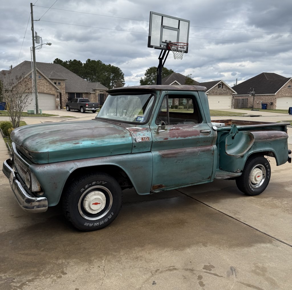

Fender came out good, I should’ve gone a little darker on the turquoise, but I could always redo it. Threw a couple of earlier model caps on the wheels that I had hanging on the wall.

That came out really nice! I’ve done that type of weathering on model kits, never a 1:1.

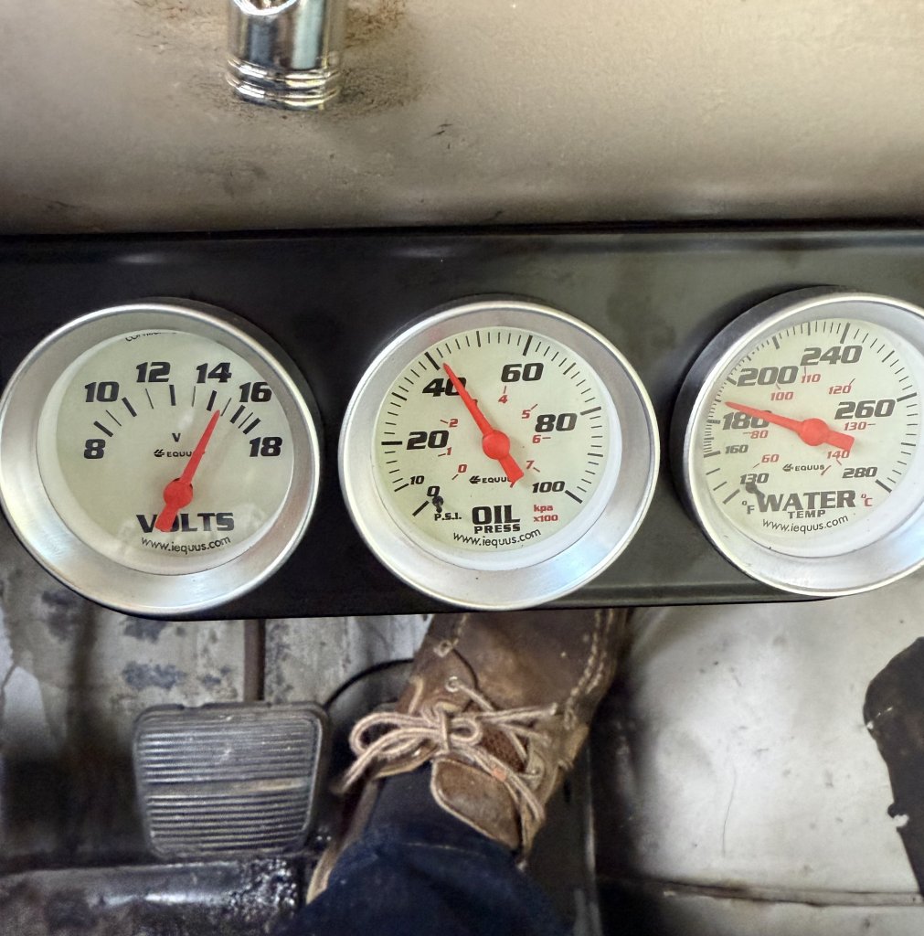

Here’s one of the gauges working
