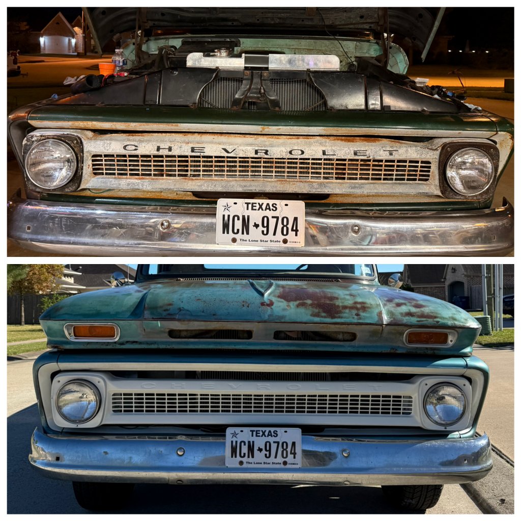

Finally got a running 65 C10

If you look closely to the lower passenger side bumper bolt, it appears to not be snugged up. If there was a rattle up front, that could be the culprit.

Of course, I went and re-looked at the photo again and noticed the bumper brackets are missing. They could have been removed as part of the process of working on the front end.

Honestly the bumper has been so messed up I didn’t care but now that I straightened it out I’ll get some new bolts with the chrome head. I don’t think either side has a bracket

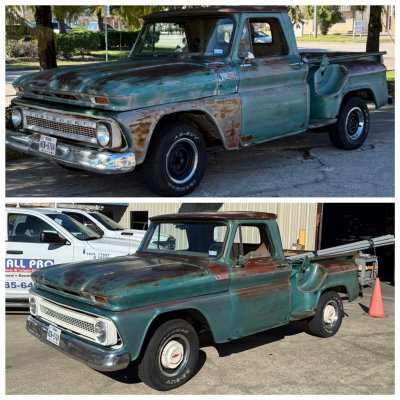

Spent today sanding three layers of paint off the grill, and bending it back into shape. Someone bent it up on the top all the way across badly. I didn’t realize it wasn’t supposed to be that way until I started looking at pictures online. Went to the paint shop, got a color match on the hubcaps, enamel in a can. Sprayed it, and the outer stripe around it on the truck. Whatever the piece is called that mounts in front of the core support, it was Hunter Green so I made it turquoise. Now the whole truck pretty much matches. The grill is a little loud, but it’s growing on me and I think it looks better than before. I think it will look a lot better once I get the Chevrolet lettering on.

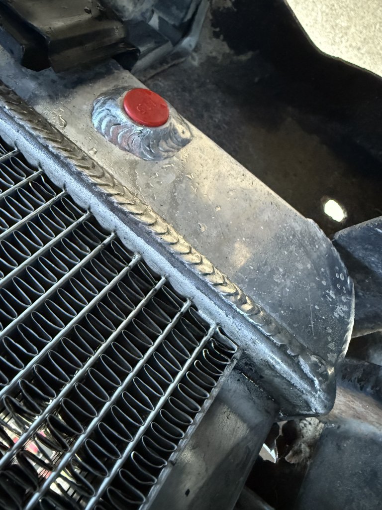

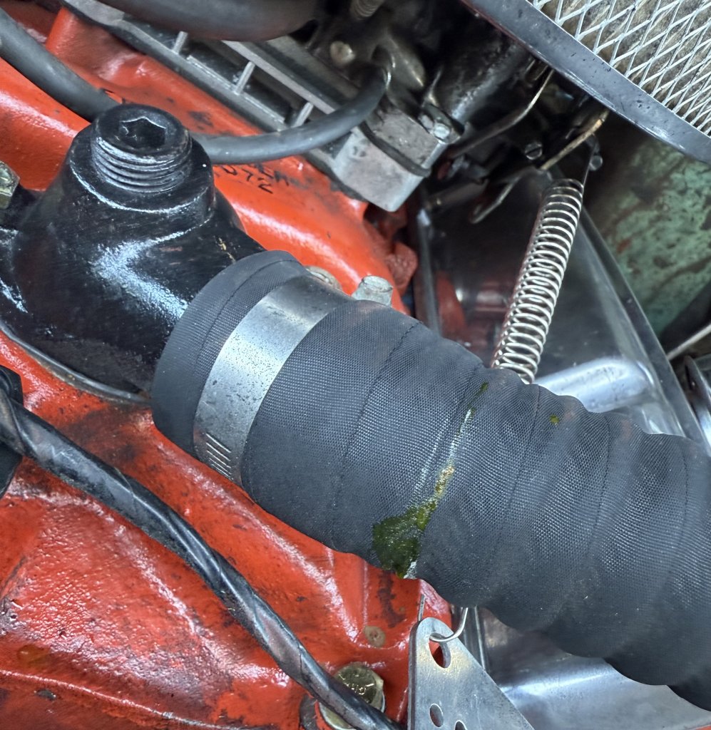

Can I cut this hose and be rid of the tiny weep hole it has? It’s new from LMC, I believe it said it was trimmable
Also my new aluminum radiator seems to have a leak. Leaked out a decent amount of coolant on the garage floor last night, somewhere from the bottom left corner.

If it won't run without the choke something is going on. It shouldn't run with the choke,the choke cuts off the air supply and it should go so rich it will barely idle of not just die. It should also be very rich and hard to drive at small throttle openings. Will it idle without the choke ever? We need a vacuum reading with the choke off. And I need to tease you about the radiator and coolant hose.Pool heater, man it seems you can't get a break. Did you dig up an Indian burial ground or something?

It looks like there is a wire built-in that hose. If there isn't, or if it's loose, yeah you can trim it. I don't know what brand of hose that is, but I only buy Gates or Continental brand, and Dayco if I am in a bind and that's all they have.
