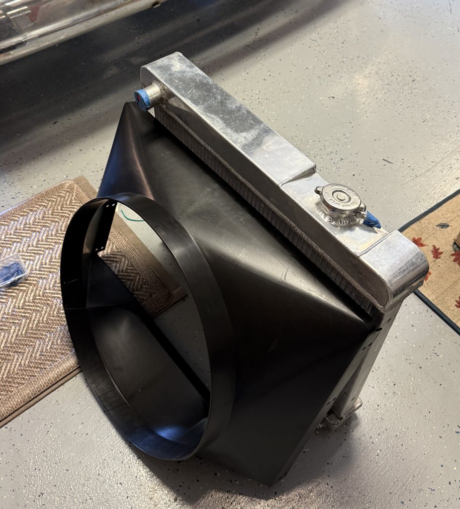

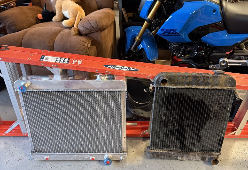

Quality radiator from my friends radiator shop and a new shroud. New hoses and mounts

Nice! Hopefully your fan fits in there good and centered. You'll find out soon enough
I’d honestly like to go to an electric fan and will soon I’m sure. I hate the clutch fan sound when you rev the engine working the clutch when you take off
I have longtube 1 5/8 headers and flanges coming tomorrow as well as stage 8 locking bolts. After I get the headers on I’m going to get it to the exhaust shop for tails and mufflers
13,906
23,757
I guess I've driven more old vehicles than new. Old car fan noises don't bother me, whereas, electric fans do.
I have to ask, why did you buy the shroud if you're going electric?

Wasn’t planning on e fans until I drive the truck the other day and revving the thing so it won’t die with the clutch makes the fan go in overdrive and I’d just rather not listen to it

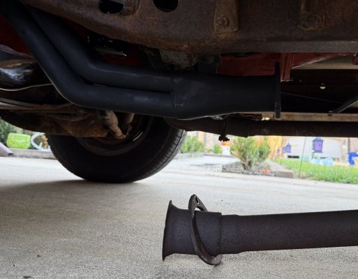

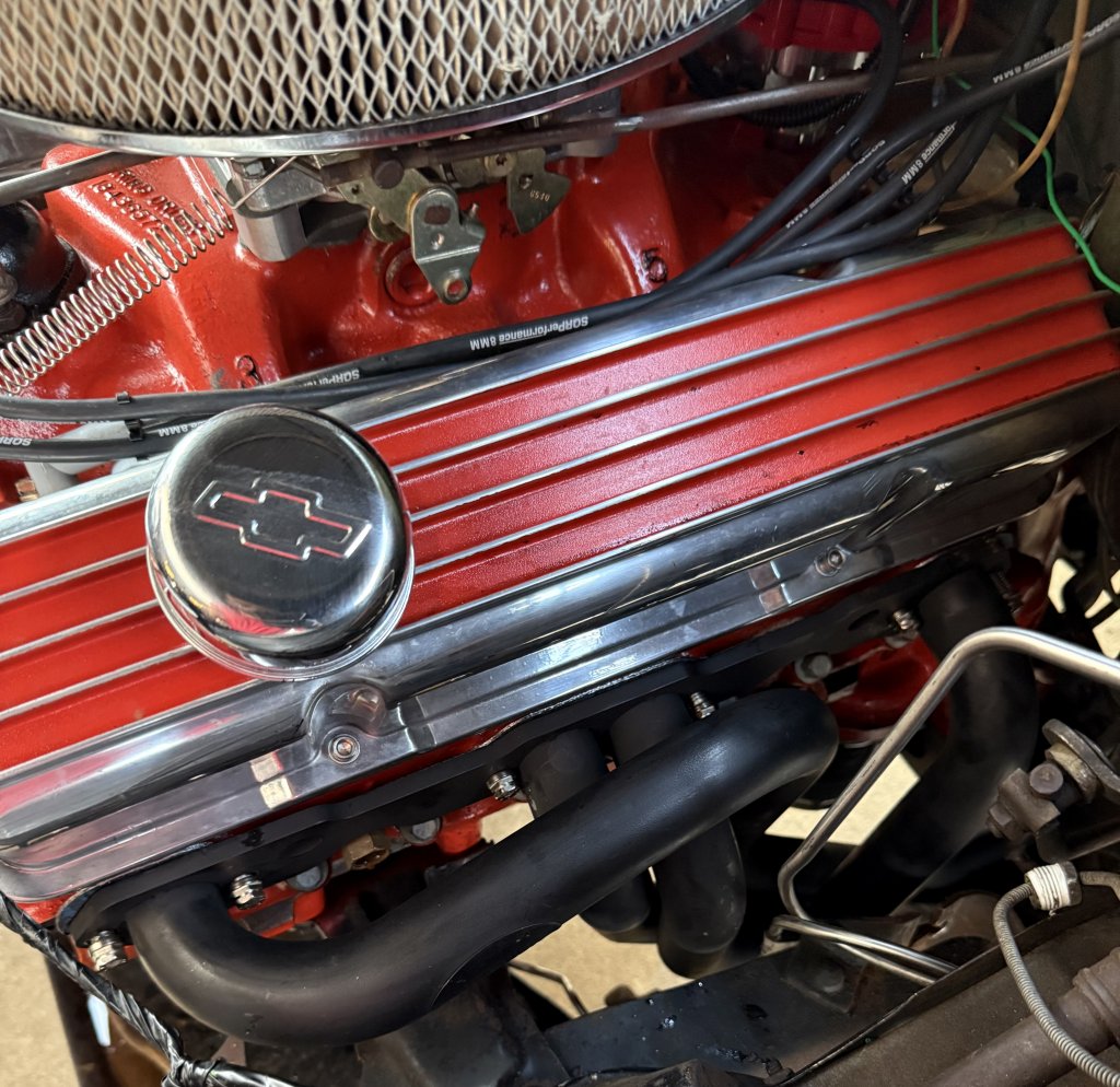

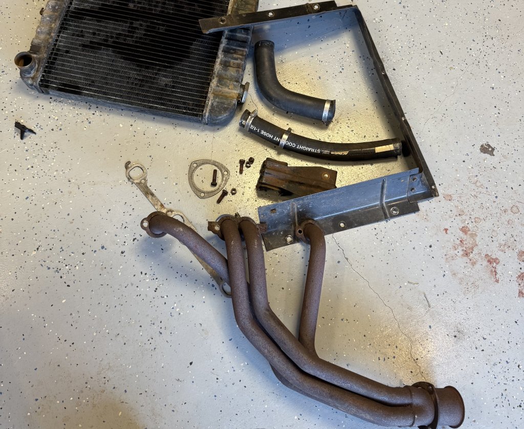

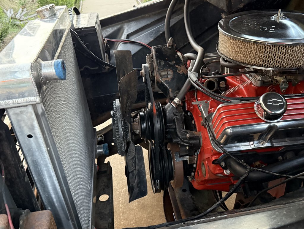

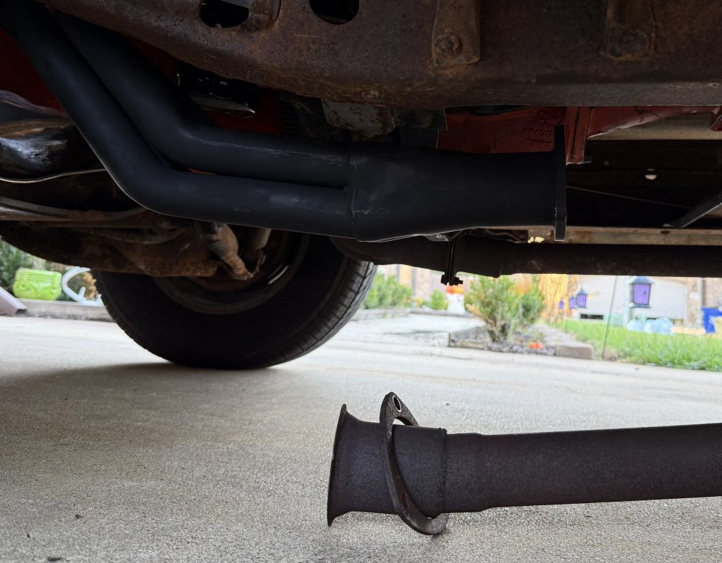

Today I took the driver side header out and get the new one in, I ended up not wrapping it just paint it with high temp which is now half scratched off. Stage 8 locking bolts, had to jack the truck up as high as the jack would go to get the header in from the bottom. Wouldn’t go in from the top. I was worried about the clutch Z bar, but it went back in fine. New fell pro gaskets. These headers are longer than the old ones and I like how they have the solid welded flange instead of the loose one. I bought collectors to mount onto these for the exhaust shop to take it from there. But I’m going to chop some pipe off the end of the runs by the axle so I can move it back and at least bolt the mufflers back up to the headers so I can drive it the 35 minutes to the exhaust shop that everyone recommends.
Took the radiator out, the new one fits nicely. I’m just waiting on the mounts and the clamp for the top and the new hoses.
The exhaust and the cooling are really big parts of the build and this thing will be so much more fun to drive when they’re done
It’s FINALLY decent weather here in Texas so wrenching has been enjoyable

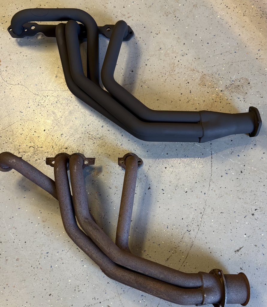

I actually ran these exact hooker headers on 2 of my squares

Also the shroud doesn’t fit. Clutch fan too big around.
9,948
19,087
Keep in mind if you go electric, most electric fans published ratings are grossly over stated. And most of the aluminum shrouds I ve seen were designed as nothing more than a mount for the fans.With almost zero regard for true real function as a shroud. If I went electric I'd be looking at using a factory fan and shroud or mounts from a production vehicle. Something else to keep in mind factory electric fans draw significant power,and not just because they wanted amp sucking fans and couldn't find more efficient fans. I think a Ford Taurus fan will out perform 99% of aftermarket electric fans. One last thing of interest electric fan manufacturers do not recommend E fans on 4 core radiators.
