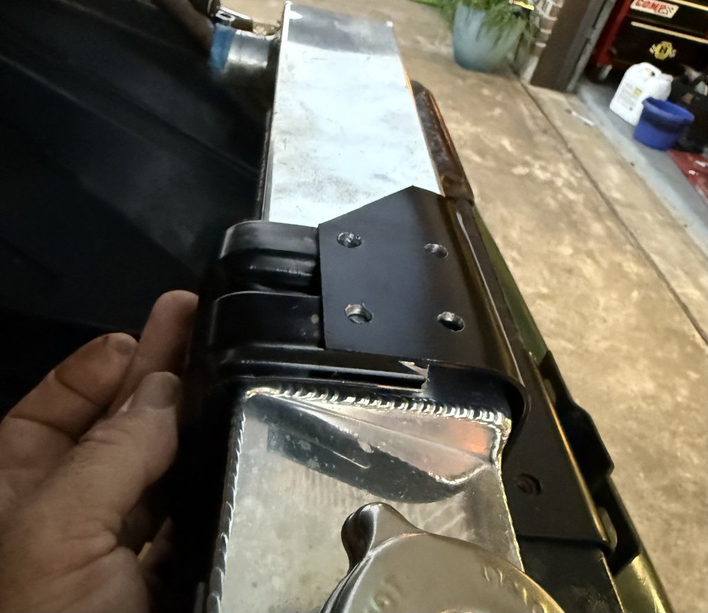

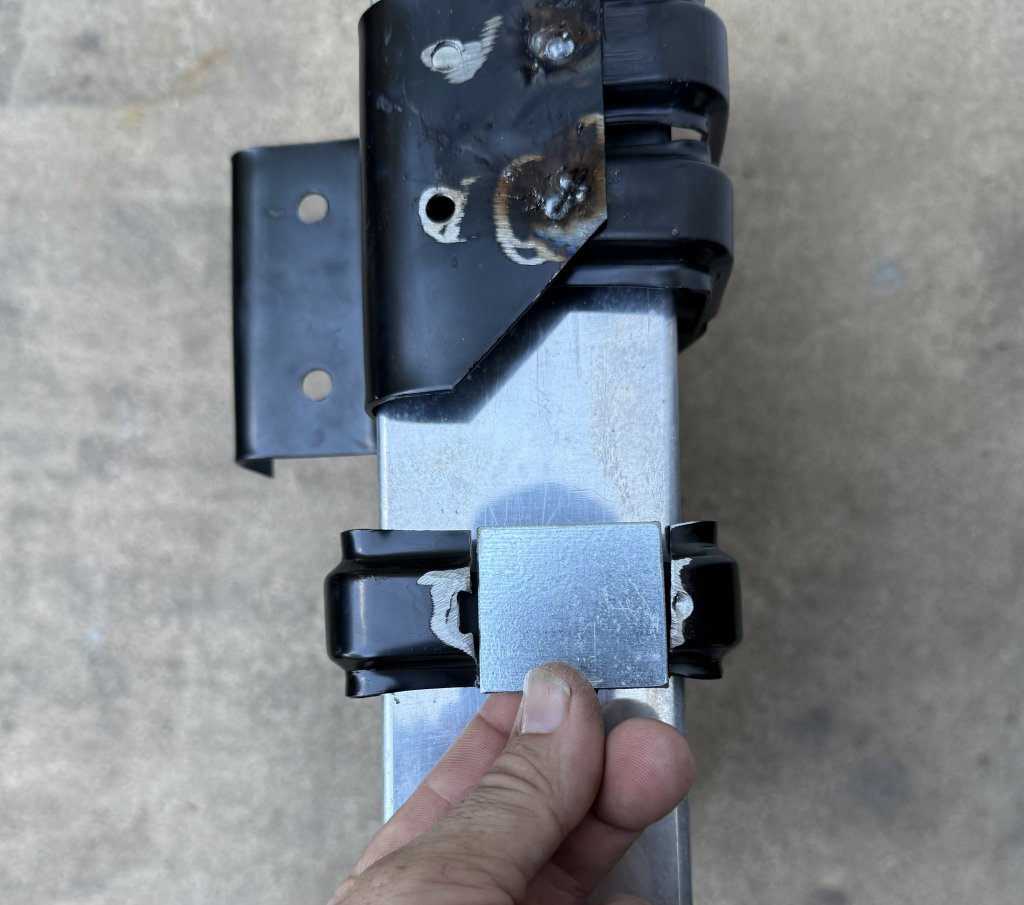

Neither the bottom or the top pieces I got from LMC work for the radiator. So I drilled the top one out and sliced the clamp parts, and tack weld them back with rubber underneath.
I only have one bottom cradle I guess they were sold not as a pair and I didn’t catch it. I need to get another one and they need to be sliced and lengthened

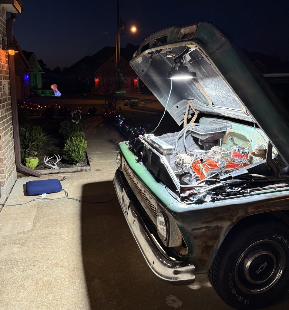

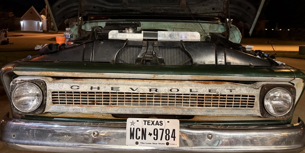

Also a left over 250w high bay led light works great when you need to see too good
I'm guessing it fit in the frame cradles? That radiator looks to be 4-row tank size.
I have three 65 frames, two came with the lesser radiator and the original one from Mean Green has the 4-row cradles. I have a rebuilt copper/brass 4-row sitting in wait for to be put into service.
If I had extra 4-row insulators I would share them, but I only have the one set from 1965, and I have no extra 4-row brackets or cradles.
It did not fit in the cradles from LMC that were designated V8 style or whatever. They’ll have to be widened

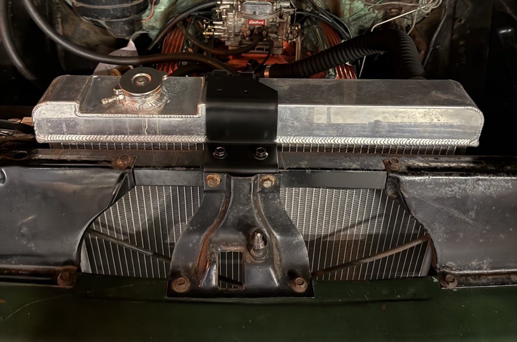

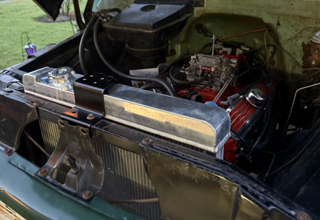

Took all the crap I bought, sliced it up and made cradles for the bottom and made the upper bracket clamp thing fit. Got it bolted in. Thing should cool well with the 4 row. Got the hoses on, top a little long but I guess I can trim it. I bought a generic overflow tank kit from LMC but idk if I’m gonna put it in or not. Should I?

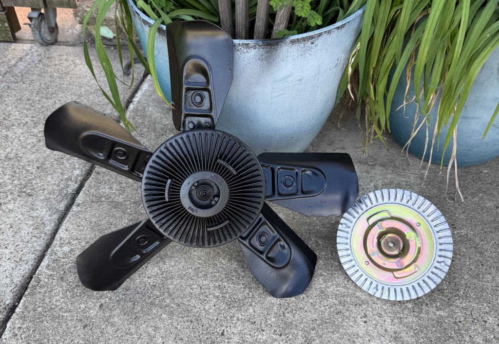

Went to change out the clutch fan just cause I bought a new one months ago but the current one is way beefier and says made in USA so I just painted it along with the fan and kept it.
I wonder if a 2 piece squarebody shroud will work for this truck? I can think of a reason why not

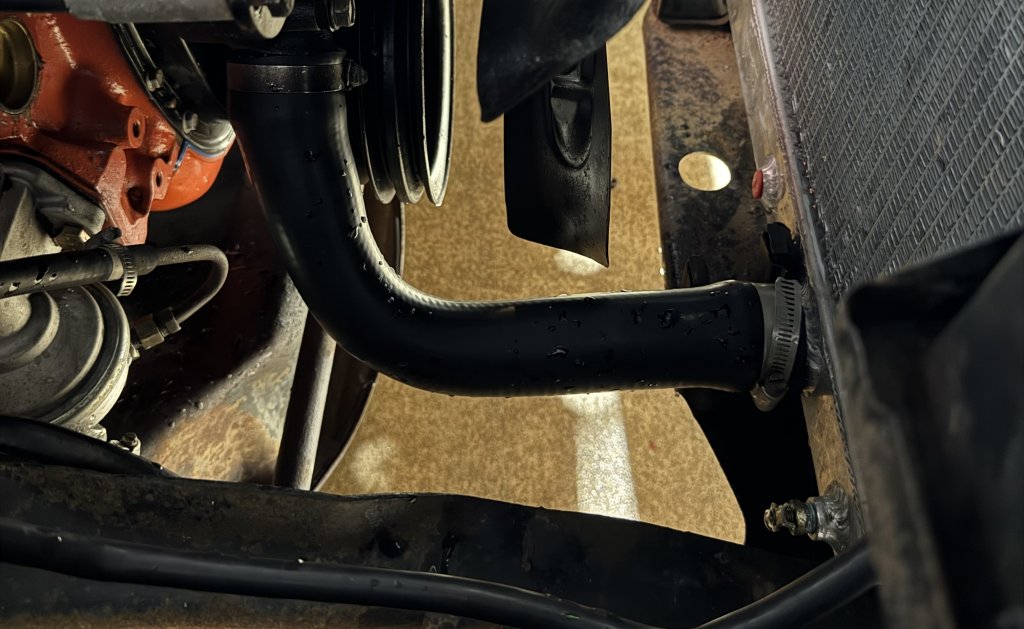

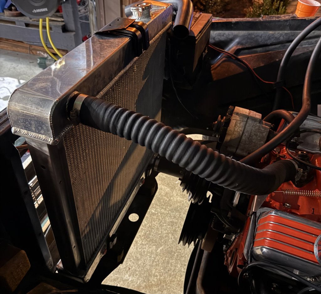

****. Fan hits lower hose. Have to figure that out

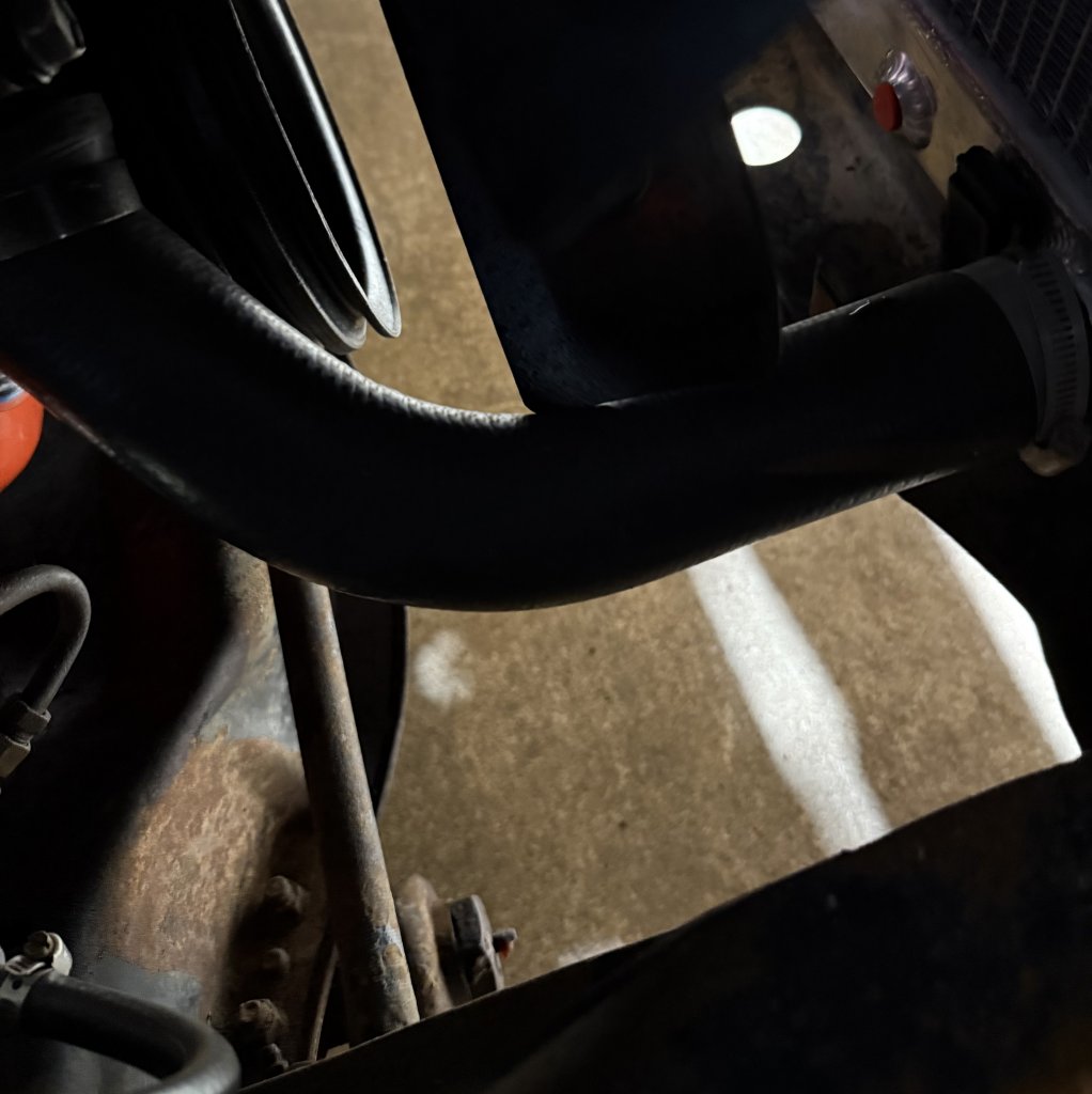

Fixed with a new hose
