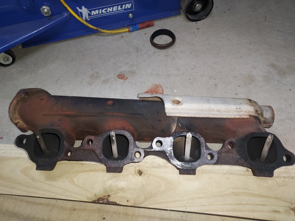

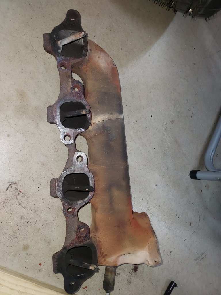

? Does drivers piston one, and passenger side pistons four and six look like they are burning hot or something?
Thought I would ask those who know, or if I should even be concerned.
Currently pulling at least passenger head because very front and back bolts broken off by previous owners(s).
FYI, me and my daughter removed all others with PB and torch, NP! Ugh!

Does look a little hot. But somewhat normal to me. Just really clean burning. I would check plugs too.My friend had a bump side with a 360 2barrel and it ran so lean and hot the exhaust manifolds were always white looking lol.

I haven't run any manifolds with the fresh air tubes so I can't say how those should look. But I would say you're maybe a little lean, but with some valve guide/seal issues on the darker ones. Its gonna be real hot in the manifold so I would say they shouldn't be that sooty, they should be more in between the dark ones and the light ones
Oil burner? Take a look at the tops of the valves from the intake and exhaust chambers.

Thank you guys. I will know more with intake removed and then head. With the TBI the gas pressure regulator isn't adjustable. Haven't had long enough to know if oil burner, nothing noticeable out exhaust but that's not necessarily an indicator.

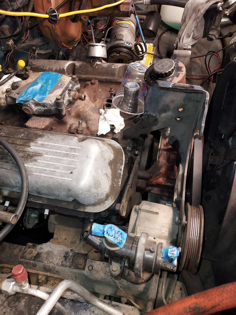

Whew, not an easy engine to work on. Had two wire hold down clamps on front of engine, one for starter and the other behind power steering pump for couple doo-hickies down there. AC moved aside, bolts cleaned polished ready to reinstall.
Removing coolant to tbi adapter which should be empty and front goose neck, but if some spillage no holes.
After that, distributor, valve covers, intake and head.
Just had to report.

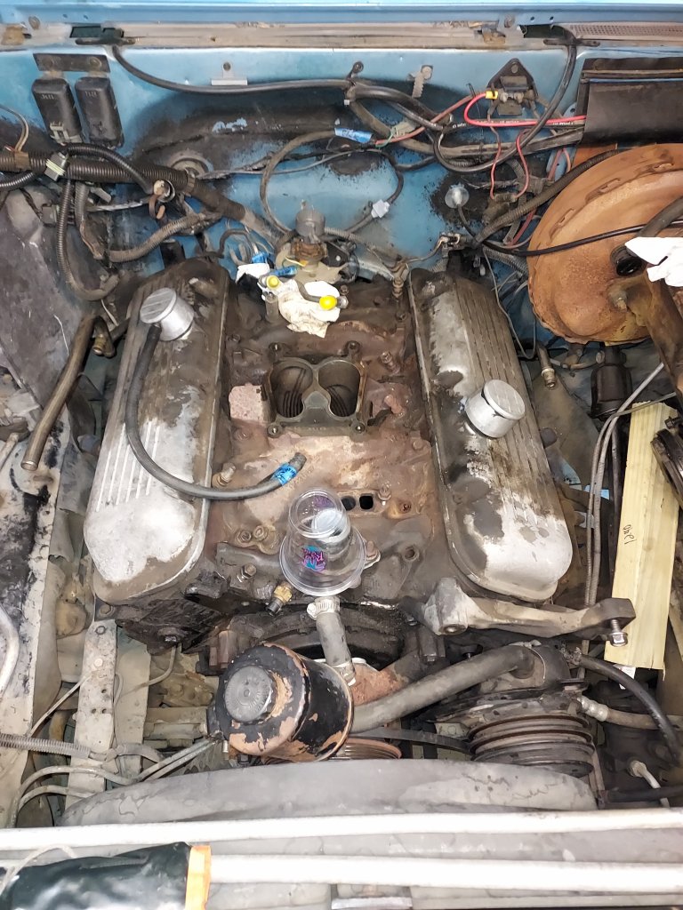

Removed coolant connections, then egr to remove AC brket on intake, and alt. Now gonna finish delete of smog pump on alt brkt. Then 3 bolts on bracket, one on intake, two into head. Maybe tomorrow for my birthday I get to distributor, valves covers and intake.

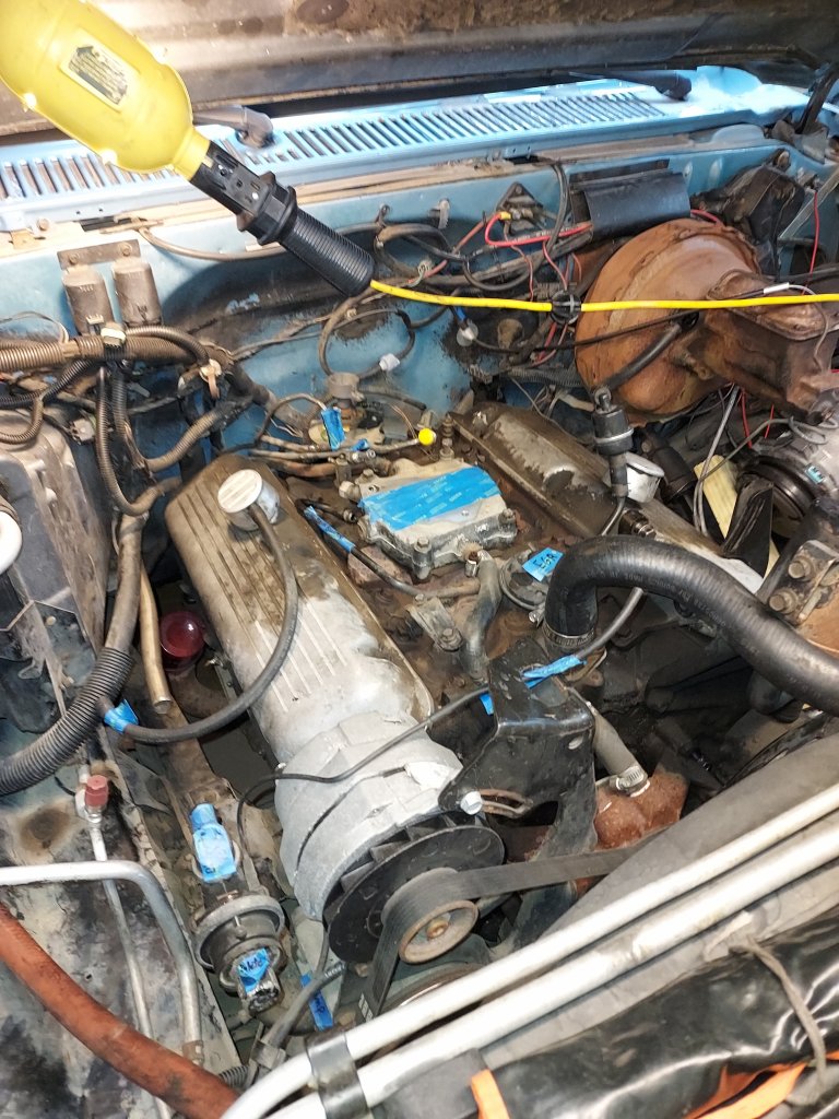

Well, thinking if I'm fixing all that leaky oil, we're gonna have to pull timing chain cover.
So, at that point I'm gonna just have to pray about it cause might as well pull engine and rebuild. 1) Pull passenger head to tap two bolts, or 2) Pull heads and remanufacture. Or 3) You're almost there! Rebuild!

Correct. I was going to pull pan and check, replace rear main seal, but realizing with every freaking thing we're removing to get to some thing else we'll have torn down. So, really wanting to rebuild.
