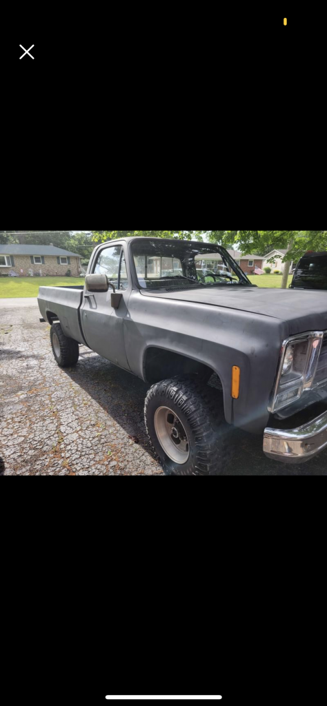

I came here because I recently bought a 78 k20. Im kinda new to working on trucks. And I’m hoping to be able to find some answers here.
My truck currently has 33x12.50 R16.5 tires on it. Those tires seem to be very expensive.
What I’m looking for is what size rims I can put on this that will have more options for some less expensive tires?
As of now it’s my daily. In northeast Ohio so I guess I’m looking for something decent in the snow. Thank you to everyone in advance!

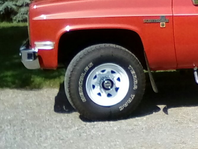

Welcome fellow Buckeye. I would stay with 16. Factory steel with dog dish hubcaps look great or spokes.

That's a 16x8 Crager rim. I think the offset is 4.5. You can still find a limited selection of 16s, I would not go any bigger.
