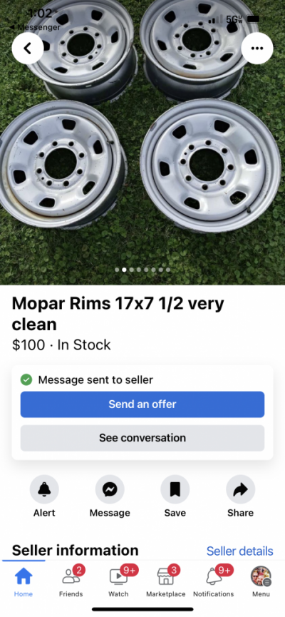

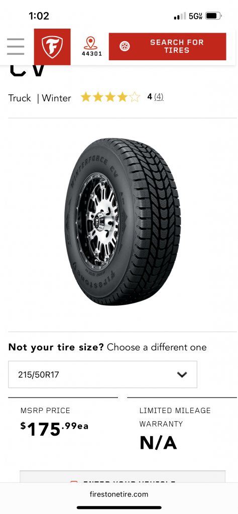

Ok everyone I found some 17x7.5 on the market place and some cheap Firestone tires that I think will fit on it. What do you think?

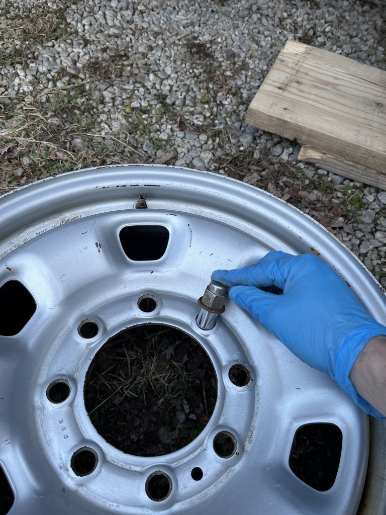

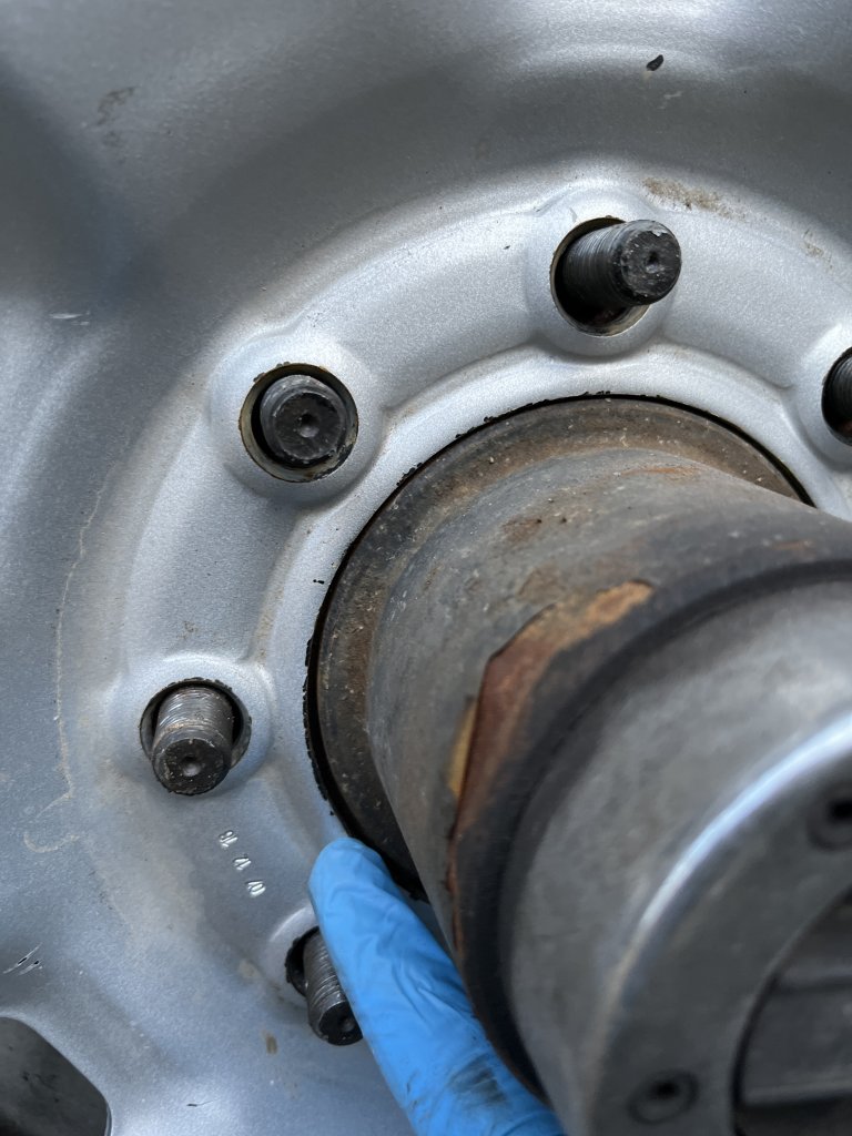

Well let the learning begin. I hope that buying new lug nuts will fix it. Also is the boar of the rim supposed to center the wheel or do the lugs do it?had to see but there is a pretty large gap around the hub. The old lugs don’t fit in the new rims.

Looks like you need new lug nuts. Get some regular ole steel wheel lug nuts. The bevel on the nut should match the bevel on the wheel and kept tight will hold the wheel/tire centered. If you can find and afford them get the longer nuts that don't have a hole all the way through them, ie they keep the exposed threads covered. Don't have to have them but will understand when you have a flat. Far as the center hole goes, it don't have to fit.

Thank you. I’ll definitely get the longer nuts.
