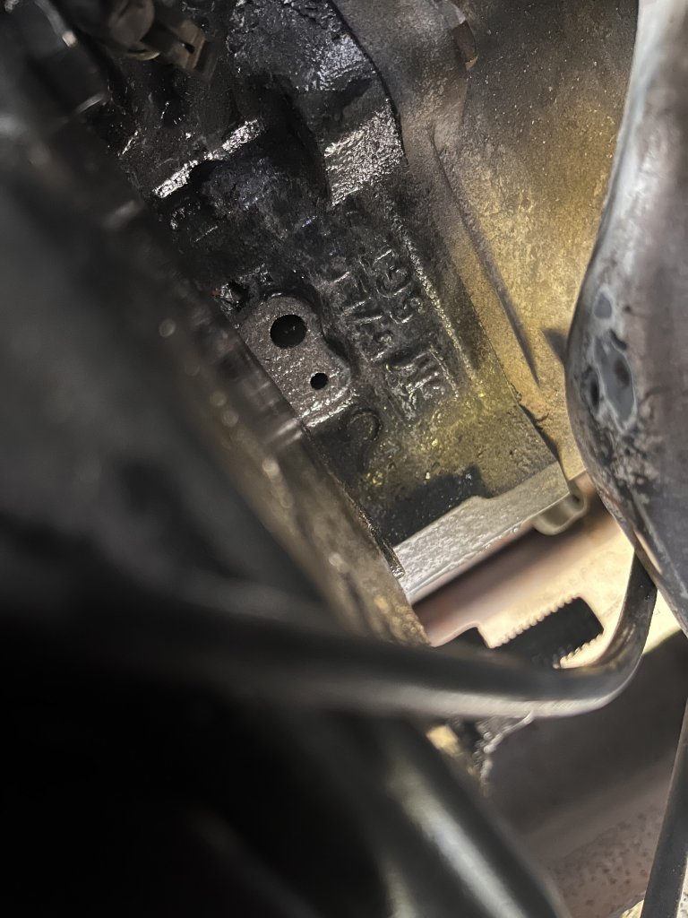

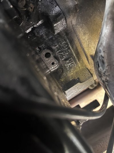

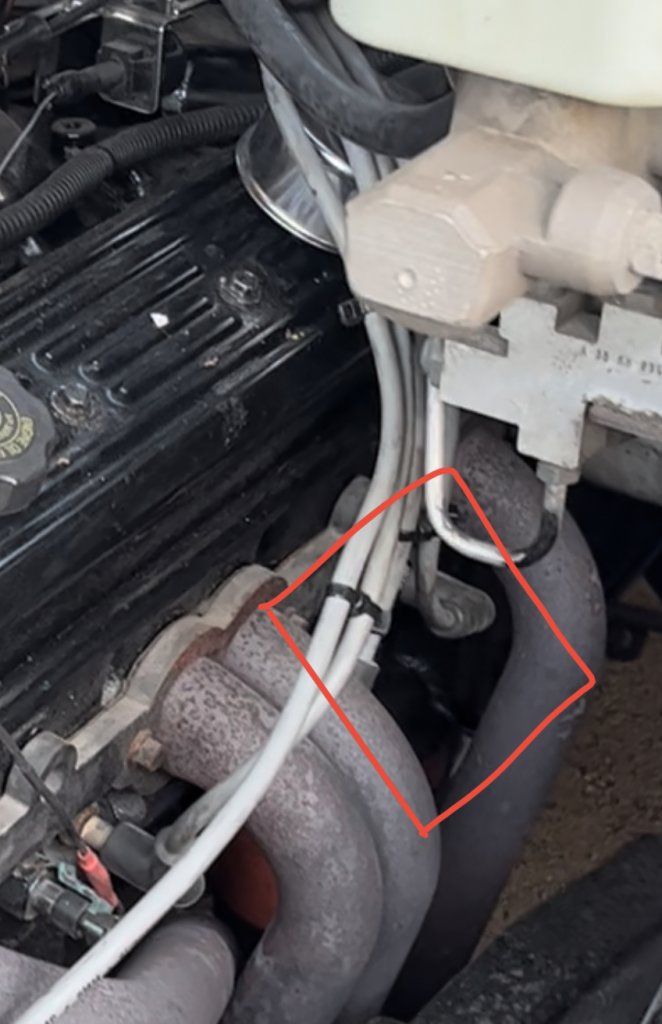

Hey guys, I have a 350 that I can’t stand to drive anymore. I have an excessive wave of burning oil come into the cab after every acceleration. Problem is, I am lost. I cannot find my leak. I’ve done valve cover gaskets, but it is still there. Bellhousing is clean, I suspected it might be dripping from the sender, that is not the case. I thought maybe it is blowing oil out the breather, that is not the case.
I even had a buddy video tape the engine while I two-footed it and put some load on the engine. I cannot find my leak.
What would cause an excessive amount of burning oil to fill the cab? I’ve had this same smell before, but because I had a valve cover split but it bellowed smoke from under the hood on that engine.
Side notes:
*No blue smoke in exhaust
*No smoke from under the hood while driving
*changing the valve cover gasket helped, but it was never perfect.
*Oil filter housing tends to be excessively greasy
*currently, edges of the valvecovers are not wet.
1st picture was with the new valve cover gasket. I degreased the engine completely down to where you could see the block paint.
2nd picture was yesterday, oil filter housing already has oil all over it and it’s only been 5 or 6 months.

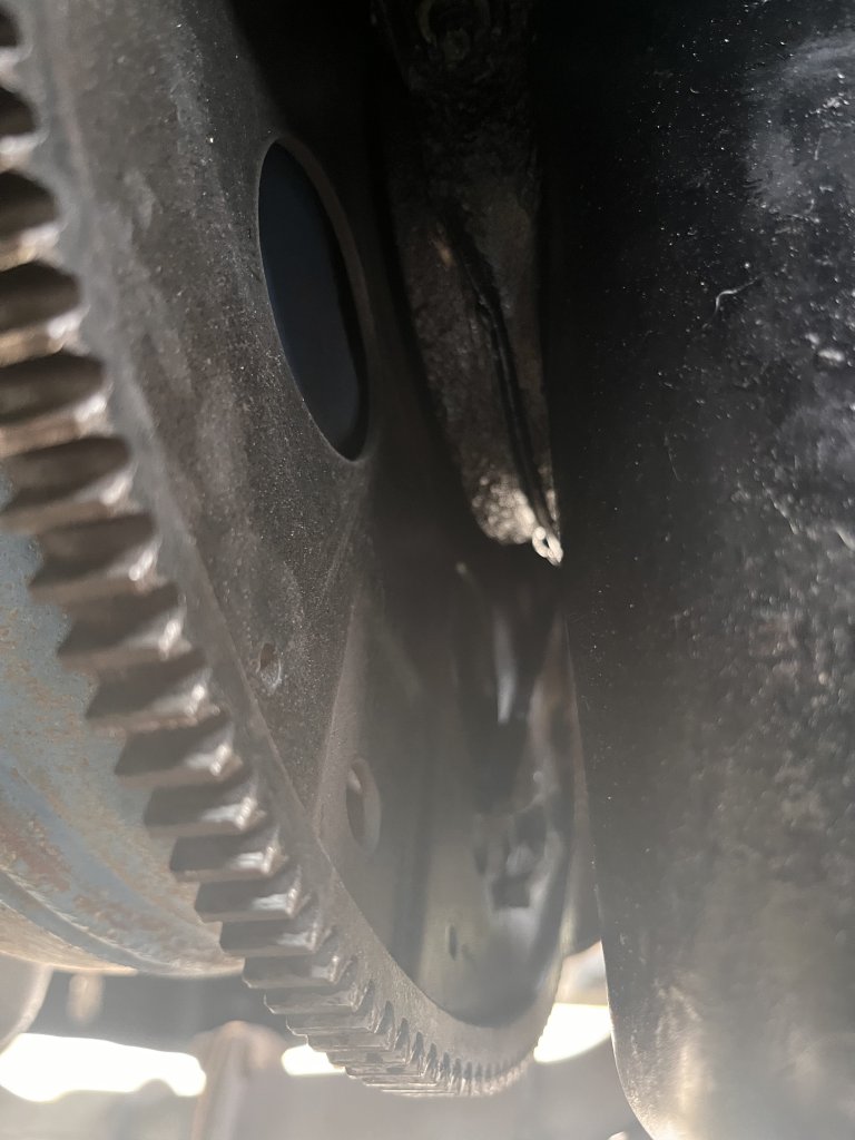

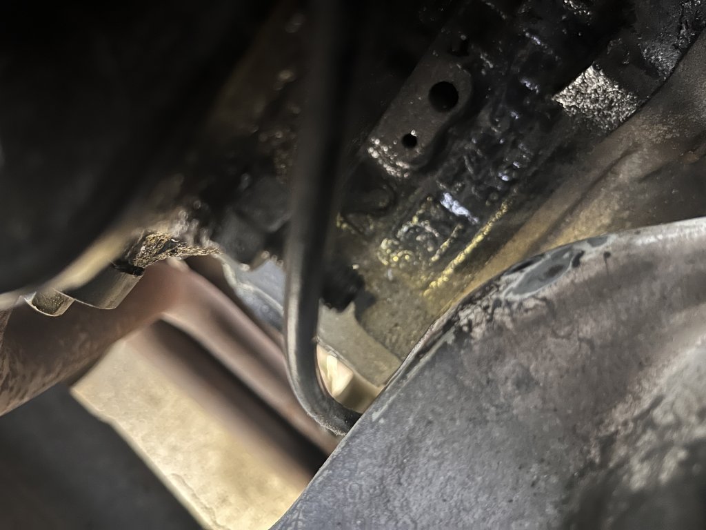

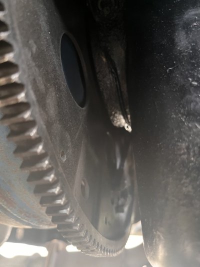

They are snug, I did not want to strip the bolts.
My rear main does seap a little, would that burn off the exhaust?
Here is a pic of the back of the block. It is dry. Rear main does seap a bit. Noticed that when I pulled the cover and did a starter.

Another bit, I tuned up the motor and let it idle maybe 30-40 min outside. I wrapped the motor up a hand full of times as I was tuning the carb. I did see a puddle of fresh oil afterwards on the drivers side. Maybe the size of a softball. My suspicion is that in idle, it doesn’t blow back onto the exhaust, under load going down the road it blows all over the header and exhaust. Just can’t pin point it.

If there's that much on the ground in that short time surely it is visible. You just need to really get in there. Above the oil filter, back and front of intake, pcv grommets, valve covers. Also it is likely to be blown backwards as well, due to the fan and while driving, front main and timing cover seals could be it. You have to clean very good then check for leaks.
