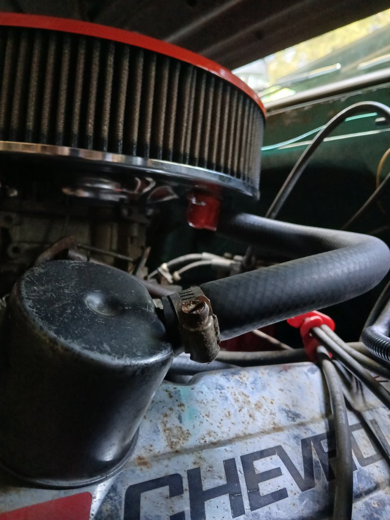

I just did away with the vent and plumbed this in recently.

Here's a better picture of what I did. Sorry for the confusion.
Ah I see, so it should be routed so that the PCV breather vents back into the carb intake to burn off/use up that oil vapor. I'll see what I can do to simulate that. But that's more of a long-term issue. For now, it's at least working.
This! Is correct.
The engine is made to burn those vapors.

Hate to be a party pooper but while you have solved one problem you've created another. Over time oil fumes from the engine are going to come out of your new breather cap.Oil will collect in the new breather cap and drip on your rocker arm cover and down to the exhaust manifold. Giving that nice clean engine bay a layer of engine oil.
The diagram has that rocker cover being vented to the air breather to recirculate the oil fumes.
When I got my square it had an air breather in the rocker cover. A pretty reddish Moroso one. Over time it started dripping oil. My engine bay was getting oily and smelling like oil more and more. I added the air breather vent hose, fuel pressure regulator and fuel canister and now the engine bay smells and looks a lot less like gassy and oily.
Before
After
