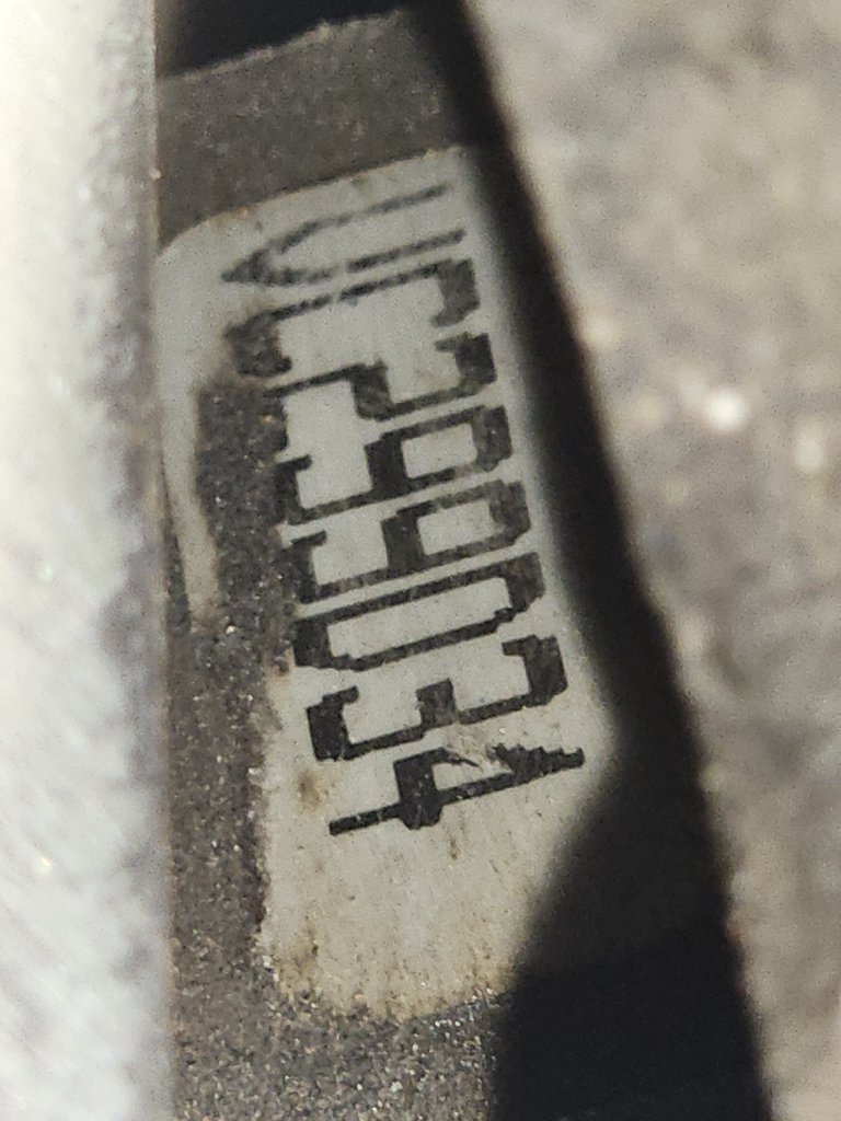

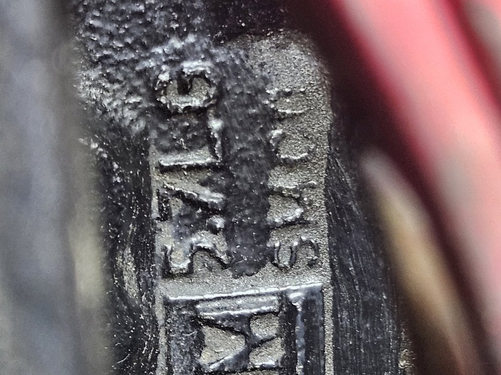

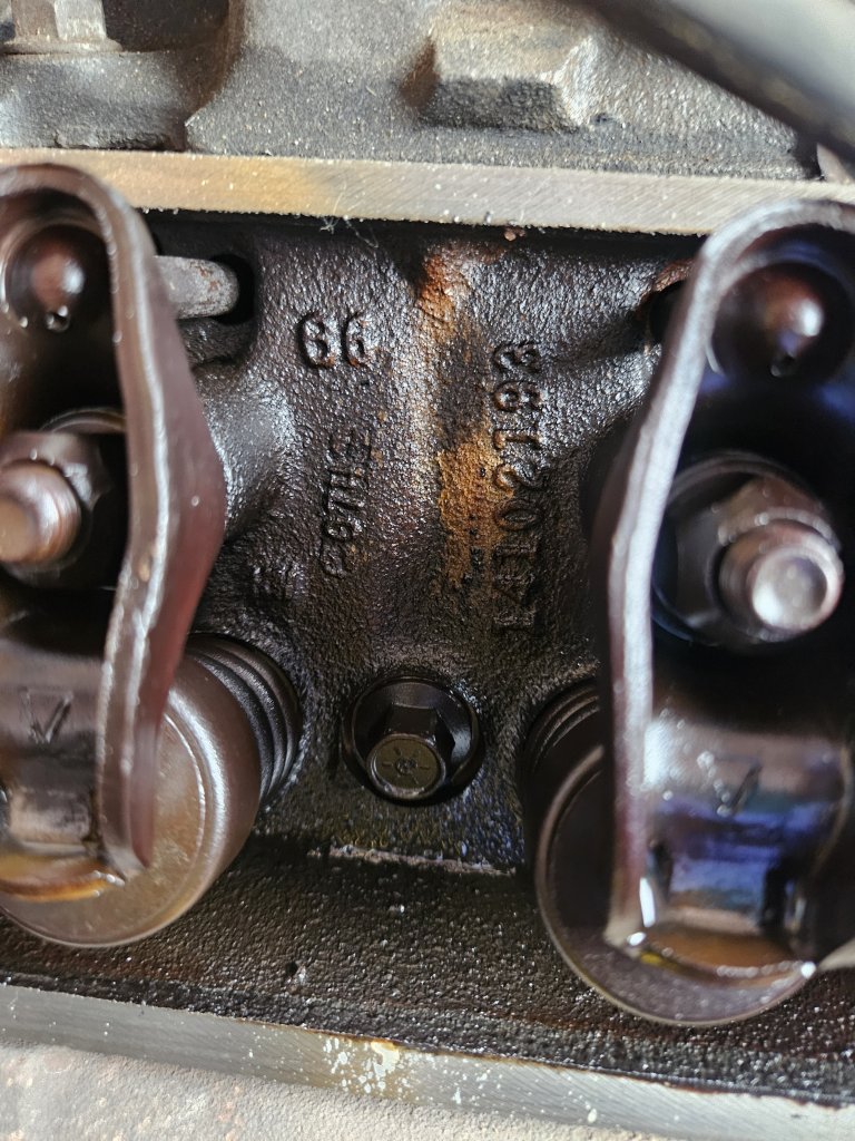

Here's what I was able to get. I'll try again today before the sun goes down

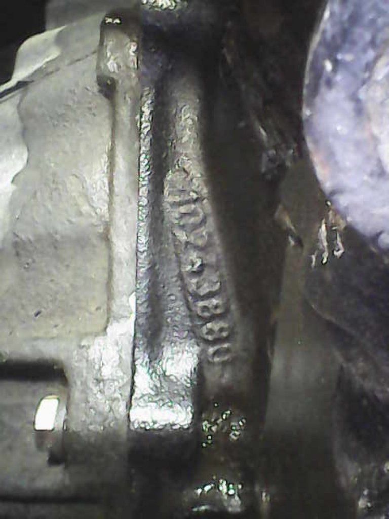

I got a better Pic of the stamp. A 10243880. This is certified Frankenstein.
