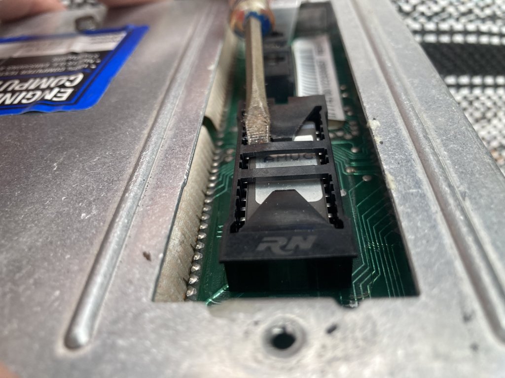

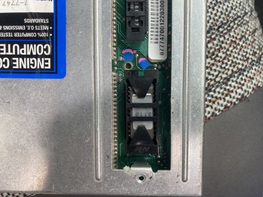

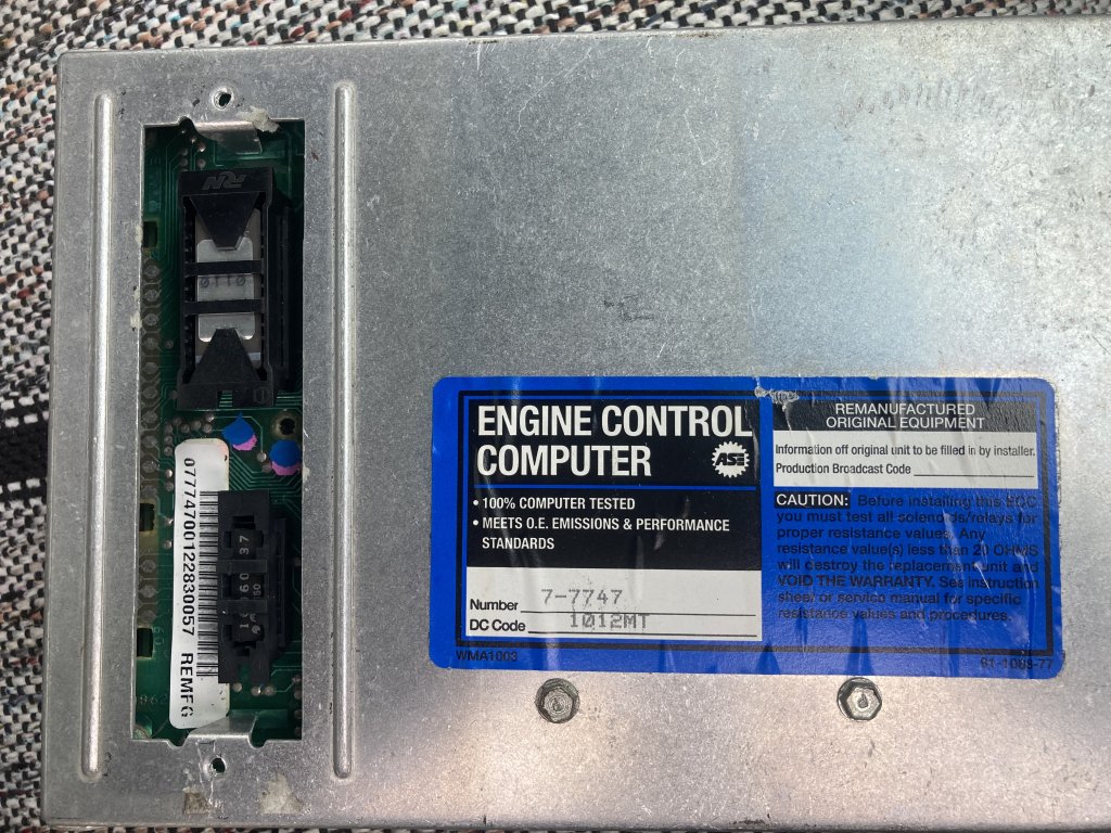

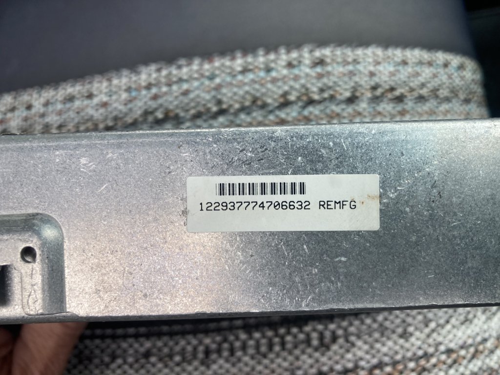

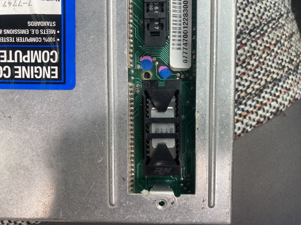

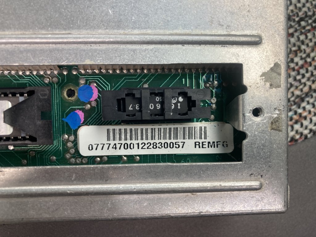

I'm hoping someone out there can help me determine if the PROM in my ECU is the correct one. The ECU looks to be a remanufactured GM unit and the large blue label has it listed as number 7-7747 and DC Code of 1012MT. There is another sticker on the side of the metal case where I see a sticker with the number 122937774706632 REMFG and after removing the little cover, I can see a peel and stick label has been applied to the board. It reads 07774700122830057 REMFG.
If this is the correct computer for my truck, and who knows what the previous owners have done to it, should it have a PROM that reads AMUC?
It's an 87 V10 305 TBI with a TH400 Transmission and a 3:42 gear in the back end. I use WinALDL to monitor things and I keep getting a rich flag and it won't pass emissions. I guess I'm hoping someone put the wrong PROM in it and that's the cause.

Here are a few photos.
