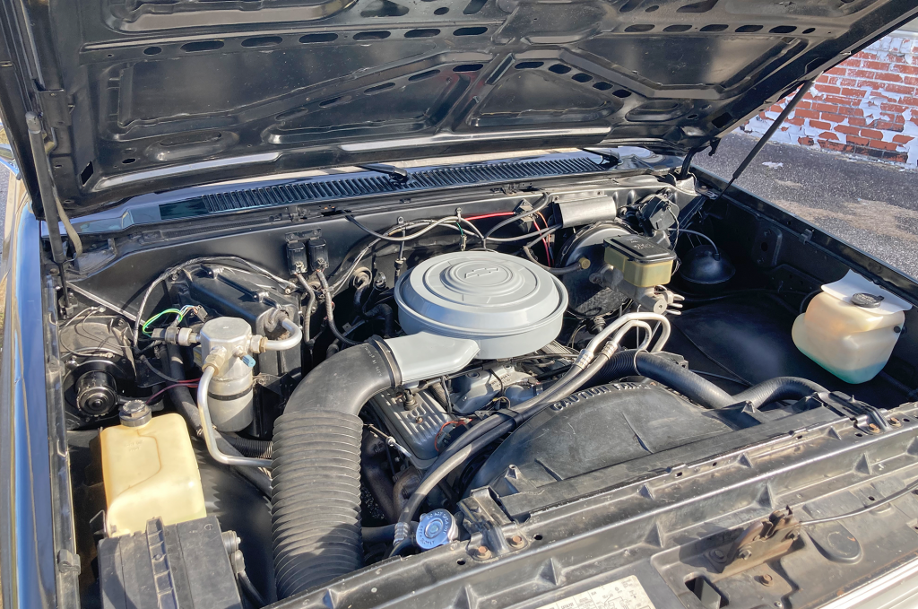

Resist the urge to bump the timing,TBI heads don't like lots of timing and it will just hurt your mpg. That's part of the swirl port design,get a really homogonized mixture that lights easy and light it off later. The result is more torque and MPG
Hmm... I'm 4º advanced on the L31 roller cammed-305 TBI I'm currently running, Rick.
I did a basic gasket/oil pump rebuild when I first got my R10 a few years ago.
While I was doing that, a buddy gave me his old L31 cam and told me to jab it in. So I grabbed the roller cam parts from the junkyard. Bought a set of new, proper-length push rods, and jabbed it in. He was adamant I advance it closer to 7º. But I decided to try 4º.
I'm pretty pleased with how it runs the last 2ish years I've had it on the road. (It's gotten 18mpg on long, flat 74mph highway trips.)
But I guess I could dial it back to 0º just to see if that helps.
