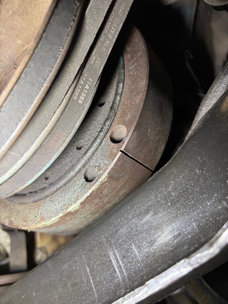

Here is a photo of the balancer. Compared to photos of other original balancers on the internet the mark seems to be correctly aligned with the inner holes...

It’s going to be hard if you can’t verify TDC. There are are at least two different timing pointers used on the SBC (12 o’clock and 2 o’clock), and the original pointer is tack welded to the timing cover. Someone may have swapped the timing cover or the balancer and now they don’t match.
I’ve never tried this, but several articles explain how to make a piston stop from an old spark plug. You break off the porcelain top and drill out the center. Then thread it inside for a long bolt. From there, you can screw the bolt in and out and it serves as a piston stop.
Another simple check is to set the idle very low, and watch the timing as you rev up the engine. It should go to its lowest point at about 500-600 rpm, and then add about 18-20 degrees as the rpm increases. It should max at about 3000 rpm. The mechanism inside the distributor may be stuck or the spring may be allowing it to advance too quickly.
Find top dead center. Mark the balancer.
Doesn't matter what timing tab, doesn't matter if the balancer has slipped. Top dead center, mark it, time it.
It's not rocket appliances. Precision is unnecessary.
That doesn't tell you anything. Need to lay 2 dampers on top of each other with key way aligned.
Yes the engine will run at 25 degrees although at reduced power and increased fuel use.
There are 2 advances vacuum which you checked and mechanical. To check mechanical see if the distributor advances with vacuum disconnected or remove the cap and try twisting the rotor. it should move free.
To get close can remove either #1 or #6 plug and insert a long small screwdriver, rotate engine by hand, bring piston to TDC.
A base total advance starting point should be in the area of 38-40 degrees. Adjust the base timing to achieve those numbers.
