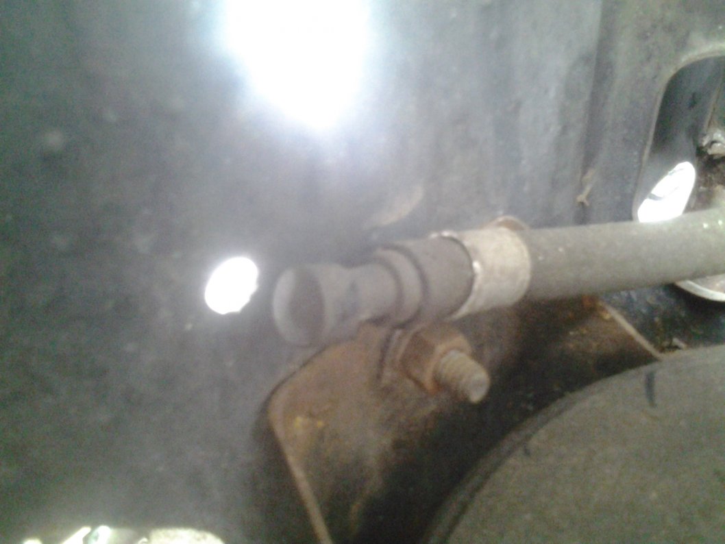

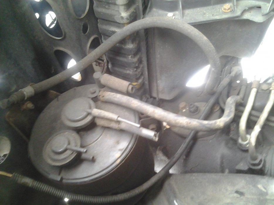

Ok i heard that pluggin the line might cause issues with adding gas to the fuel tank?
I got one line near the canister with a vented cap on it and the other line is still attached to canister can i just cut and cap that or do i have to vent that one also?
I attached some pics

That canister hasn't "collected" any vapors in a long time by the looks of it. The only hose still hooked up is the vent from the gas tank - everything else is open to atmosphere. So any vapor that does flow to the canister (by pressure within the tank) just dumps out through the cut off hoses.
That hose with the breather cap on the end is the vent for your front differential - leave it be. Matter of fact pop the breather and make sure it's actually "breathing".
You could break the seal on the canister top cap, shake out the charcoal and use it to store some small hand tools for emergency repairs. Or you could put some ice in there and chill down your beer.
Nah, the tank vent to the vapor canister is not at all involved in purging air during fueling. There is a dedicated vent line for fueling - it is a 1/2" line that runs parallel to the gas tank fill line and terminates just under the gas cap.

Ok thanks guys! Got it off today looks a lot better I was able to remove the hose from the steel line and just cap it there. Now to clean up the wiring under the hood that ought to be fun!
