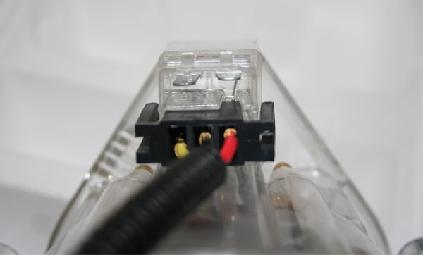

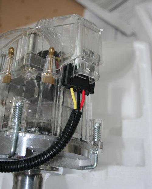

Okay, so I got the distributor a couple days ago and sat down to take a good look at it this morning..
It has a connector on the side, but I don't have the connector..
Anyone know where I can get one?
I could just use individual spade connectors, but doing so would leave me open to accidentally reversing them some time in the future, and who knows what kind of havoc that might wreak..
Here's a couple pictures to show what I am talking about...

I googled HEI distributor connectors and came up with a bunch....and a bunch overpriced. Summit had one for $10.
https://www.summitracing.com/parts/hfm-disthpl?seid=srese1&cm_mmc=pla-google-_-shopping-_-srese1-_-keep-it-clean-wiring&gclid=CLfahZmbwNICFVWewAodcSkH_Q
That's the wrong one.. That's the one that's already on the distributor and is wired to it's internals.. I need the other one that connects to the two tabs on the distributor to the electrical system of the truck... YOu can see them pretty clearly (no pun intended) in the second pic
Do you think that would be something that a NAPA auto parts would carry?

I used spade connectors when mine went bad. $15 is $15 bucks.
I would use spade lugs if I knew that getting them backwards would not harm the electronics of the dist...
I found them on eBay for 8 bucks, but I don't have enough money in my paypal account, and ebay screws things up when I try to use my credit card (The purchase fails and I get charged anyways, and good luck getting the money back while dealing with cust support that can barely speak english)
So, I'm probably going to have to spend the 15 bucks.. Way too much for what they are.. but it is what it is..
