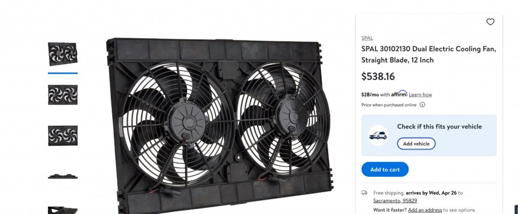

Definitely, I already upgraded my alternator to a powermaster which is 150 amps. And my charge wire is 2 gauge along with a 2 gauge ground. I was looking at SPAL fans but the problem is I don't see anyone making a fan shroud that would work with a stock radiator. and those spal fans dont come with a shroud.
I run the dual SPAL. The shroud is integral with the fans. Been using it for 15 years. They move a lot of air. Only brand I would consider. Same with Powermaster. Their stuff is top notch. You will know when they kick on. I discovered that adding a 1.5 farad capacitor to my stereo amps power source, it buffers everything in the electrical system including the fans. Accidental discovery but I'm surprised manufacturers don't incorporate them?
