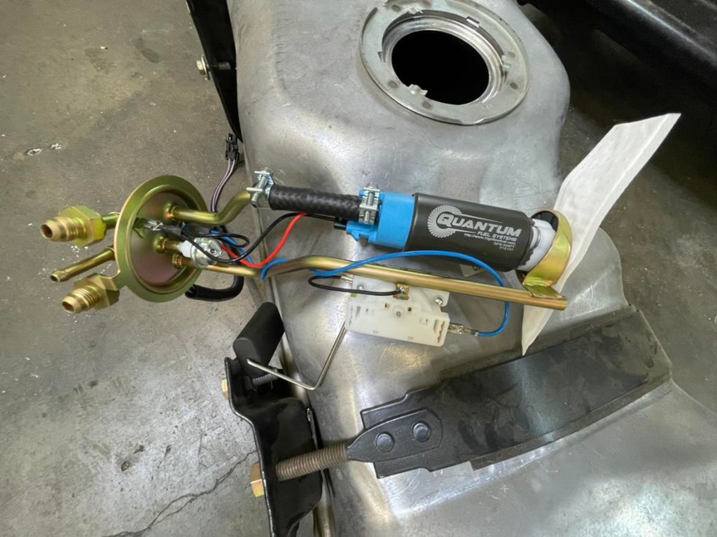

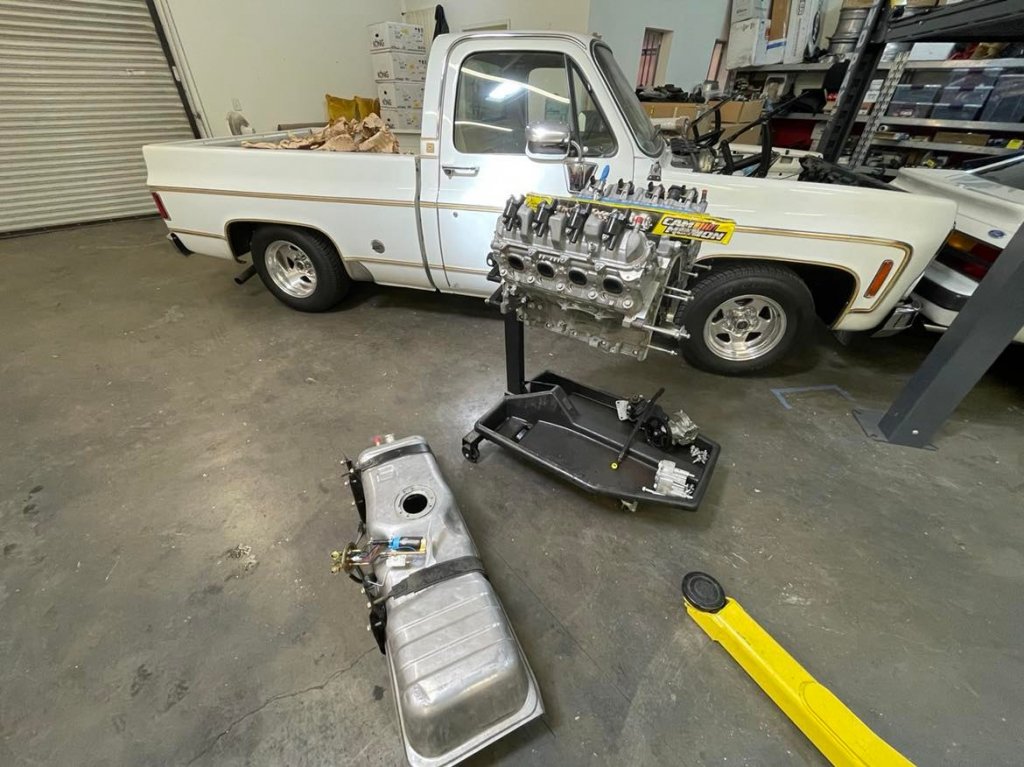

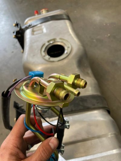

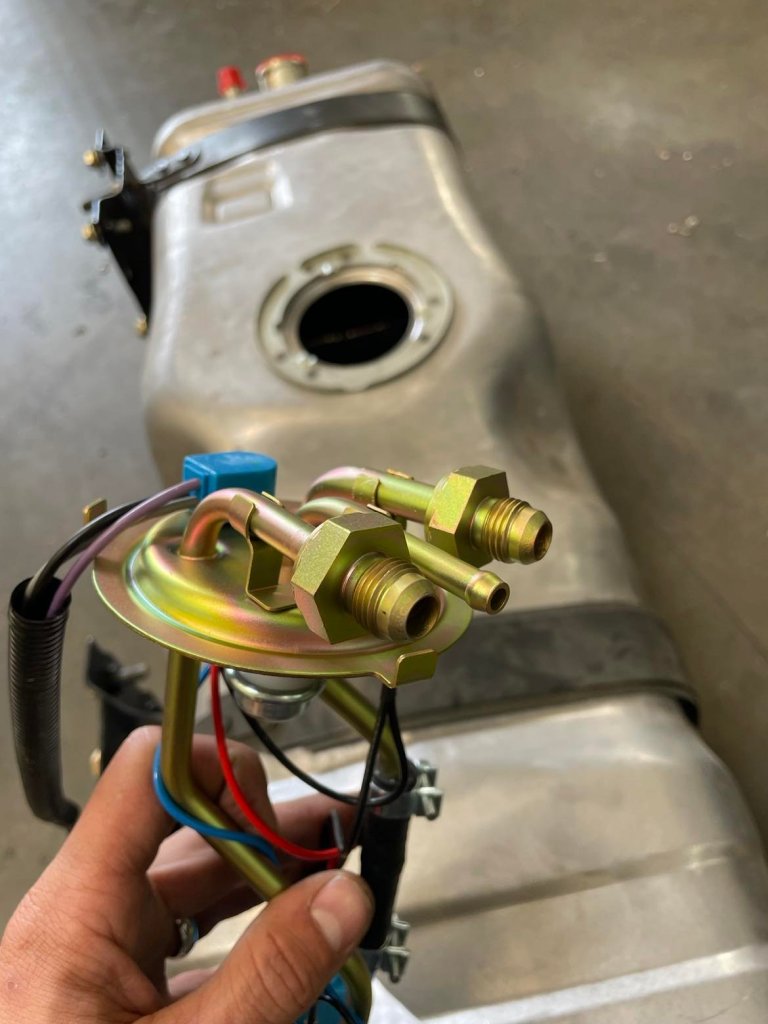

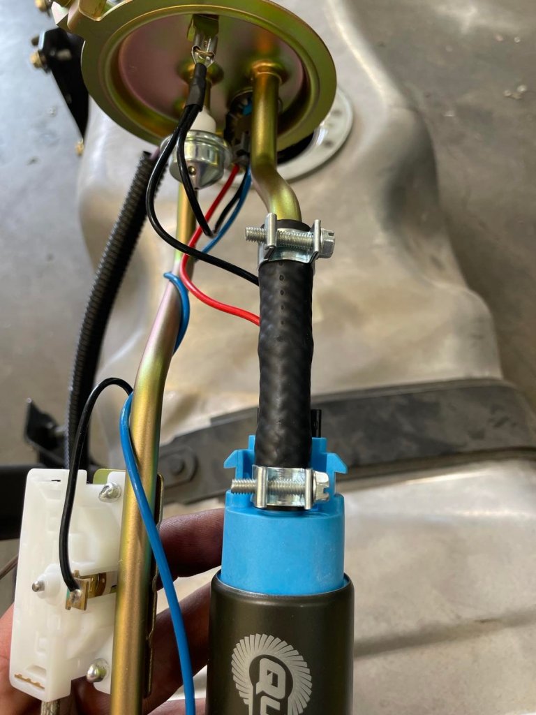

Came across this thread while researching LT swaps for my '77 C10. I previously did an LS3 swap but got the itch to do something different. Previously I was using a 87 hanger and tank and on the hanger I had compression fittings to convert them to AN. I was always weary about the compression fittings since they're on the top of the tank where I can't see them. I don't think they leaked but when I had the tank out for inspection during my L86 swap, I decided to install one of the Quantum drop-in hangers with AN fittings already on it. I'll be running n/a with E85 for the time being so their 340lph pump seemed perfect.
