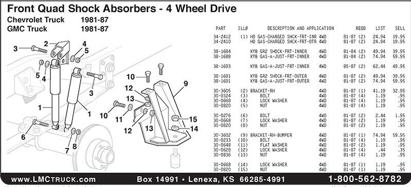

What exactly is needed for the dual shocks. Mine has the single shock in the front and would like the dual shock setup. Just for the looks really. Is there an aftermarker setup you can buy? Or something I would have to make?

What exactly is needed for the dual shocks. Mine has the single shock in the front and would like the dual shock setup. Just for the looks really. Is there an aftermarket setup you can buy? Or something I would have to make?
Looking at LMC's site, looks like the bottom of the shocks share the same mounting location, and the upper ends have separate mounts, note bracket #2 in the pic. I don't know if the frame is pre-drilled for that or not.

The holes are already in the frame, but LMC only carries the bracket for one side. It's best to find someone parting a truck with the quad shock option and get them to remove the brackets. Anyone handy with a cutting torch can easily remove them.

GM 1/2 & 3/4 ton 4wd 1969-1987 Front Dual 75170
http://www.tuffcountry.com/products/multiple-shock-kits.html
GM 1/2 ton 4wd 1973-1987 Rear Dual 75171 Dual Rear shocks.
Here is a full kit.
I'm actually thinking I don't like that kit to well with that adding of the tubing. I like the OEM to the frame brackets better. I can't see the advantage of that kit over the OEM, but I'm sure its better than a single if you don't have a choice to go OEM. I didn't even know GM did dual fronts OEM until I bought my truck. And one other member on here has duals too and it too was a GMC. I talked to a guy that works at an offroad shop and he said he was farily certain, that was only an option of GMC and not on Chevy. I say unlikely true, but maybe he's right. :shrug:

They were an option on the Chevy too, I've seen more than I can count. People always think that GMC's came with more stuff standard or more options were available, but it's just not true (until recent years). The only thing GMC's got extra were lock washers :crazy:
