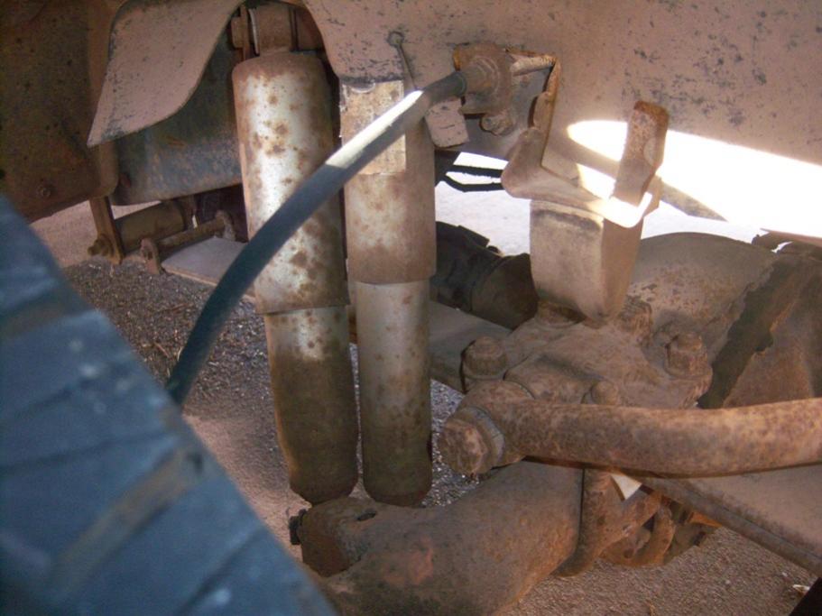

Yep my 85K1500 is OEM dual shocks. They need replaced but nonetheless they are there, and Retro has the right RPO code for them too.
