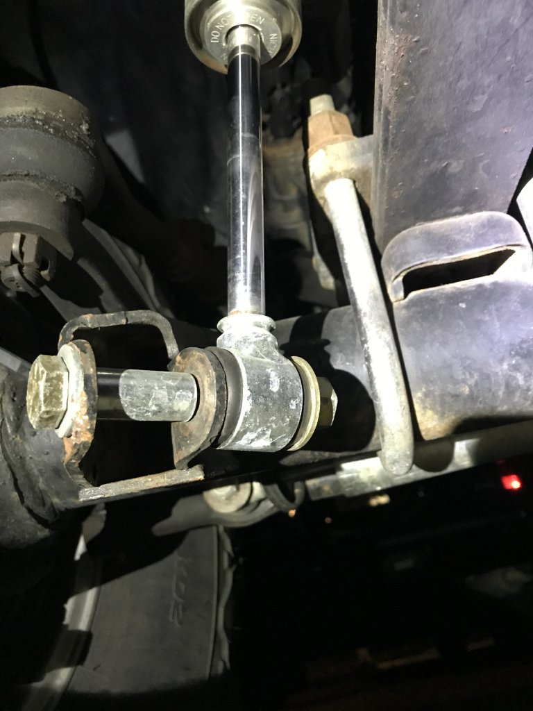

@lifeofbriank10,
In the last pic it looks like the upper rear bracket has been whacked on that one side. Were you still planning on using double shocks? If so and you plan on staightening that bracket out I would inspect it afterwards very very carefully for cracks on that one ear. Our old trucks don't like to have metal beaten back and forth without breaking off suddenly.

Starting on the rear and the bottom has way to much wiggle room as you can see. Am I supposed to put the washers on the inside?
nvrenuf
2,547
3,904
Mobile, Al.
1991
Yeah, you need to fill the gap. stock shocks may have a tad bit of the bolt sleeve sticking out on each side to take up that slack.
If you don't want to stack washers DIY4X.com sells "Heavy Washers" that are 1/4" thick that might look cleaner.
