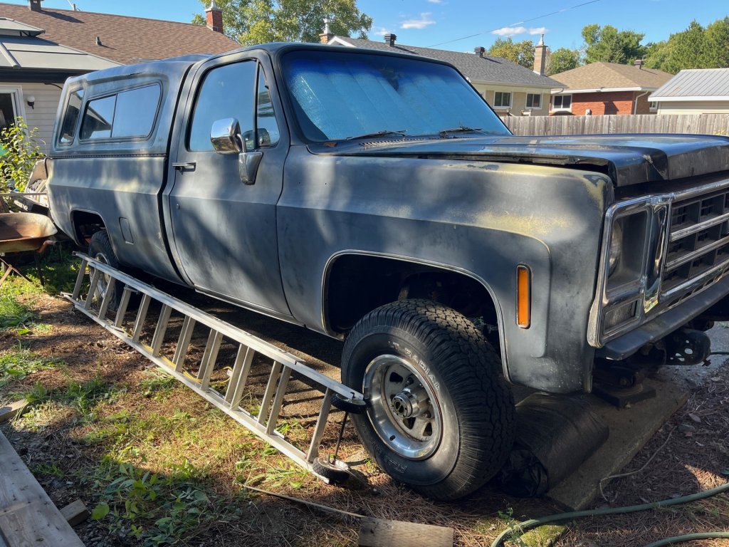

I recently aquired an 80 K10. The truck is pretty nicely restored to fully stock. I want to go with something like a Summit Alumarally or its vision counterpart in an 18x8 but I am unsure the wheels will fit. I am struggling to find out what I can run on this truck. It looks like the extra backspacing will interfere with the steering knuckle. Does anyone have experience and maybe some photos of a 17-18" wheel that will fit on the stock truck? New to this world so any help would be greatly appreciated.

I assume that’s a before pic. That beige primer could be from an old repaint. Our 86 had that primer under what was likely a single warranty type repaint early in its life. I did not like it. Too soft. Could peel even the old crusty top coat off in flakes or ribbons if heated up.
Get rid of it before painting.
