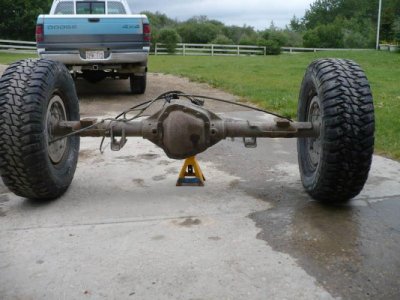

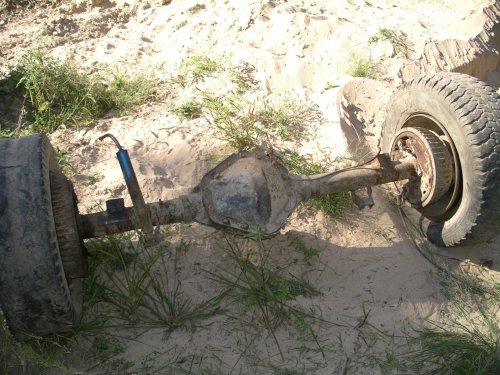

Google is your friend!
Dana 70...

GM 14-bolt full floater...
attachment.php

That Hollander book is using the number of diff cover bolts to identify the d70hd. 10 cover bolts is correct, however, this is careless on their part as this creates confusion with the more common 1/2 ton axle.
Drop the book and use the pics posted.

Its diffenant;y a 14 bolt
