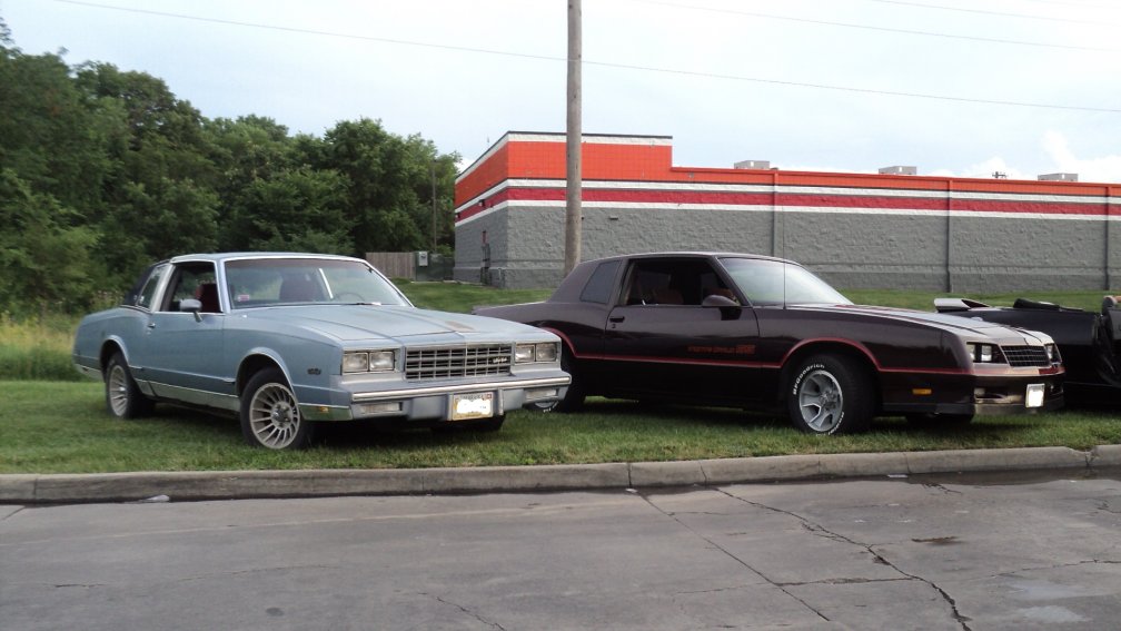

We had a little local carshow at the local Sonic tonight.
